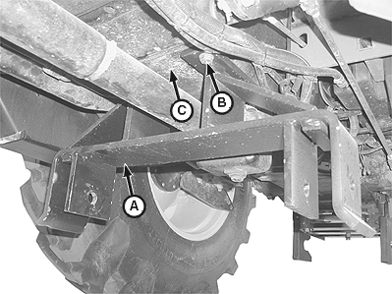

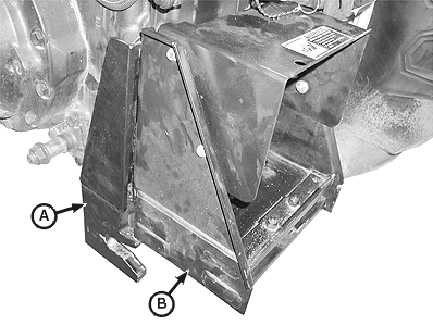

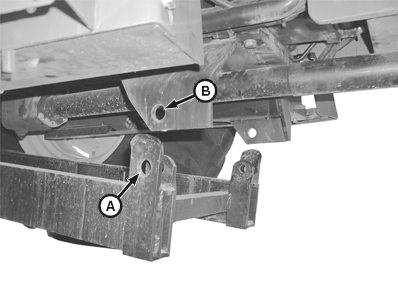

I Have a JD 5105 tractor, with a 512 Loader::: If you have better options than what I list below from JD, Please advise,
((( I am going to put a dual SCV , LVB25065- KIT, on the rear of this JD-5105. Then(to operate a JD 10A backhoe ), Power Beyond Kit - LVB25128 & Tee fitings: 38H5069, 38H5071, 38H1378, o-rings(5ea) T77857. These are the items I need for adding dual service plus power beyond to this tractor that has a mid mount service , joystick for loader,already in place. Acording to the online JD manual, it can be done. JD dealer confirmed. Please advise me if you may come across any of these items in the near future. )))) I would like to get moving on the hyd mods that need to be done.But want to do it with the best knowledge, so looking for sugestions.
Also, The JD dealer confirmed I can mount a 10A JD backhoe, so that is now in the yard and will be working on the mounts to make fit. I have the basic 5000 series hangers, front hanger being the v shaped plate, however the 48 backhoe has a specific hanger for the 5105 & 5205, much larger straps v shape . looking what info i can find to help me here. The two holes in the front line up, the two in the back, 3/4"off, can plug/weld and redrill.
The rear hanger will bolt up and work but its structure design is a liltle different then what the exact application under again the 48 backhoe. And think what i have for the rear would be stronger. I have the cast hitch plate.
ANY , advice on anything I have mentioned here reguarding the hyd pluming ,(which i have not purchased the kits to install yet), And any suggestions as to anything with this set up , please tell me, would rather avoid a problem now than latter.

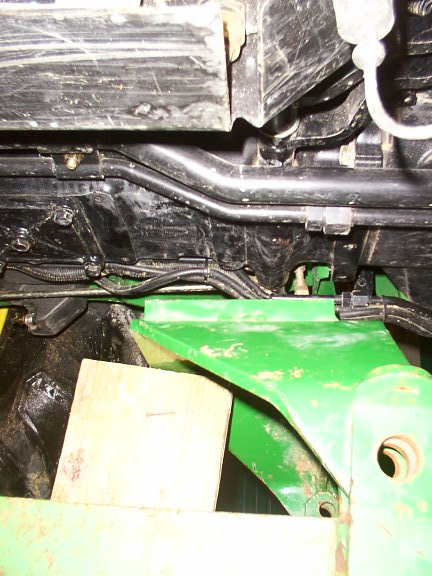

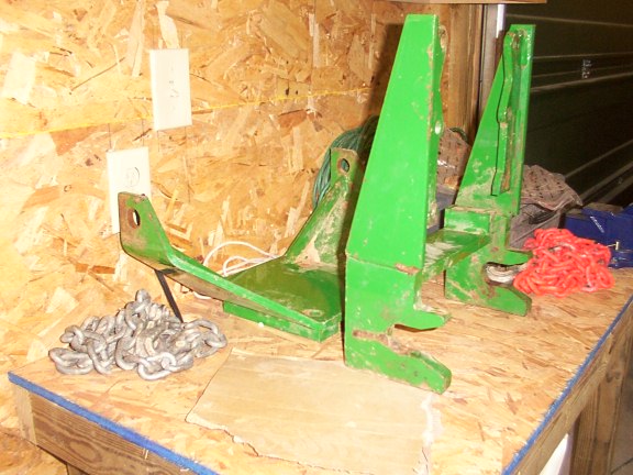

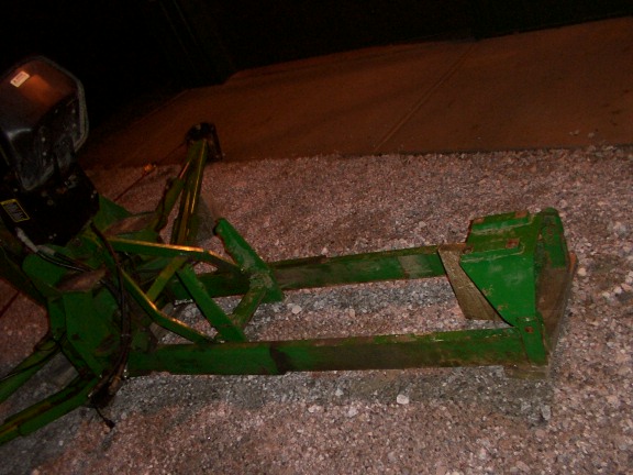

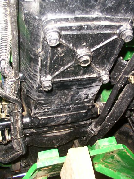

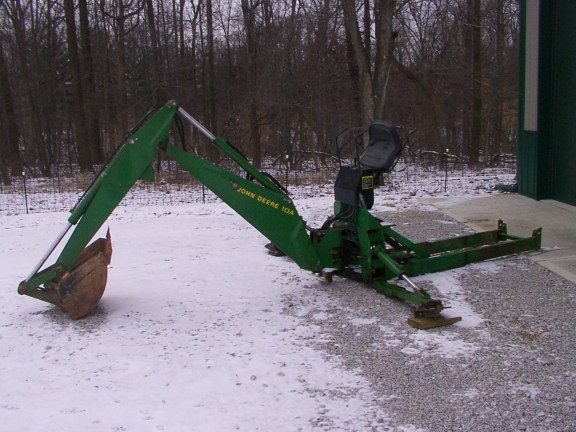

Attached photos of the exact backhoe, front hanger , and rear hanger, that I have to work with.
   / 5105 tractor & 10 A Backhoe , Hydraulic pluming , mounts.
Having Trouble with exactly which attach points to use? The 4 points to the back OR the 4 points to the front, 6 points total in the picture I attached. This is going to take some modifications. Anyone have suggestions? Do I need to use a different hanger all together to best support this backhoe??

OK, Got tired of searching and waiting, Went to JD and bought every added hyd service option I could including the 3-point center hyd ram and aditional hyd ram for rear implements. All kits and such i listed to do this as stated ....$4300.00 to upgrade this tractor. Waiting on kits to come in, then will install myself after that $$$$.
Still having questions with the subframe mounts / hangers for this backhoe.??? Anyone???
