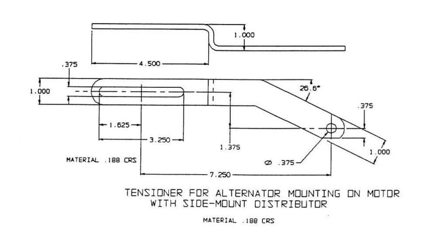

I'm considering making a video about this and how I rectified it. I bought my tractor with the 12 volt conversion already done. I took a quick look, and at first glance, it seemed ok. The wiring has been patched and cut back a lot, but that's nothing I can't repair. The tractor was running like a champ until this past Thursday. I went to start it up, to move it, and the battery was flat. Charged it up, it popped right off and purred. I noticed the brand new ammeter was at zero. I bumped the throttle up, nothing. Bumped it all the way up to max rpm, still nothing. I yanked the alternator off. I took it across town to a fellow I know that does auto and equipment electrical work. He checked the alternator and it wasn't a true one wire alternator. The PO had put on a three wire and plugged off the place where the two wire connector goes on the side. One of those wires is the field wire to start the alternator charging. Bruce popped in a true one wire regulator and tested it. Bingo! 14.7 volts. He tested it three times to be sure. When I got back home, I looked at the tractor better. The PO pulled off all the generator brackets. He hacked to together and welded up a knock off of one of the popular 12V conversion kit brackets. He made it out of steel that is thinner than the conversion brackets. I noticed the alternator seemed to vibrate and move way more than it should. Once I started reassembling the alternator, I noticed the alternator groove was about a quarter inch ahead of the engine fan pulley and crankshaft pulley. Not only did he design the brackets out weak materials, he installed the alternator on the wrong side of the brackets. To compensate he used a belt that is slightly thinner than a half inch. The belt tracks almost straight with a little deflection at the alternator. It works but it's scary how much that belt dances and how much the alternator wiggles around. My electrical system is shot and has been cut back so much that I think I'm just going to replace everything, wiring wise. My idea is to make a few videos about correcting the 12 volt alternator conversion, rewiring the tractor, correcting some ignition issues, and adding head lights/tail lights. I will be driving this tractor on the road at times and it may make a few parade appearances.

If you want to replace the bracket, you can use this:
Thanks. I'm going to try and adjust the brackets that the PO made and get the proper 5/8 inch thick belt. If everything runs true, I think it may work. If not, I'm going to buy the brackets sold for the conversion kits. All of the original generator brackets have been removed. The brackets I originally wanted mounted to the original generator brackets and are very strong compared to what I have.

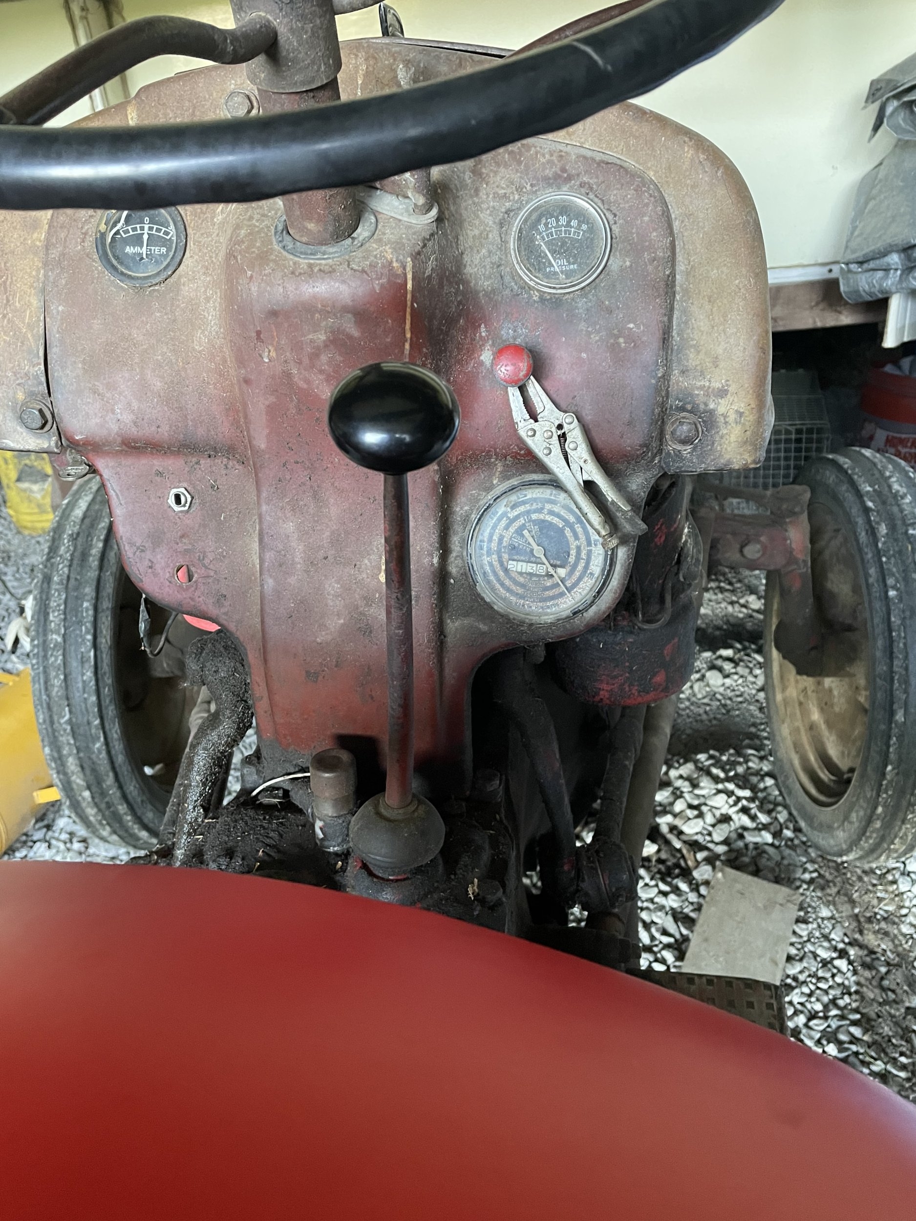

The engine is so tight on my 2300 hour 1951 8n, that it starts very good on an 18 year old 6 volt battery, that I can only charge up to 5 volts.
When and if that old 6 volt battery no longer cranks it over, I am going to get a new 8 volt battery, and hope for the best.
The hanging needle-nose vise grip holds the choke closed slightly. It has always ran better like that, since I put a new aftermarket carburetor on it, about 20 years ago.
