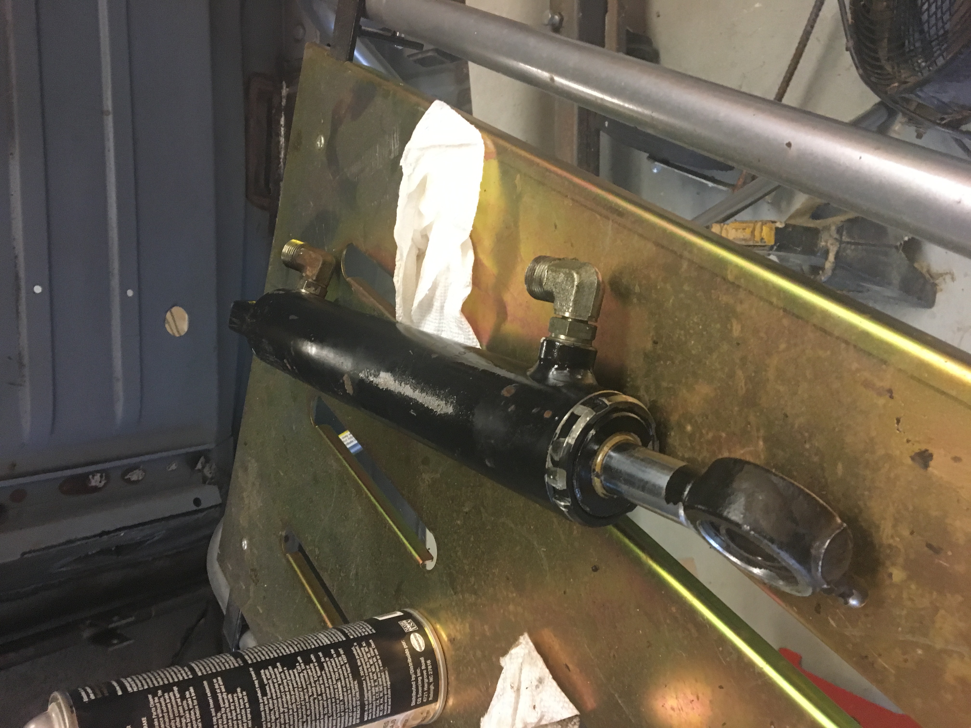

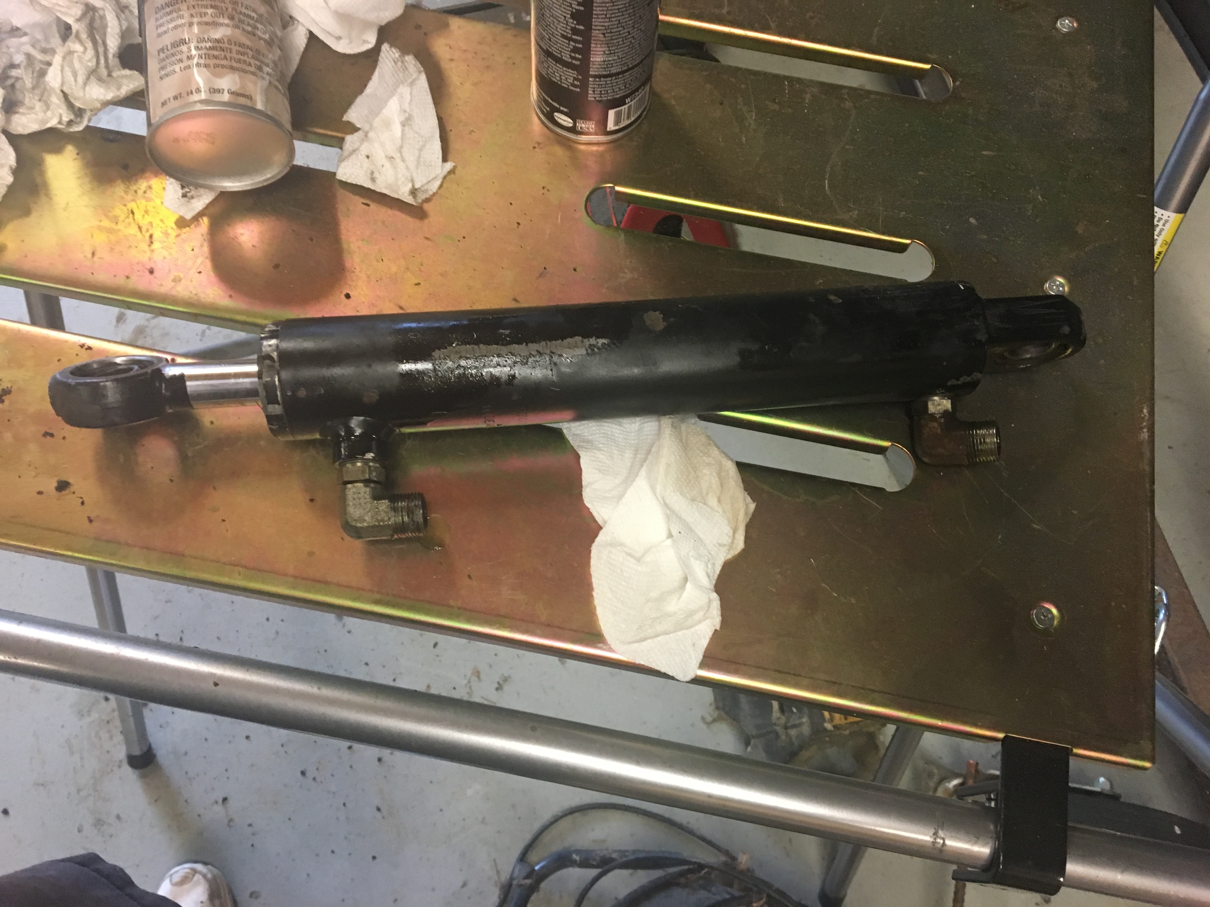

Went to JD and got a seal kit for the steering cylinder on my 2 wheel drive 5205.
Now I have no idea how to actually take it apart. Looks like a lock ring behind the big nut holds it all together? Is there a special tool to get to it?
   / 5205 JD Steering Cylinder #2
it looks like you need a hook(probably) or pin spanner to remove that large nut, don't use a pipe wrench vise grips etc.. I don't see indents for a gland nut, so, it should be easy.. HYDRAULIC REPAIR TOOLS - Home
   / 5205 JD Steering Cylinder #3
The attachment was taken from JD TM1792 hopefully it is what you need.
  • steering cylinder.pdf
Got the large nut off with no problem. The snap ring is way in there, can't seem to get to it.
Mine is on a 2001 5205 and is a little different. those instructions say to push in on the piston "D" to expose the snap ring. Can't do that on mine. I guess I just need a different set of snap wring pliers, mine will not fit in the gap to reach it.
Yes! thanks! that is the diagram i was looking for. The snap ring is what I don't have the right snap ring tool to get to it. I am going to try one more time before I head to the JD dealer.
Okay, I was not responding to "push" so I soaked it in PB Blaster for a few hours, then hit it with the impact hammer and it broke loose! That was the problem. New seals in and no leaks!
