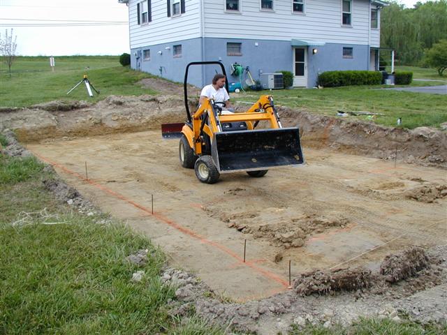

Snowman, I have a 5252 with a MMM and FEL. The loader is very strong and easy to put on/off. The MMM is a pain to put on and off. I use the loader to lift the front of the tractor to more easily take the mower on and off. The loader lifts like 600pds and can do some decent excavation considering the bucket doesn't have teeth etc. Put something heavy like a tiller on the 3pt for counterweight and traction or you'll be front heavy. No problem using the loader w/o 4wd. Traction was fine. The main benefit of 4wd I could see would be the ability for the front wheels to "climb" over larger dirt clumps etc with a full bucket. MMM provides a good cut but the only adjustment for height is to adjust the height of the caster wheels. In hindsight I would definitely go with a 3pt finish mower. Anyway, I think its a great little tractor.

My 5252 when digging our pool.
