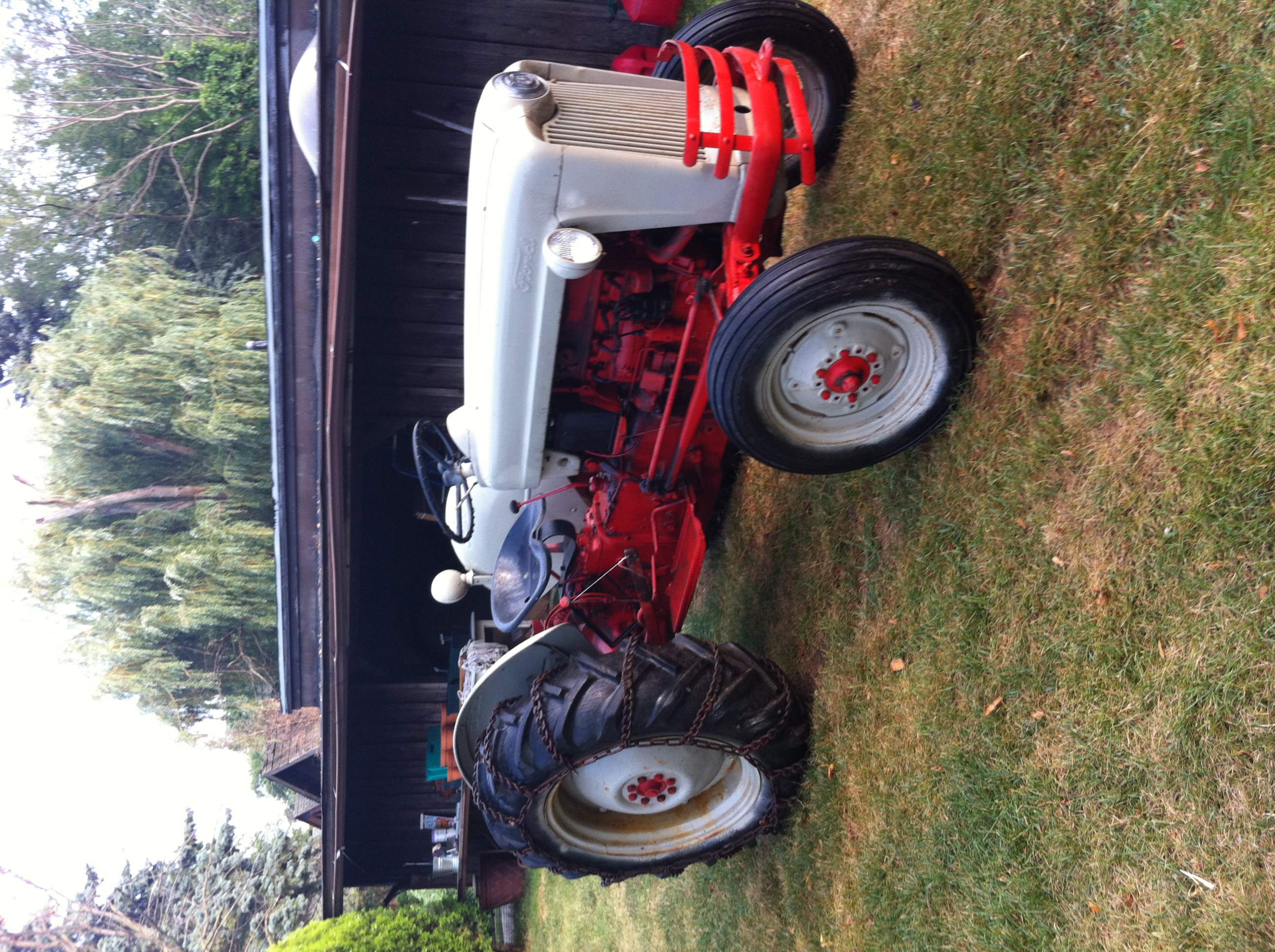

Just Joined today because pulled my dads 53 jubilee out of the barn yesterday.... hasnt ran in 10 years plus.I was hoping someone would have plan of attack on the first steps of getting it running . other then clening it already did that. When it was parked it ran fine.

Plan of attack? Check oil level or maybe drain it if it is hot up there and put in some fresh oil. Drain gas tank. Add a fresh gallon of gas and try to start it. Well probably a fresh or borrowed battery. Is that a 6 or 12 volt tractor, or has it been converted up to 12 volts? Some cars have the oil pump driven by the distributor. You can install a priming rod to operate the oil pump with a slow running electric drill. No idea if that engine has the pre-prime option. Some might suggest a short squirt of oil in every cylinder and turn the engine by hand with no spark plugs just to make sure nothing is bound up. Check transmission oil level and maybe plan to change it when you get the tractor running. Our high school had a Golden Jubilee that we used for snow plowing and mowing. Sometimes doughnuts in the parking lot in the winter.

pull the spark plugs.. put in neutral.. block clutch.. see if it will roll over by hand.
if not seized.. put some atf fluid in each cyl.
clean or repalce plugs.. champion h10 or h12 ( 512 ).. or al 437 plugs fine.
.025 gap on plugs
clean and regap points ( .025 as well )
roll engine over a bit and add more atf.
get a battery.. same as the old one.. clean up bat terminals and grounds. mae sure you install same polarity.
check coolant and engine oil and rans oil and rear end oil.
once you get it started.. I'd dran and flush all ols and change.
i like a 15w40 oil in the crankcase..and for the trans and diffy.. you can use a 80w90 oil, or UTF.. and for hte hyds, UTF.
grease all fittings.. oil dizzy oiler same with generator if it has one..
service the oil bath air cleaner.
lube the steering box after assessing thrust and sector play.
fo-19 service manual and a master parts catalog is a good 40$ investment.
