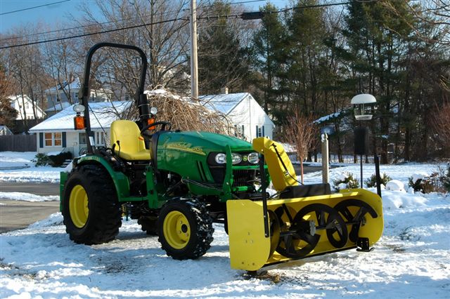

   / 54" Snow Blower N Brush Guard #2
Here's my setup: 2520, brush guard and 54" snowblower. All are standard, no modifications or customizations.

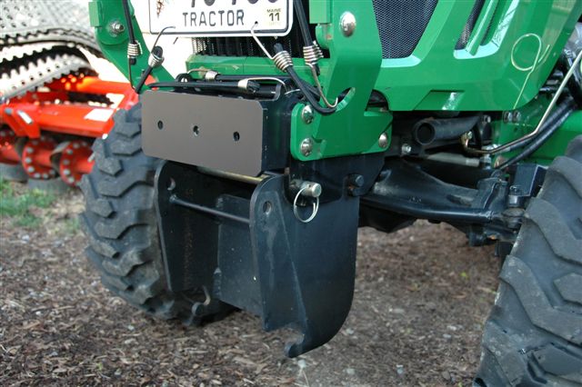

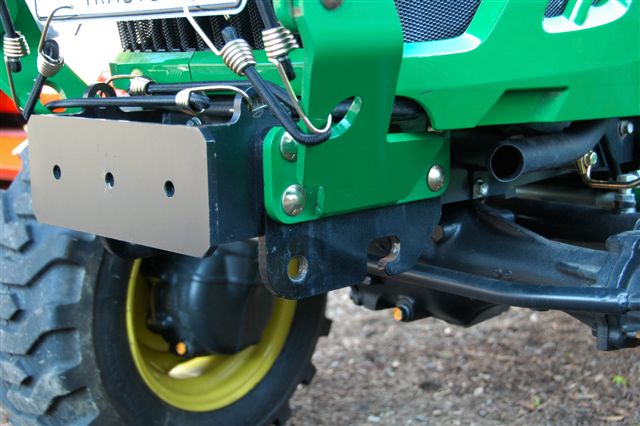

   / 54" Snow Blower N Brush Guard #4
Hope these photos help - the quick attach mounting plate is sandwiched between the frame and the brush guard:
   / 54" Snow Blower N Brush Guard #5
There may be some clearance issues when lifting the front implement but it should be able to be installed without removing the Brush Guard. That was the case on my former 4100.
JD recommends that on the 3x20 series and the only issue is that the bottom cross strap impedes implements on the Front 3 PT hitch. But the implements are fully operational and I can lift them up pretty high.

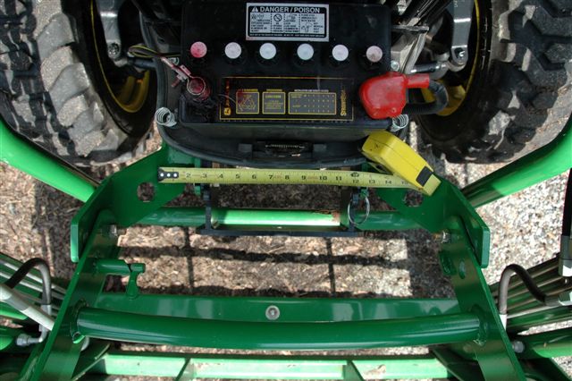

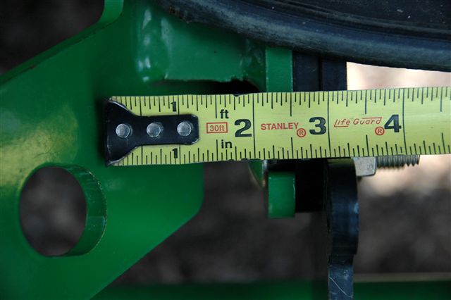

I took a look at your posted pic, thinking that my messurments were off, took apart the grill guard, put it back on with the brackets, and if you look closely you can see the gaps at the ends, something changed in the design somewhere along the line, i took a few messurements, so i could compare them to yours, i have one of the earlier tractors, made in fall of 06'. the o.d. size of the tractor frame is 9 1/8, the size with the grill guard and snowblower bracket o.d. is 10 3/4, 19 3/4 with the grill guard mounted with out the snowblower bracket. i'll take some pics also
Here are some pics, to get a closer idea. they changed something
