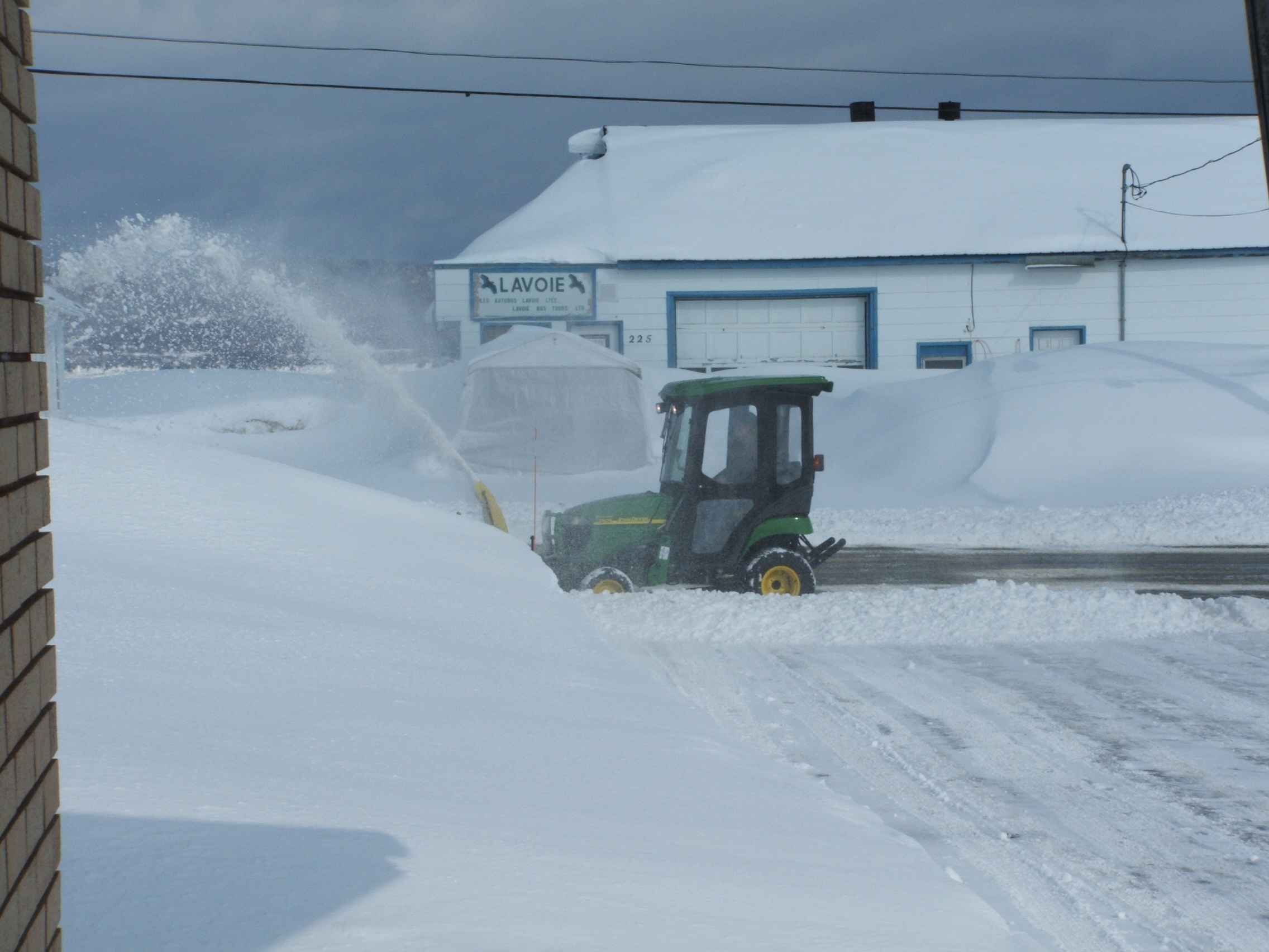

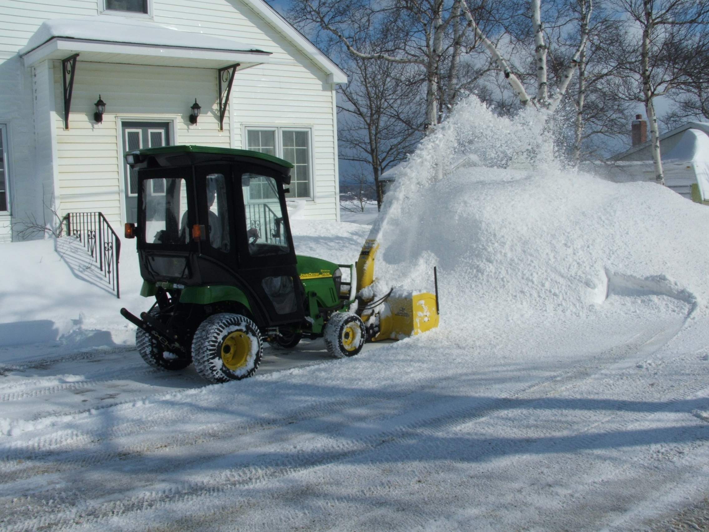

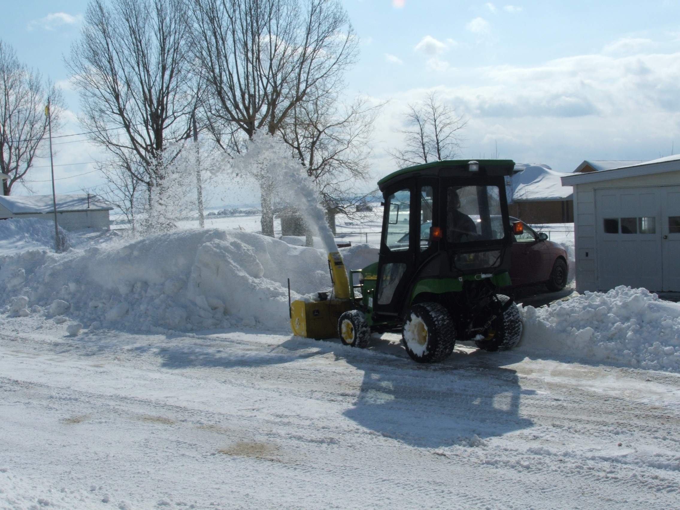

I've had my blower for the last 3 winters and never had the need to use my fel. I find the fel is some-out slow for snow removal unless you have a blade attache to it.
