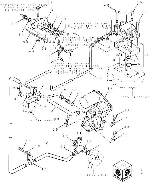

   / 545D 3-pt and Remotes #5
Two top plates? The manifold sandwiches between the top cover and the factory hydraulic cover plate, so yes if that's what you mean.
Just another look, the 545D and the 4630 are basically the same. Here is the same block (#3) from Ford New Holland, used to add a second pump for loader operation. ForumRunner_20140530_070819.png The top plate in the picture is different and a priority valve is added to combine the flows of two pumps, with the second pump added as part of the kit, but the adapter plate is serving the same purpose of using oil from the rear axle pump to be used for external means.
