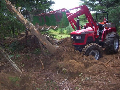

I have a 6500 4wd. I routinely "pluck" trees up to 8"+- up and out with little effort.
Larger trees depend on conditions. Type of root system, location, and, the big one is traction. Even on trees 14" 18" in dia., I can usually dig a very little, push over, and dig/lift and push, (traction!) at the same time, in a very few minutes. Of course there are exceptions, and limitations.
I spent about 2 hours trying to dig/push over a 24" Beech. This is when I learned that it is a good thing to have room around to dig and push. There were too many other trees that this one was leaning against, and I could only dig on two sides.
Digging stumps on cut trees can be done, but on larger ones it is hard and time consuming. After spending two hrs. on a stump a few times I will now either work aroung it or leave it for a backhoe.
It is essential to have some overhead protection. I built a canopy, skidplate and other tractor protection. Even a small tree when falling on your head can cause some hurt, and larger and dead trees can cause major damage to the body.
I would like to have a backhoe at times. If I did, I would still "pluck" trees out with the loader, and use the hoe for the problems.
It seems like that is all I am doing lately with the tractor. Building woods roads for myself, and clearing house lot and long driveway for my son. Anymore, when I can just cut a tree down and haul it off, it seems easy.
Hope this helps some. Would be glad to help more if I can.
