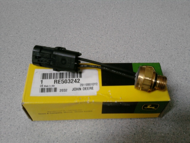

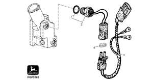

Maybe the problem is the thermistor sensor (thermistors are temperature variable resistors used as sensors.). On the thermostat housing there is a sensor that is connected to a two wire harness that goes to the injection pump; this is the "cold start advance" portion of the system so it starts easier when cold by advancing the timing.
Try unplugging it, replace fuse and see if it starts and runs. The part # is RE503242, if you are quick changing it, you don't have to drain the coolant, just make sure it's not hot at the time. You will want a pan under the tractor to catch the coolant, so as not too have to clean it up.
The worst that will happen is you blow another fuse.

Thanks for the info. I disconnected the thermistor sensor and replaced the fuse and it works fine with the sensor disconnected. Much appreciate the help, saved me a lot of head scratching and having to call the dealer.
