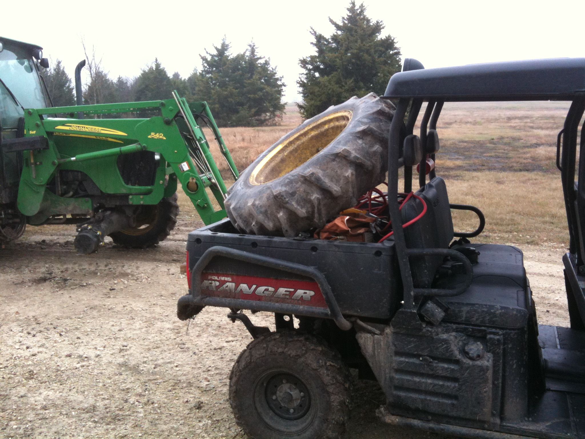

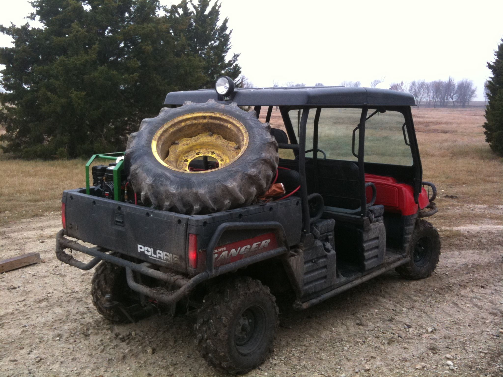

Nice pics, what was it a puncture? or just came off the rim due to the weight and not enough pressure?
What's in your loaders cross tube? in the first pic I thought it was a gopher peering out :)
JD stores the brackets for supporting the loader when you take it off. Easy storage - but I have never used them. I should convert that to a toolbox or something. :)

I had to call our local tire man to come put the same exact size tire back on the front rim of our 5420. I tried to move too much dirt in the bucket with the tire only having about 10 psi. Anyway, it came off both beads and I wasn't going to try the starting fluid ether method on a like new tire. Yes, I'm scared of blowing up tires...
Now, I make sure I have at least 25 psi in the fronts for heavy FEL use.
Also - it was a leak It was flat when I got in, but I didn't do my usual walk around - bit me.
D.
