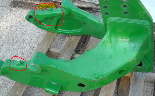

I put my H260 Loader on my other tractor that had a 563 Loader on it & it works great.
The H260 is a Good bit stronger but also heavier than the 563.
My research shows 553 562 563 673 H240 H260 H310 H340 & H480 Loaders all fitting the same tractor brackets.
True Not all Tractors will be heavy enough to handle listed Loaders & hose lengths may not work, but they should fit the brackets.

The H260 Lower Brackets Angles UP :
The 563 Lower Brackets are Level :
Both upper loader mounting connections are in same location though.

Has it been tested that 673 loader mounts will also fit a john deere H310? On the picture it shows the 673 mounts have what looks like a locking groove and the newer mounts do not have this?
   / 553 562 563 673 H240 H260 H310 H340 H480 Loaders fits same JD mounting brackets
#9
I had a 553/563 loader & it fit my H240/H260 brackets fine.
I’m pretty sure the 673 is the same as 553/563.
My friend Sold his H310 loader because it was too long & heavy for his tractor.
His H260 fit perfectly :thumbsup:
The tab circled in you pic is only a guide for the lower pin when installing the loader.
