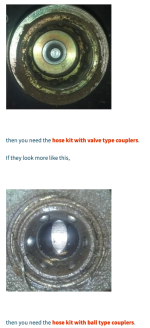

1) It's being shipped and I won't get it until later this week, but I am trying to order a hydraulic toplink for it so I can get it on right away. I got the dimensions from some older posts, but I don't know what style the hydraulic couplers are. Would anyone be able to tell me if they are 'ball type' couplers or 'valve type' couplers? (Photo below) Screen Shot 2020-02-01 at 7.49.06 PM.png

1) It's being shipped and I won't get it until later this week, but I am trying to order a hydraulic toplink for it so I can get it on right away. I got the dimensions from some older posts, but I don't know what style the hydraulic couplers are. Would anyone be able to tell me if they are 'ball type' couplers or 'valve type' couplers? ------------
Part number for the female coupler is 7001918. You might find the size and style on other websites. Bobcat Genuine Parts Catalog – Official Bobcat Company site

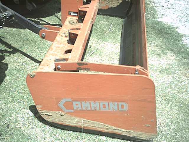

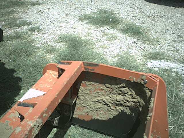

I put the box blade on the front if I need float and angle change:

The one on the front is a 6 ft.

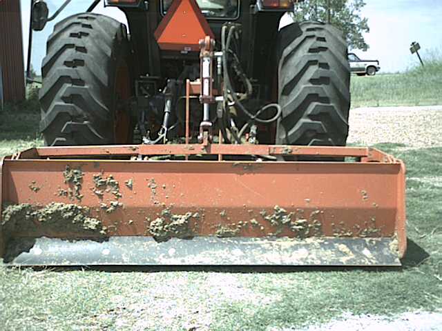

Does it even come close to having the same down pressure and 'controlability' as the front?
The only down pressure on most 3 point hitches is the weight and angle of the implement, so the answer is no. Most guys add weight to their box blades.
With it on the front you can apply down pressure and with independent suspension still have some front traction.
Here is an 8 ft on the 3 point. The Toolcat handles it just fine:
