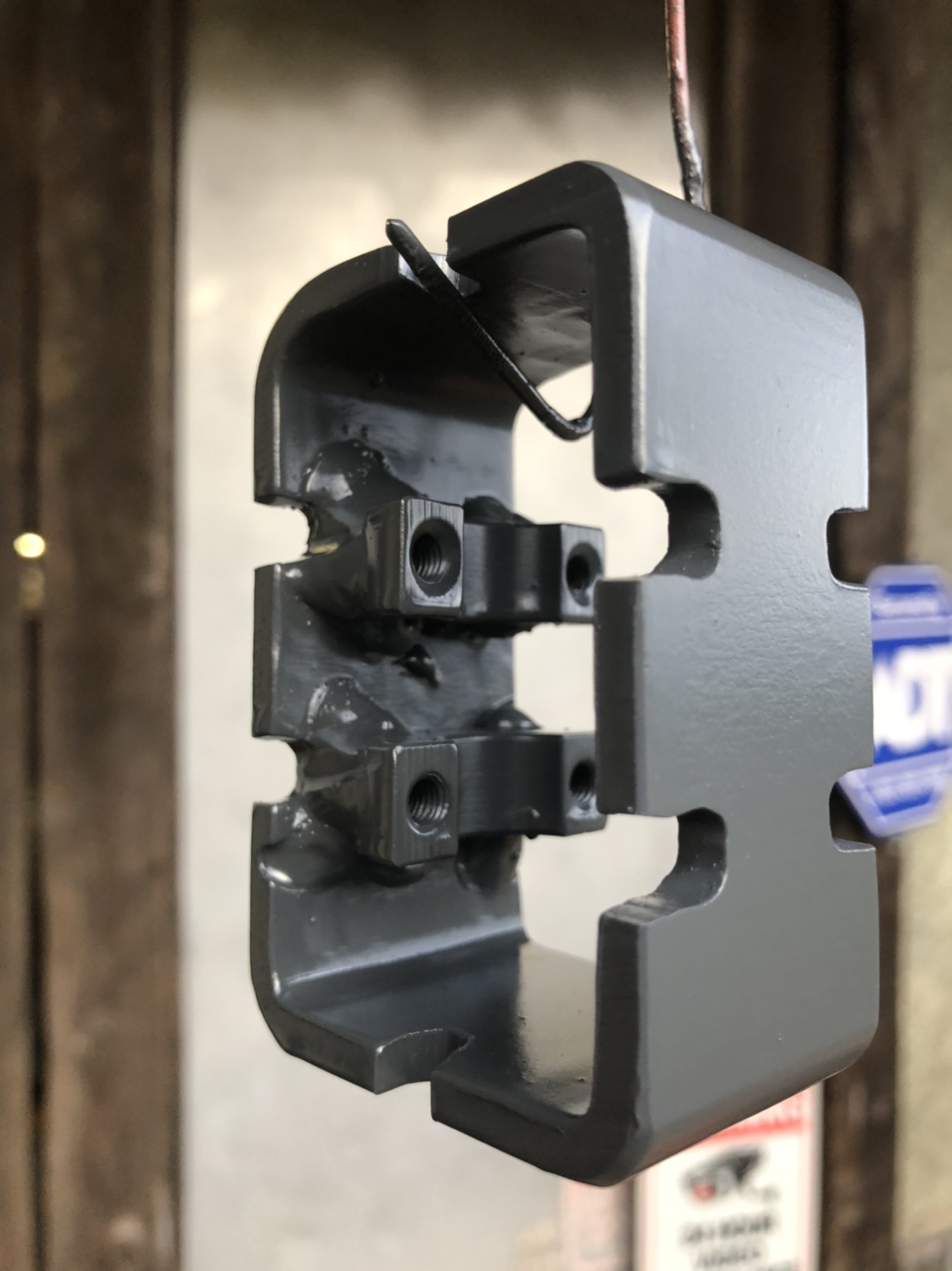

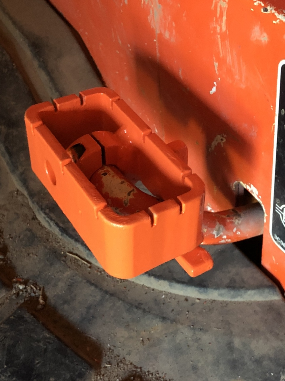

Made these steps to help our tractors diff lock. Welded two piece shaft collars to scrap tubing and clamped to the lever.

However - I DO LIKE that pedal you made there - Smokeydog.

My wife does most of the finish mowing with the B26 and requires 4wd and occasional diff lock. All the way engaged or foot off. Hard to do given the stout spring, her size and competing terrain. 23 years with the previous B20 the diff lock was getting worn. Similar problem with ergonomics coupled with muddy or wet shoes on the M59. Steps fixed all issues and added some safety comfort. There is a nice tactile thud of the lock disengaging from the added weight of the step.
With R4 tires and HST use the diff lock more than regular farm tractors with R1 tires.
