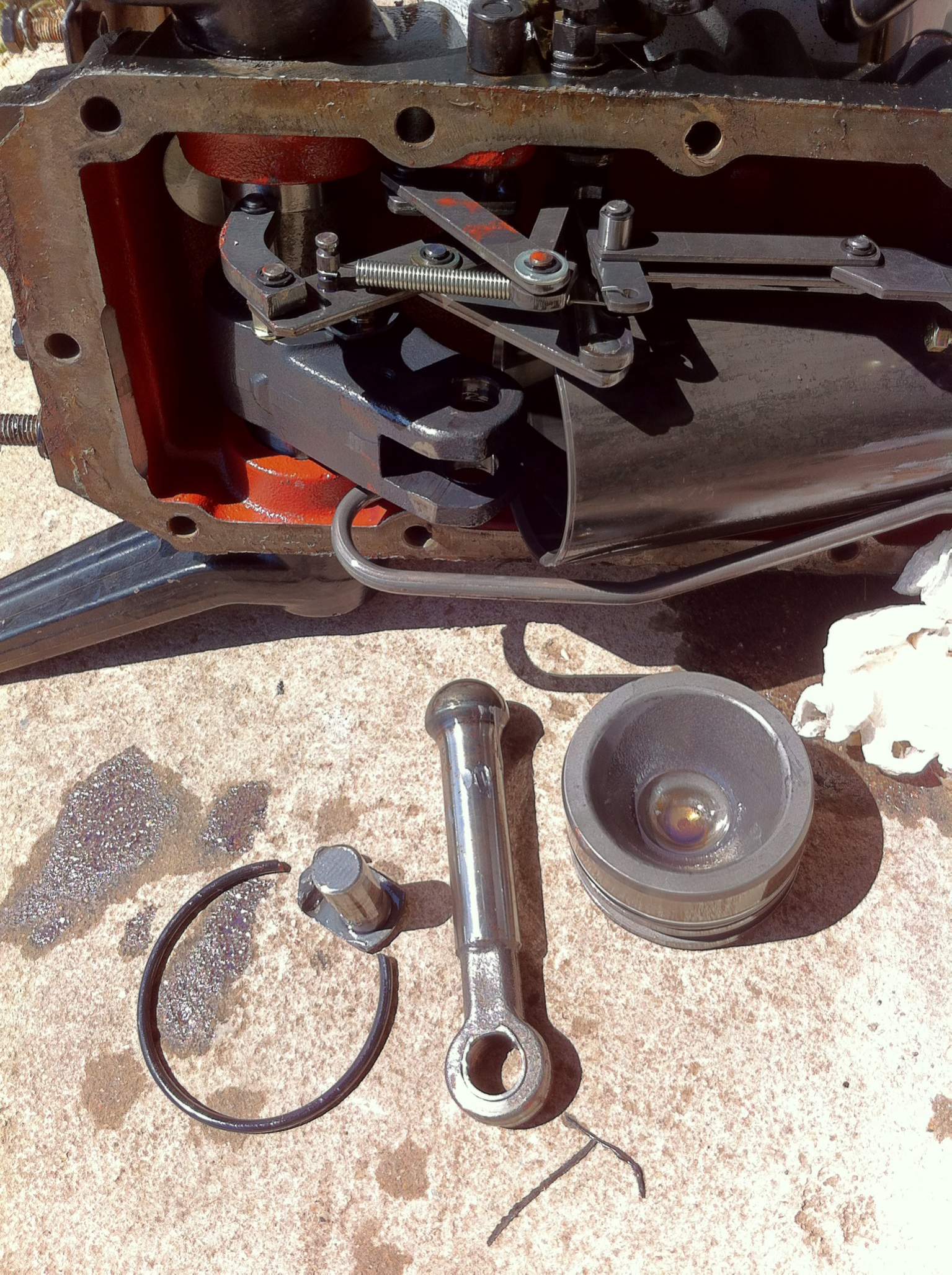

Removed the 3point hydraulic top end today and discovered that a small retaining bolt that holds the wrist pin to the power arm was missing. This in turn allowed the wrist pin to fall out and release the piston rod from the power arm. The rod is not connected to the piston by design and the piston pushed out the bottom of the cylinder. All of the parts were sitting on top of the pto gears with the exception of the small bolt which is probably in the bottom of the case. Couldn't find it with a telescopic magnet. The bolt, wrist pin/bushing, rod and a piston o-ring were all damaged by either use while coming apart or the pto gears grinding against them. Replacement parts are around $30 +shipping and it took about an hour and a half to remove the top end. My first time working on a tractor but I'm a fair "hack" mechanic. Just take your time if you ever attempt this. Parts should be here in a week or so. I'll try to get some pic's with this post.

top end.jpg The top end removed. This assembly is easily over a hundred pounds so watch your fingers. I was able to access and remove a couple hydraulic lines and all of the bolts after the seat was out and the rear fixed point assembly removed. the hardest part is removing the 3 point lift control lever linkage.

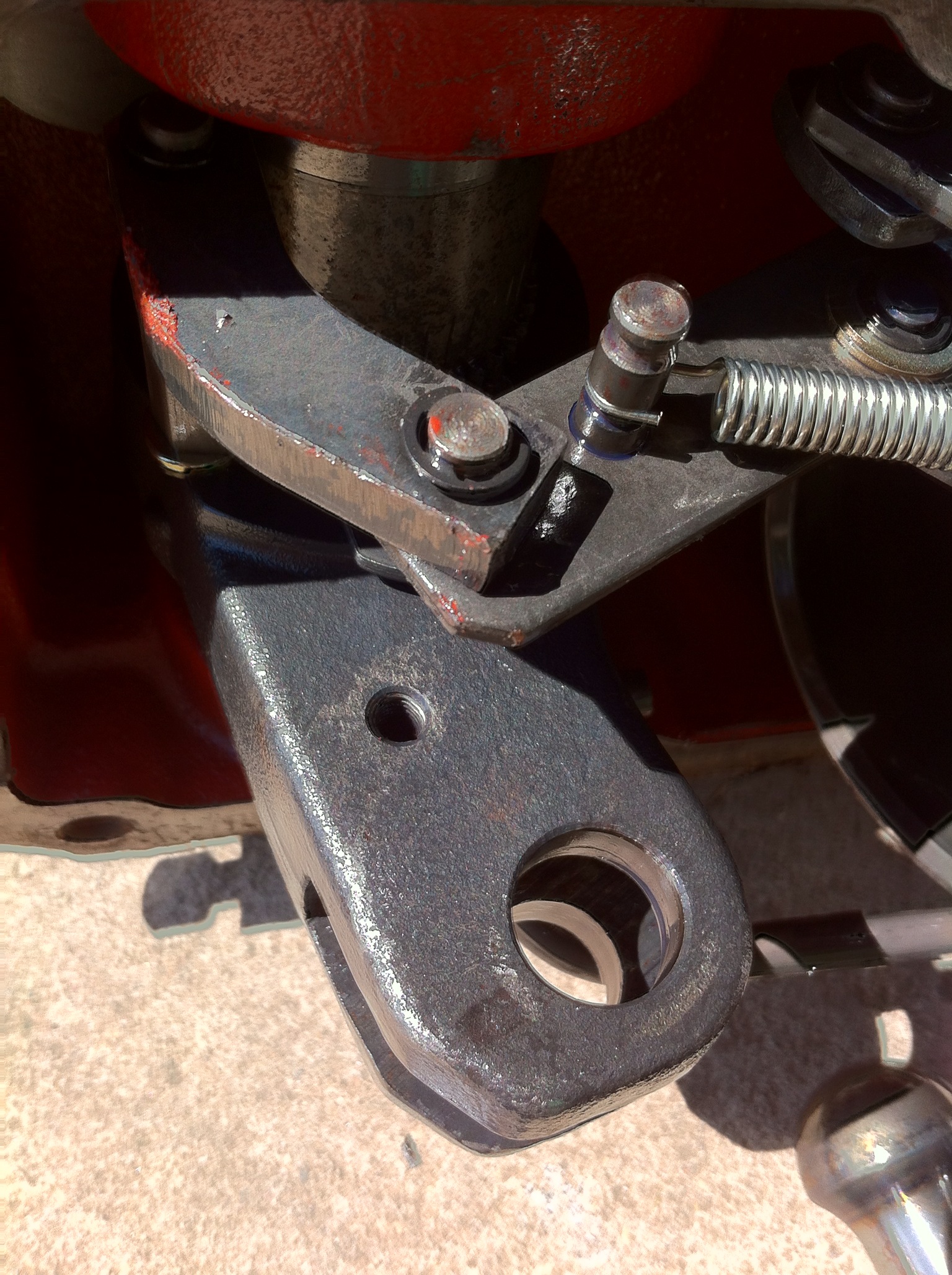

power arm.jpg The threaded hole on the power arm is where the small retaining bolt worked its way out and allowed the wrist pin to come out of the arm. There was moderate gaulling to the connecting rod and no sign of the bushing that buffers the wrist pin/rod.

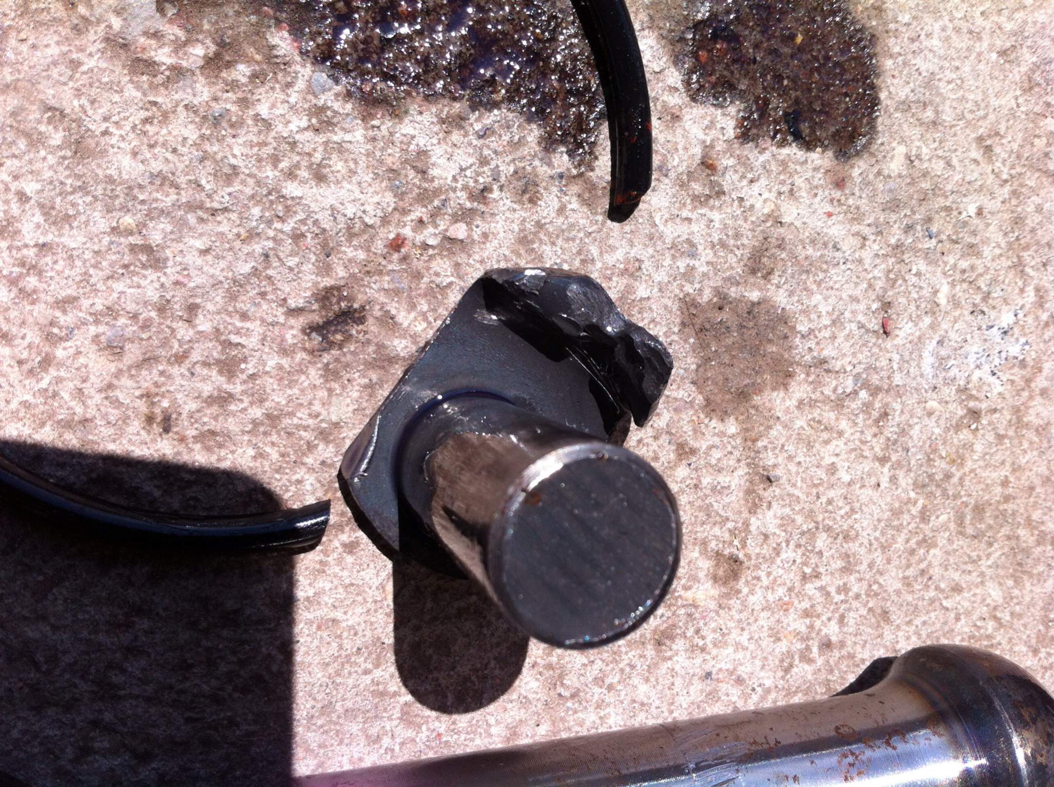

wrist pin.jpg wrist pin damage. Most of the tab that is fastened by the retaining screw to the power arm is missing.

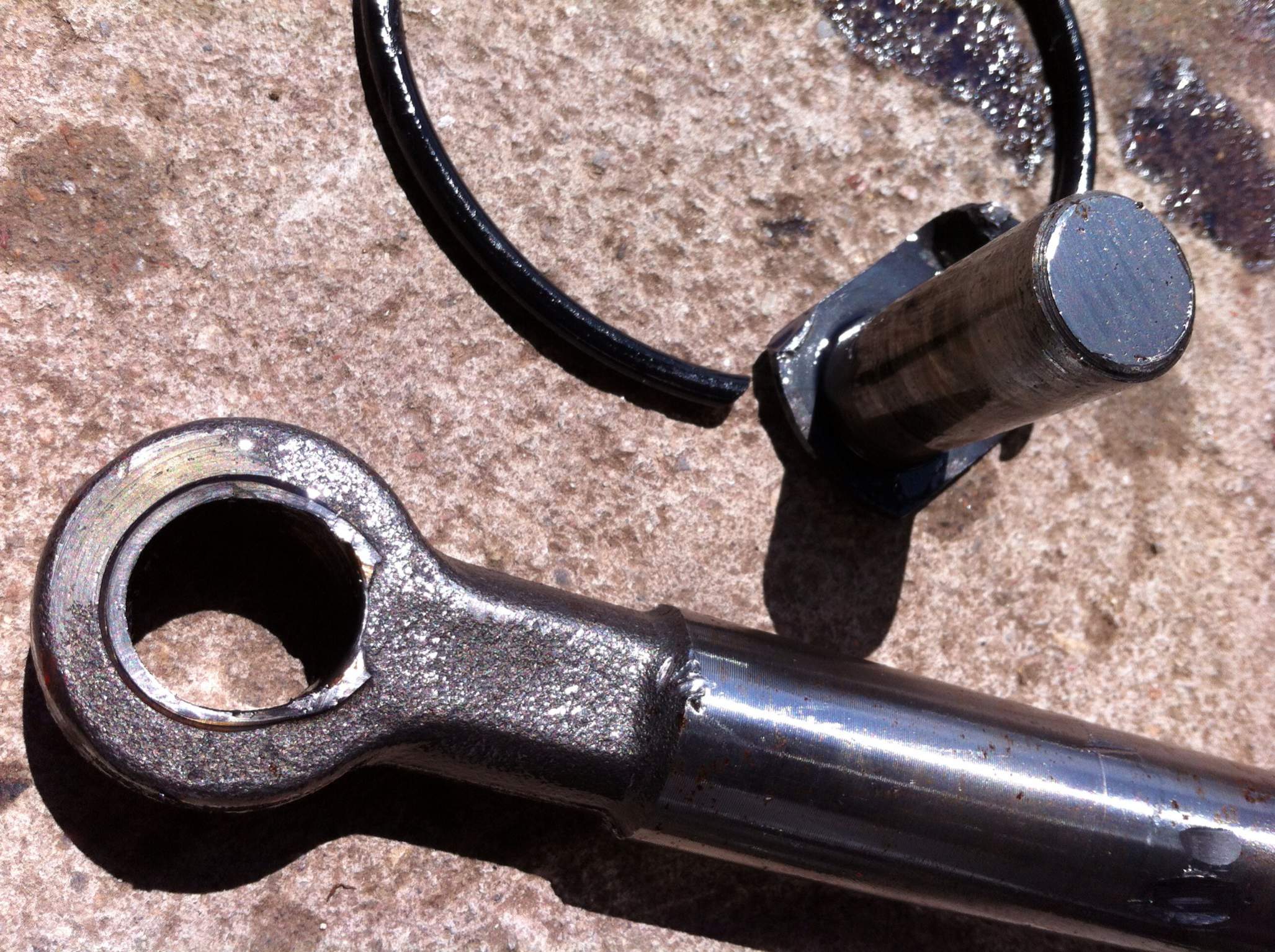

rod.jpg Damaged connecting rod.
