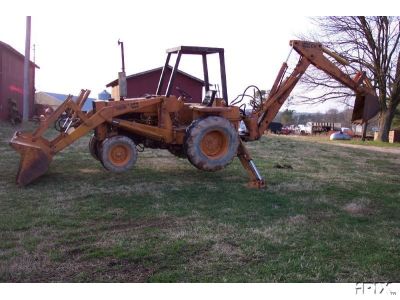

Okay, what's going on with this picture here? I found this 580B case backhoe on ebay and got this pic of it's hoe controls. At first it looks to be the JD converted type but you see that it still has the normal swing foot petals. Where's the middle control for the dipper? Or do those phoot pedals do something else if it's JD control type.?

Here's the whole pic. of the backhoe just for last.

on the JD 710 model that I run, the left pedal as you sit in seat, runs the extenda hoe and the right pedal runs either the twist wrist when doing ditches or the hammer circuit when that is hooked up.
   / 580B wierd control pic. #4
I would say it's a pedal swing, left large lever only moves to and away to run the lift, and the right runs the crowd and bucket. If you look hard the left lever has no "wobble" ball joints, and the decal only shows one direction. The right lever decal is much wider, showing both actions it provides.
   / 580B wierd control pic. #5
Blake I believe that pic is a wobble stick, I run one for the county that is set up like that. Case had a funny way they mounted the woble stick controls differint control linkages than Ford JD and Cat. they had there swivel mounts for the bucket and swing control offset to one side. The other posbility is that those are foot rests like the county office has or a the way it has the straight controls from the three stick on a Wobble stick conversion. I havent operated a late model wobble stick Case but on an older model Case I hate wobble sticks. Thats the only bad thing i have to say about any Case is the older wobble sticks. The older case wobble sticks feel too clumsy takes a while for me to get used to them. Thats the only machine i have problems with different controls

I have trouble w/ the old 4 stick ford.
A friend of dad's was using his neighbors old ford hoe and couldn't dig so they got me to run it.
I think someone replaced hoses and got handle direction reversed plus 50 yrs of wear and it was a royal PAIN.
   / 580B wierd control pic. #7
yeah my For haoe is right backwards from a MF and the larger 755 with the 4 stick is totally backwards. Dad taught me to not think about it and you can pick it up faster, now i can go from Wobble stick Ford/ Deere, or Cat, then get on and Excavator, then to crane or Case 3 stick but Cases wobble stick is very awkward to me the controls dont like to work smoothly if you want to boom up and swing or crowd and curl the bucket.

That is a very weird setup. I've never seen that on a case. I've seen the JD controls, without the foot pedals.
