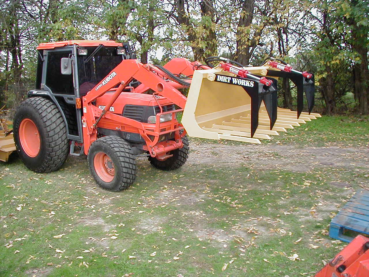

Cab Model GSQ42; Loader Model LA680; Bucket Model L1742A this is the usual 60 bucket on this loader. The factory Remote Cont. Model L2076.
I then added a skid steer Quick Tach. Model UH-7 from Kasco(Unihitch), and got a Grapple Fork 76.5 from DirtWorks. At the same time I purchased a 60 4in1 heavy duty Thomas skid steer bucket. I have never used the grapple fork since the 4in1 works so well. If you are close enough I would sell you the grapple fork, if you are close to dirt work you can get one there as shipping is outrageous any more.
I assume you know that switching from factory turf tires will require different rims also I switched to oversized turf tires and rims, I love them.

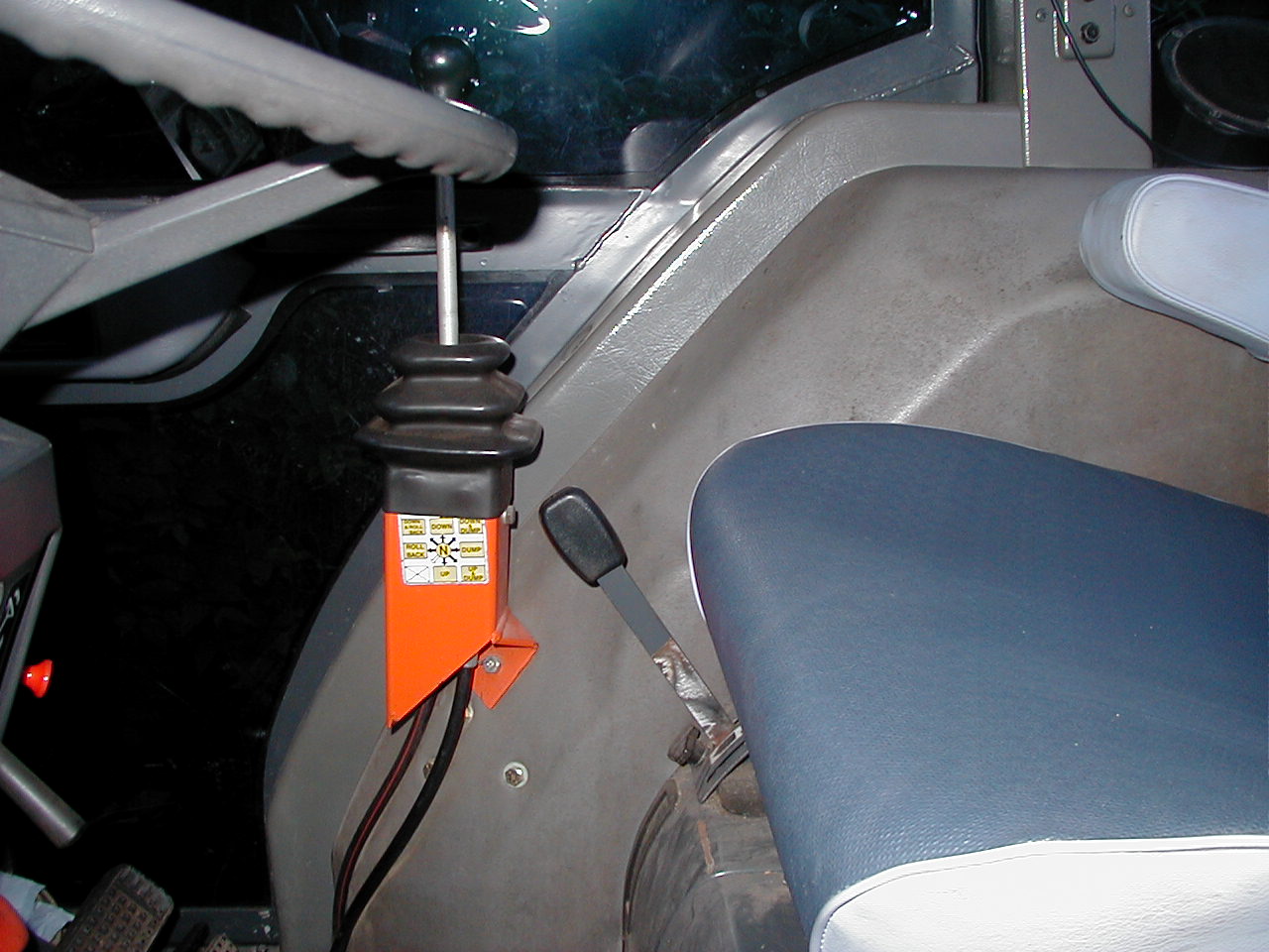

You may have quite a time getting your loader remote placed on the right inner fender unless you replace the valve body and control

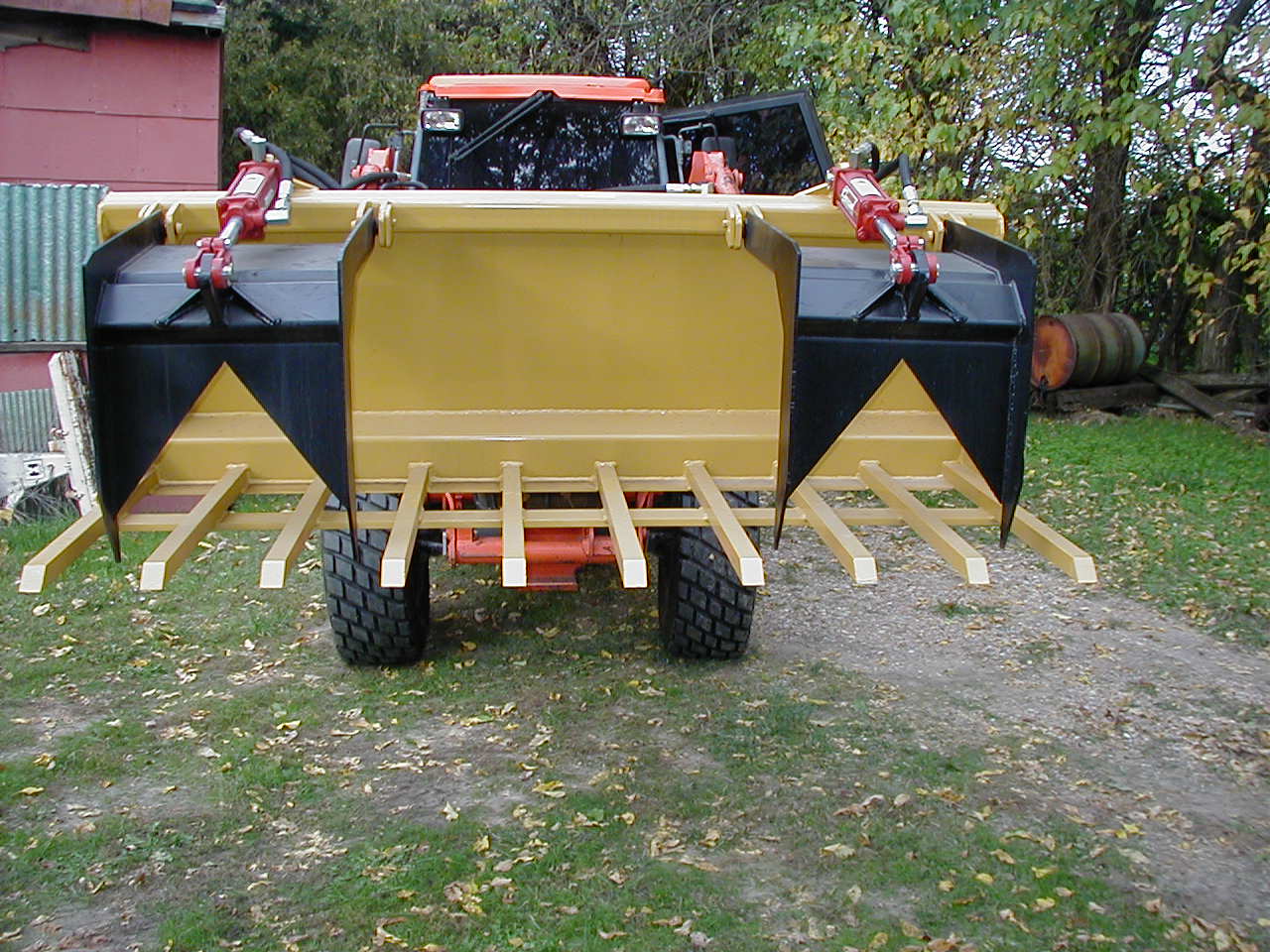

I did mount the grapple when I received it and took this picture I find the 4in1 so much handier, but this is what it looks like with that big grapple attached. KennyV

This is the remote and the valve assembly KennyV.
If you need anything let me know...
   / 59" bucket on a LA680 Loader L4200 Tractor #6
Today we put 72" buckets on all tractors that size. The Valve can be converted to the cable style with out any trouble but the control would be expensive by parts. They are all about the same as far as handles but some companies did make them different!
