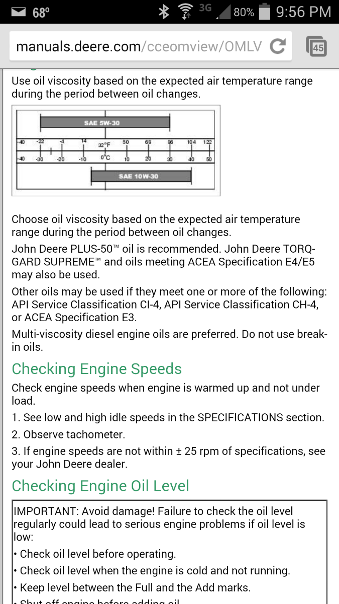

I was trying to do good today and get caught up on all the vehicle maintenance on the property, oil changes and the like. I just realized though sitting at dinner and making my list of supplies to have on hand I did my oil change on my 2320 using 5W-20 like I use on my trucks instead of 5W-30. Is it going to be big enough of a deal to change it out or should I be ok. I only have just shy of 100 hours on it and I live in eastern PA if that helps for the climate I will see this winter.
Thanks!!

Id be more worried if the oil has the correct api classification. diesel oils are not the same as oil for gas engines. This would likely cause far more damage than a light weight oil. I know automotive oems changed oil ratings from 10W30 to 5W30 and then 5W20 without making changes to the engines. This was done for fuel economy. Like others mentioned this will probably cause some additional wear but I would guess it would be minimal especially if its synthetic.
If your oil does not have one of these ratings drain it no questions asked.
API Service Classification CI-4, API Service Classification CH-4, or ACEA Specification E3.
Per john deere
Choose oil viscosity based on the expected air temperature range during the period between oil changes.
John Deere PLUS-50™ oil is recommended. John Deere TORQ-GARD SUPREME™ and oils meeting ACEA Specification E4/E5 may also be used.
Other oils may be used if they meet one or more of the following:
API Service

I would immediately change the oil to the correct oil. I use 15W40 Mobil diesel oil in my 2320 year around and would not consider using a lighter oil.

Diesel rated oil handles soot better so the gas oil just will degrade faster.
,,, Too light an oil is very sensitive to any contaminant because the oil clearance in the load zone of the bearing is smaller. The hydrodynamic bearing requires viscosity and speed to keep the surfaces separated under load. An automotive gas engine operates at higher rpm and seldom sees heavy load at low rpm because if you want to move now the throttle and a downshift go together. On a governed engine the throttle advances automatically to hold speed. You only notice overload when it starts to bog. If youre running mid rpm on a diesel its going pretty slow but with max torque available via the governor. I would never consider using 20wt in a tractor diesel except in the winter. I dont think you will find any mfg recommending a 20wt in a temperate climate.
