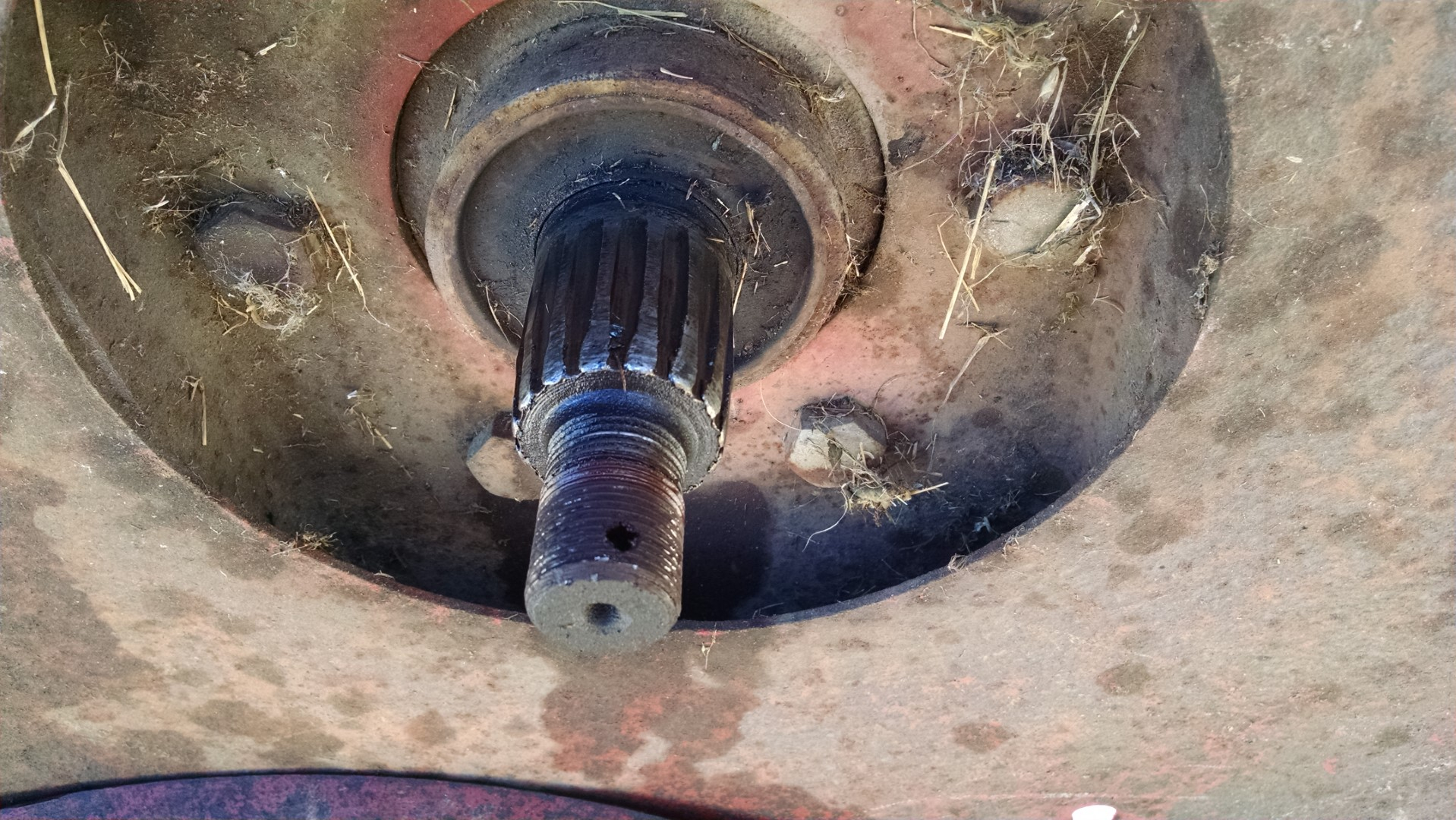

The gearbox output shaft is tapered and probably is damaged/misshapen from the nut being loose. Time for a new gearbox and stump jumper.

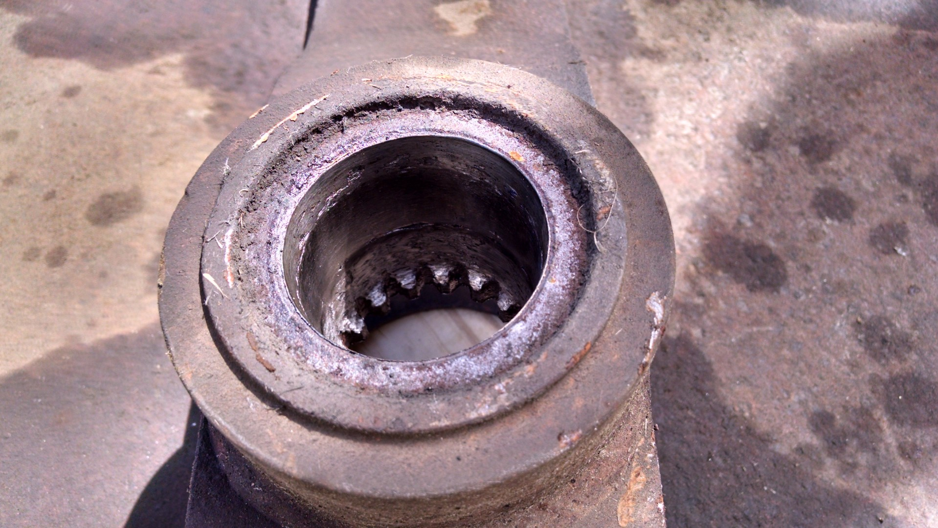

The damage from my Bushhog 286 spindle and nut from years ago:
So I was looking at:
Replacing the bushhog
Replacing the gearbox and stump jumper
Replacing the spindle and stump jumper
Welding the crap out of it.

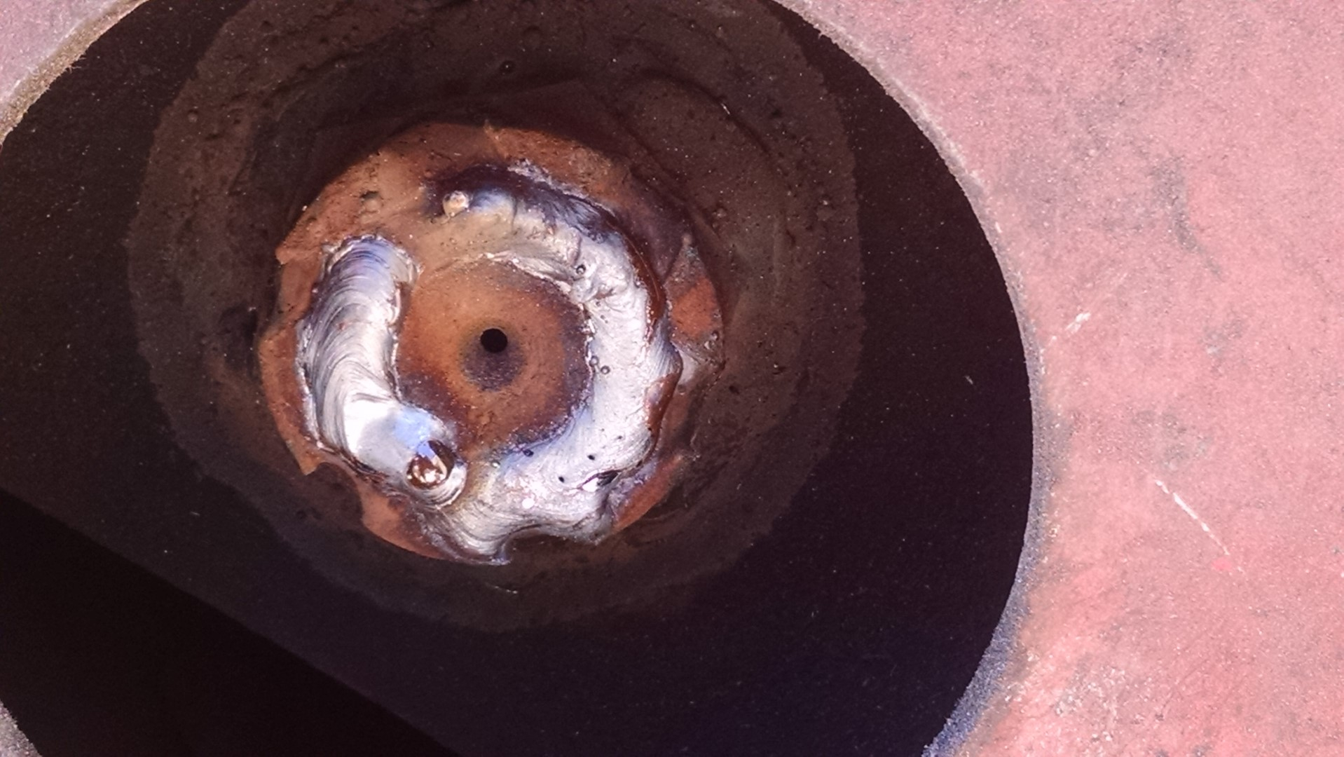

$10 says you can figure out what I chose to do. :)
After welding it and running it a few times, I found myself constantly looking back over my shoulder seeing if it was still running. Compared to before, it was very quiet!
Did that repair April 2019, so it's had two seasons of cutting since then; no problems. If it breaks, I'm no worse off than I was then.
Good luck!
