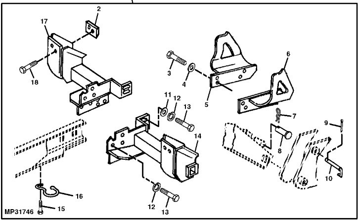

I recently purchased a used 60 loader for my 670.It came with no mounting brackets,but i thought "how expensive could 4 brackets really be?".I quickly found out.If i buy the brackets individually from deere i will spend $1000 dollars.Wow.The BM part number is no longer listed on deereparts.I have searched partsdepot.com but came up empty handed.Any ideas?Thanks!
AM107063 Left Front
AM107062 Right Front
AM107065 Left Rear
AM107064 Right Rear

I have both your OMM79638 and a third version 60, 70, 70A loader manual, OMM115223. It also has no info on mounting brackets. Looks like the drawing and parts list on JD Parts should provide enough info to do the install. The operator manual does have info on adjusting the loader to the mounts.
