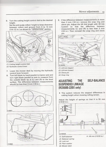

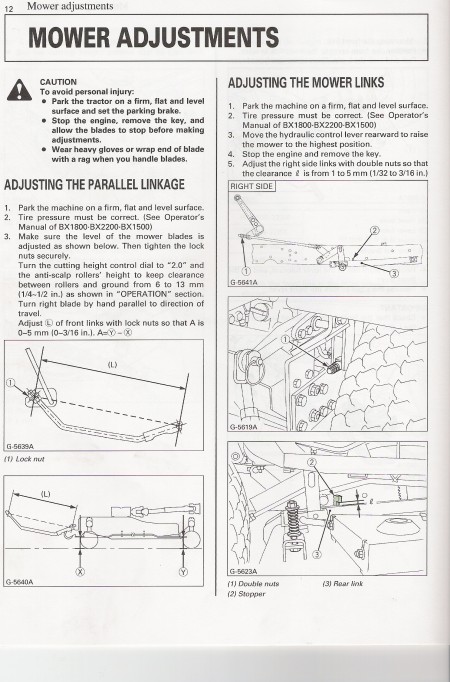

My BX just came back with the new bar tires on it and I need to re-adjust the 60" MMM height. Unfortunately, my owner's manual with the "clear as mud" Kubota instructions is nowhere to be found.
I've done some searching to see if anyone has posted PDF scans of this manual before, but haven't found any. If anyone has the mower operator's manual and would be willing to scan it, I would truly appreciate it.
The deck is currently running at 3.25" inches with the height adjustment knob set at 4.0, so a considerable amount of adjustment is needed!
   / 60" MMM Owner's Manual Needed #2
Re: 60\" MMM Owner\'s Manual Needed
The bar tires and the turf tires have the same circumference, so no adjustment should be neccessary....
   / 60" MMM Owner's Manual Needed #3
If you can't read these, send me a PM with an email address and I will forward you larger files. I had to reduce quite a bit to post as attachements.

Heres the second page.
