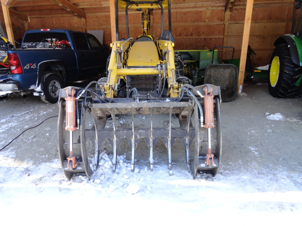

I have a 66" grapple for my JD110. It's more of a root grapple - as such, and is very HD. Just over 800lbs.
The weight is not so much an issue - IMO. The inherent problem that I've discovered is side to side twisting of the loader boom arms with very long (wide) loads. Full size trees or big, wide root wads with dirt loaded root mass.
A wider grapple extends further out from the loader boom arms and can exert more lateral leverage on the loader arm.
For that reason I"d recommend the 60". I've seriously considered re-working my grapple by lopping off the 2, outer most tines. That would place the edge of the grapple just outside of the SS mounting attachment.
In the meantime; I carefully gauge the length of the trees and chainsaw the longest ones to a more manageble length. Keep the load just clear of the ground surface when moving. And only raise the load above hood height (or more) when the tractor is completely stopped.

i have a 72' grapple on my 110 which weighs 750 lbs. The good part of the 72 is that it will grab a little more brush and when raking up roots and debris will clear a path the same width as the tires. the bad part is the weight of the grapple. when dumping the grapple it comes down very fast and will bottom out on the loader arm stops with a bang unless you feather the control carefully. I've learned to do so; and even glued a hard rubber block stop on the loader arm stop to cushion the stop. This grapple is 300 lbs heavier than the HD bucket and i really notice the difference on the dump function. there is stiil plently of lift capacity on the loader and dont notice a weakness there.

Yep... my experience, too! All that iron and mean 'ol mister gravity! :laughing:
I don't recall posting a closer pic of my grapple. Some with trees in the jaws... but not empty.
The tines are 1" thick. Most of the frame is 1/2" with some material on the mounting side is 5/16" - which is the thinnest dimension. Very heavy.
AKfish

Couple things I see in those pictures, 1. a nice HD grapple (not mine), 2 a nicer (newer) 5085M than my 5410, and it has a cab, 3. You still got a lot of snow! We've lost all of our snow and it's supposed to be 60F tomorrow!
The pic is from a little while ago, so we have a little bit of snow still around. I believe my grapple was involved in a hit and run with a semi, though. Still puzzled how all of his other stuff is so nice and this grapple is a POS.
I'd go with the 60" grapple as well. There's a point where the nimbleness is nice. Plus, what is the extra 12" really getting you? It's not like it does anything better. You can still pick up the big logs and the small stick with either. The 72" is just a lot bigger and more unneeded/wanted weight IMO.
