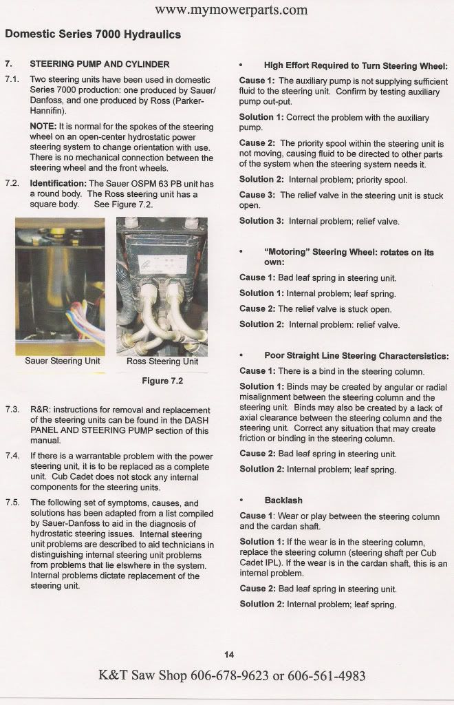

Here's what the service manual says about tight steering.
Cub says the 7000 series service manual is used for the 6284 and I've uploaded the manual here.
Cub_Cadet_7000_Series_Domestic_Service_Repair_Manual.pdf

Old Machinist,
Thanks for that. I thought that was probably the case but didn't want to offer that advice since I was not sure. I was planning on taking a look at my 6284 and comparing it to the 7000 manual before making more specific recommendations like that.
And actually, I was hoping you would jump in here and clarify it exactly the way you did!
