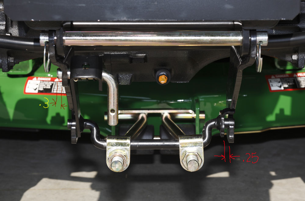

Mounted the 62D to the 2320 today and on the drive back to the garage from the flat section of lawn I used for mounting the front draft arm spring pin popped off twice, basically dropping the front of the deck. First time I thought maybe I hadn't fully seated the pin, but on the second I shifted the draft arm over towards the left (from front) of the bracket and made sure the pin fully seated. Still came off. Yard isn't perfectly flat yet so I did go over a slight bump each time, but I was in low range at just over idle so I was not going very fast. Any one else experienced this?

It sounds like the front draft arm piece that holds the pin is bent. There should not be a whole lot of play side to side either. Make sure the flat piece that hold the pin and spring is flat against the right hand bracket. Also make sure the pin is not damage and that it is not twisted. Does the spring look alright? The carrier brackets are mounted to the inside of the frame rails?
   / 62D front draft arm problem. #3
Make sure the arm is installed so the spring loaded pin is on the right side of the tractor. Once I attempted to install the arm upside down and the pin was on the left and did not fit correctly.

I've attached an image with some crude dimensioning. I don't see that anything is bent, but there is certainly what I consider a lot of play. On the right side in the image is 1/4", and on the left side is almost an 1/8", so total play is .375", which seems like a lot to me and seems to be the root of the problem when the .250" on the right is coupled with the .3" extension of the pin and the chamfered tip of the pin. All these parts are brand new, and I think I have them installed correctly, so maybe I just have two parts at opposite ends of the spectrum in terms of tolerances which is creating a stack-up that allows the pin to pop free. How do these measurements compare to anyone else who is willing to go take a look at their draft arm:D

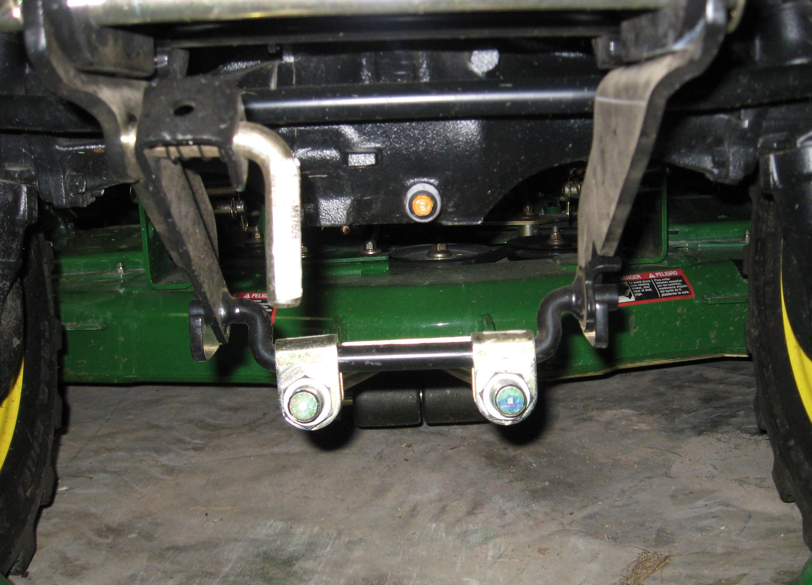

Assuming the 2520 and 2320 front brackets are the same (and they appear to be) mine looks just like yours. I have about 1/4 inch clearance on one side and 1/16 on the other. Haven't had the problem you describe.
My pin doesn't seem to go as far in as yours does, the other end of it was about flush with the hole.
I did notice that the holes in the L shaped pin seemed to be different distances from the ends, and chose to assemble mine using the hole farthest from the end.

Thanks Runner. I'll give it one more try and if it happens again I'll either sleeve the right side with a piece of polymer or "adjust" the arm on the left to take up some of the slack. Thanks for posting the picture.

Hmmm... first time I took my mower off, I couldn't get this arm back into position. I had to loosen the bolts holding the bolts holding the brackets onto the tractor frame in order to have enough space on my 2520. I don't have any play at all -- a very snug fit.
I guess this is better than the mower falling off. Yeesh!

Asked the dealer about this when I stopped in for something else, and he said they haven't heard of it before. I suggested to him maybe I just have two parts at oppsite ends of the tolerance, and from what farmerhays stated it sounds like there is some variance in these parts. He agreed and told me he'd get back to me. They've been really good to me in the past so I expect he'll offer some sort of solution; I just hope it isn't a stack of washers.
