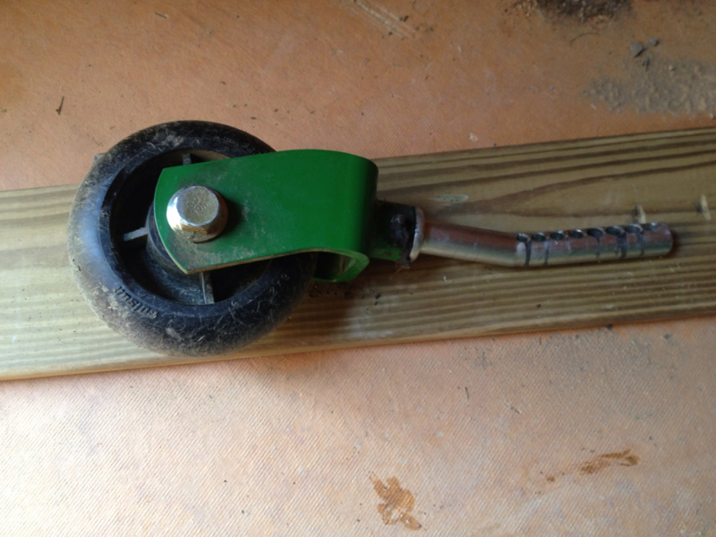

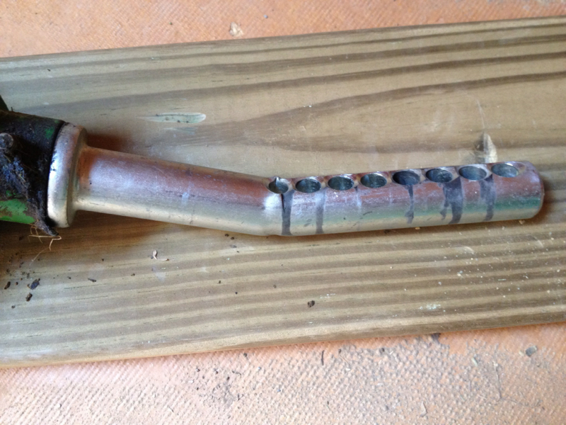

Sounds like some of you guys have been through this before. I caught the front left wheel (as you sit in the operators seat) on my 62D on the ramp as I was backing into our barn. When I parked, this is what I had. No loud thud, no forcing in my part. I back into the building at like 0.01 mph. Guess it just got on the wrong angle this time.
Anyone have any suggestions on bending it back? I have tried beating it with a hammer as well as apply heat plus the hammer, and I'm impressed with its stubborn inability to bend back. I bit the bullet and ordered another shaft from my dealer, but it would be nice to be able to at least keep this one as a spare for the future.

   / 62D gage wheel shafts breaking on 2520 #7
Just buy a new one. ;)
I press could be used to bend it back, but then it would be pretty weak (if bending it back didn't break it).

kb250
I did the same thing to both fronts, priced them at deere and left empty handed. I stopped by a machine shop where two old guys were talking. I asked if they thought the parts could be straightened. They said we will try for free and if it works five dollars. One man put the part in a press and the two guys discussed how far past straight they should bend it so it would return to straight when released. After two trys on the firstand one on the second I leftwith two repaired shafts for 5 dollars.

Thanks for the replies. If I get a chance I'll see if I can stop by a machine shop. Otherwise I'll probably just wait for the new one.
