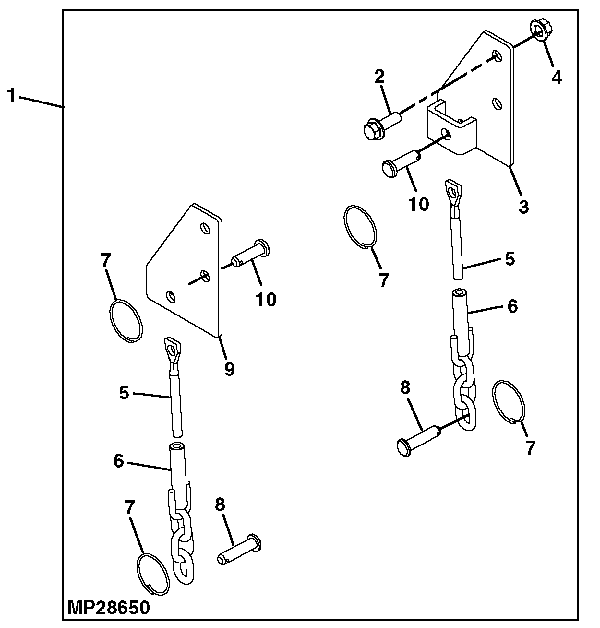

I just did the initial installation of the 62D on my 2520 (new 62D - old 2520).
All went fine, but I noticed that with the deck off, and dropping the 3PH, the deck linkage actually will drag on the ground.
Did some research, and found the lock-up kit - but for $150, I would rather fabricate my own.
Does anyone have a good photo of the Deere lock-up kit so I can use that to make a material list?
Or has anyone else done this themselves?

Don't have any pictures handy, but here is the parts diagram from the JD web site. The top triangular-shaped piece bolts to the fender bracket. Parts #5 and 6 are a turnbuckle that is welded to the chain which attaches to the three-point arms.

   / 62D lock-up kit #4
Hmm,that looks easy enough to make.
One question though,why the need for adjustability with the turnbuckle,and not a solid bar? Am I missing something?
Greg
   / 62D lock-up kit
Thanks for the diagram Runner - that is even better than a photo!
It looks like a bracket needs to be installed (#3 in the diagram) which would make more reason that the kit is so expensive.
I think the adjustability with the turn shackles isn't necessary either, but this kit might be made for multiple models, so the reason for the adjusters.
Hopefully I can fab something up without their bracket - once I get time to get going on this I will update.
