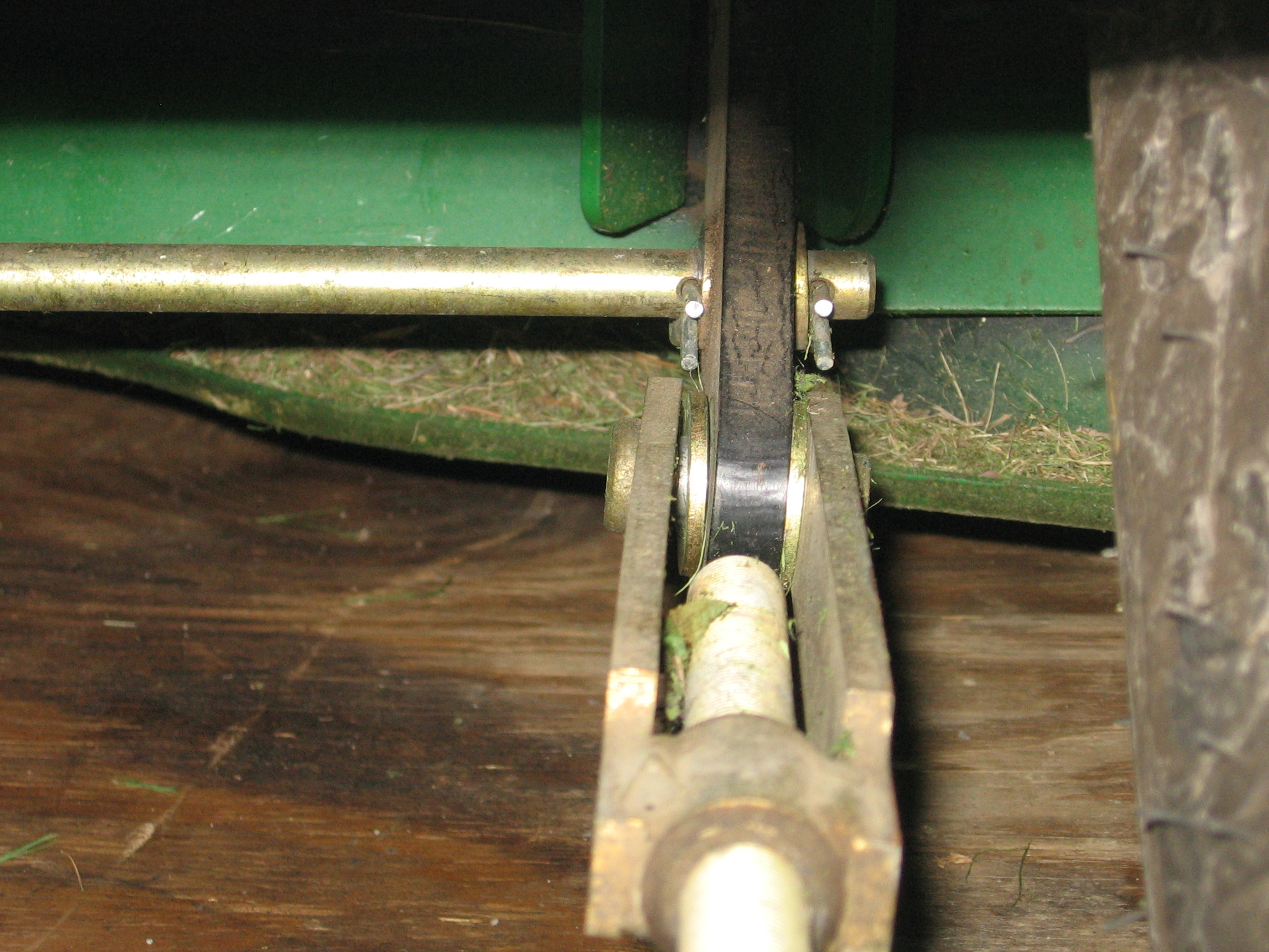

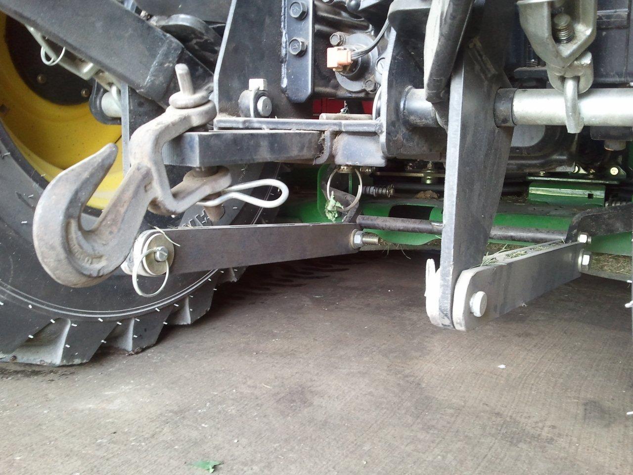

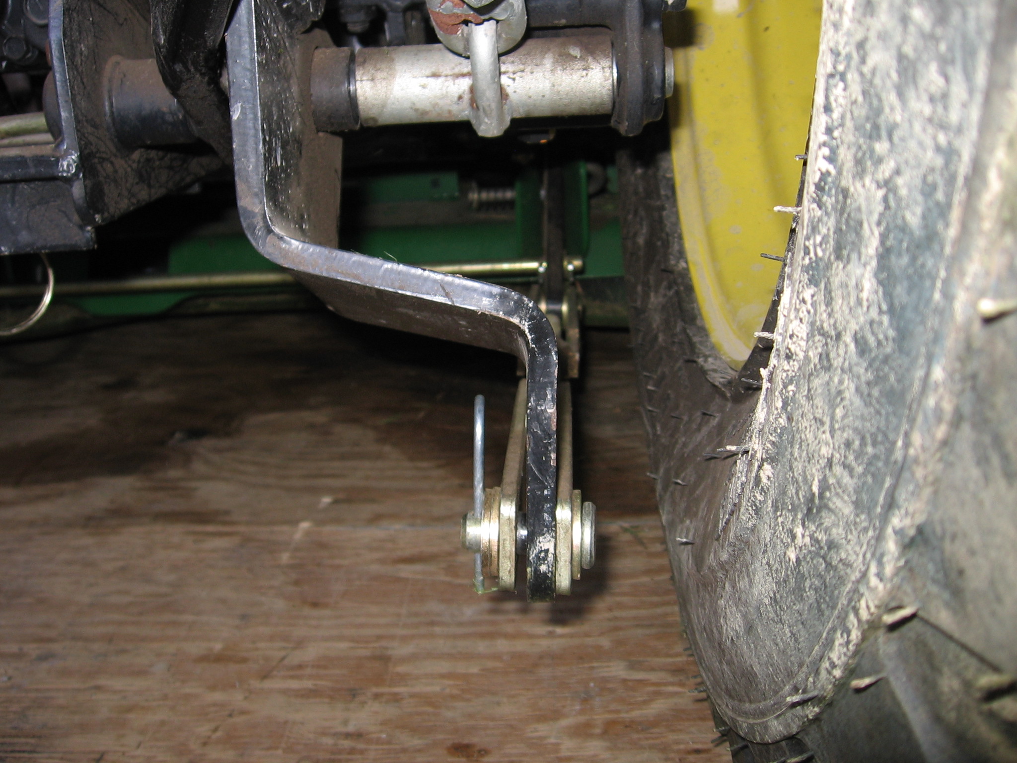

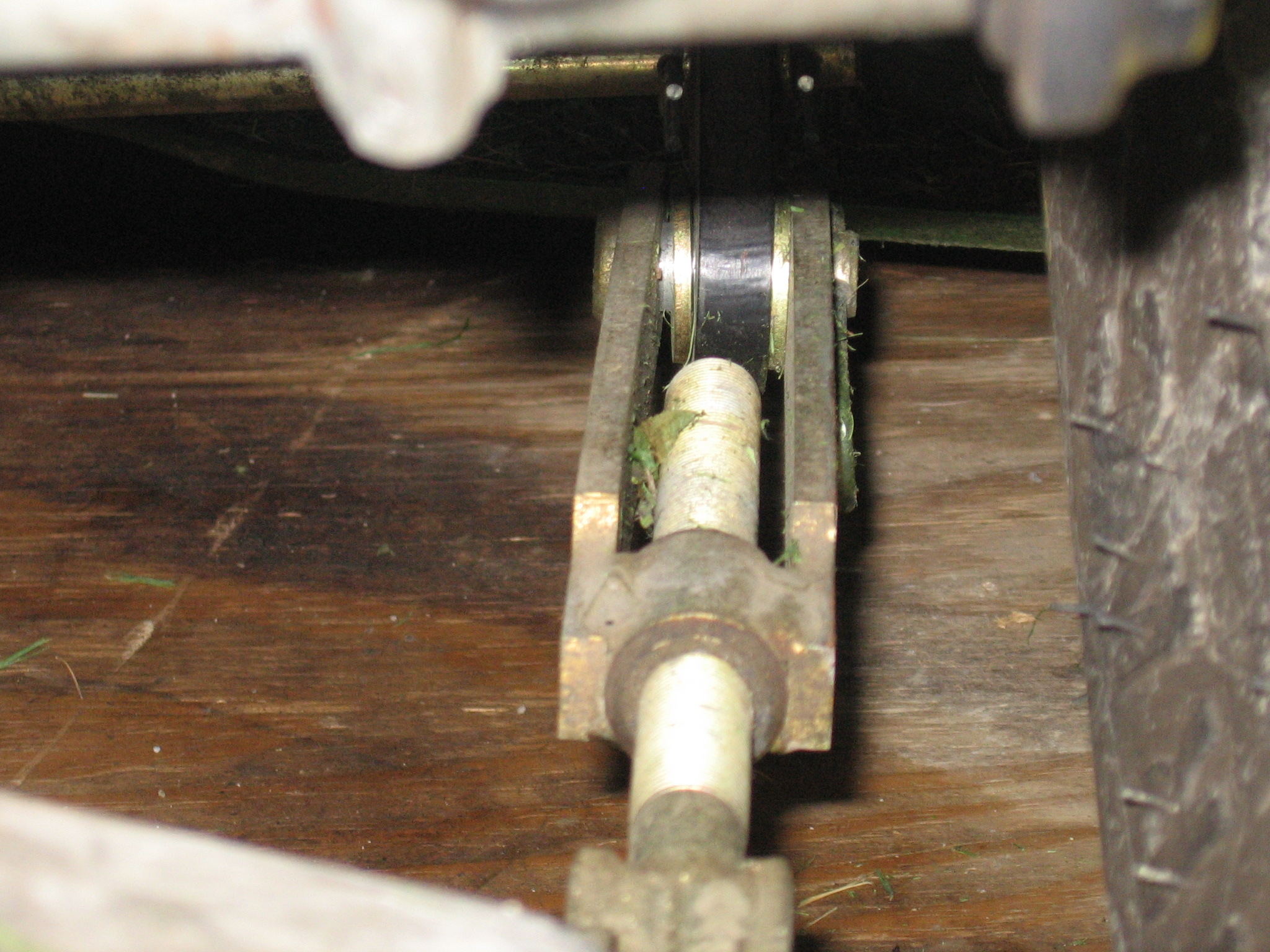

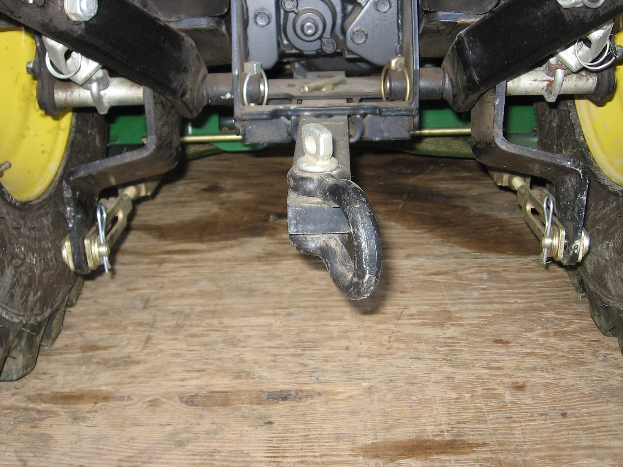

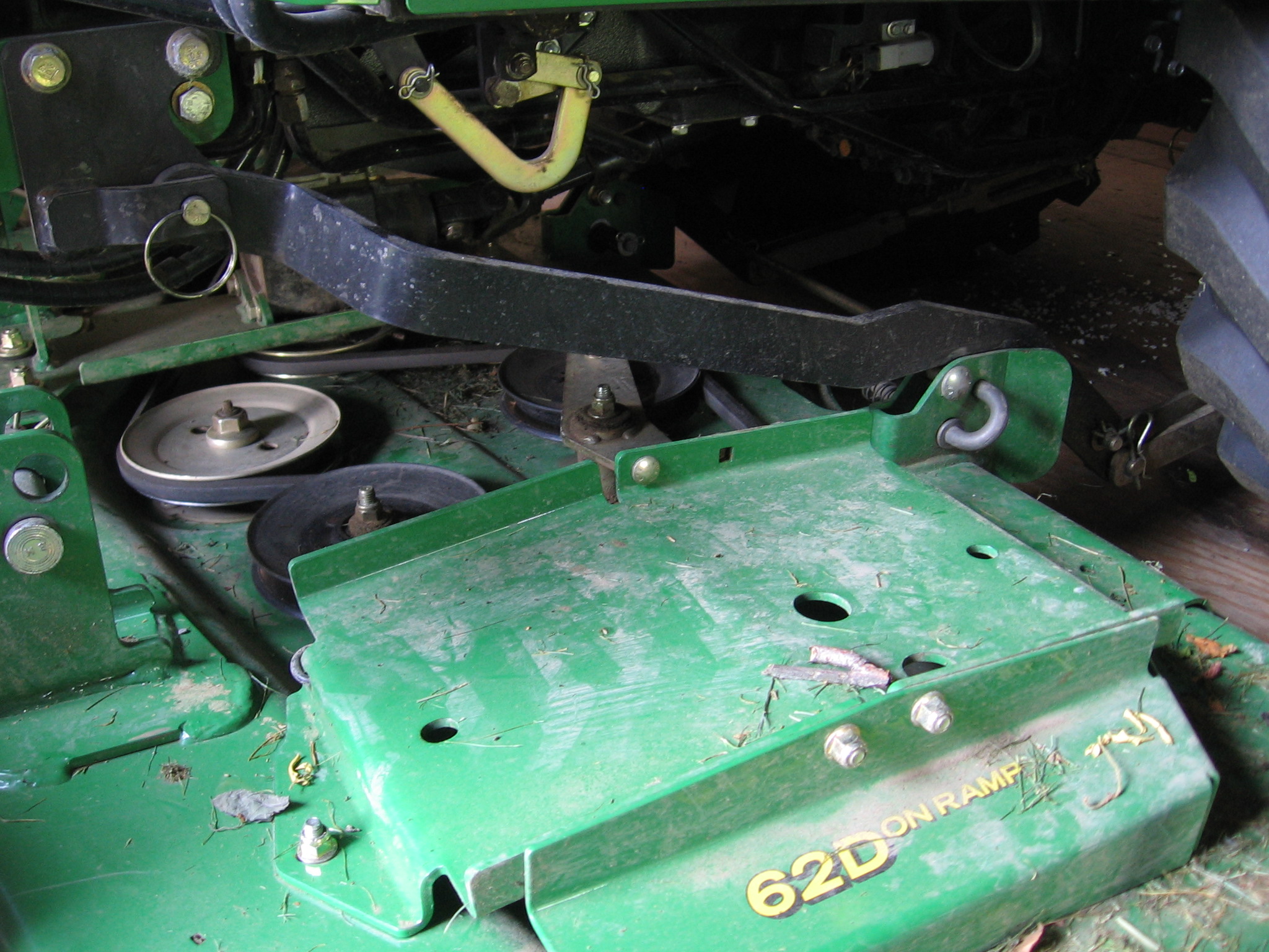

The cotter pins that are factory are absolutely garbage. They are way too small and there are not enough washers to tighten up the free play in the linkage. That is one of the very first things I addressed. Put beefier pins,cotter,lynch,hair,don't matter,just beef it up and take up all the play with washers and you won't have to worry about that becoming a problem again.:)

Greg, I used to leave a clevis hook on my drawbar like that all the time. I bent an eyebolt on my check chain, and couldn't figure out how, but thoght I must have damaged it when pushing stuff in reverse with my BB. When I bent the second one, I figured out that if the clevis swung to one side when the lower arms were below it, that it was possible to bend the eyebolt when raising the 3pt hitch...... just a thought.
   / 62D mid mount mower problems

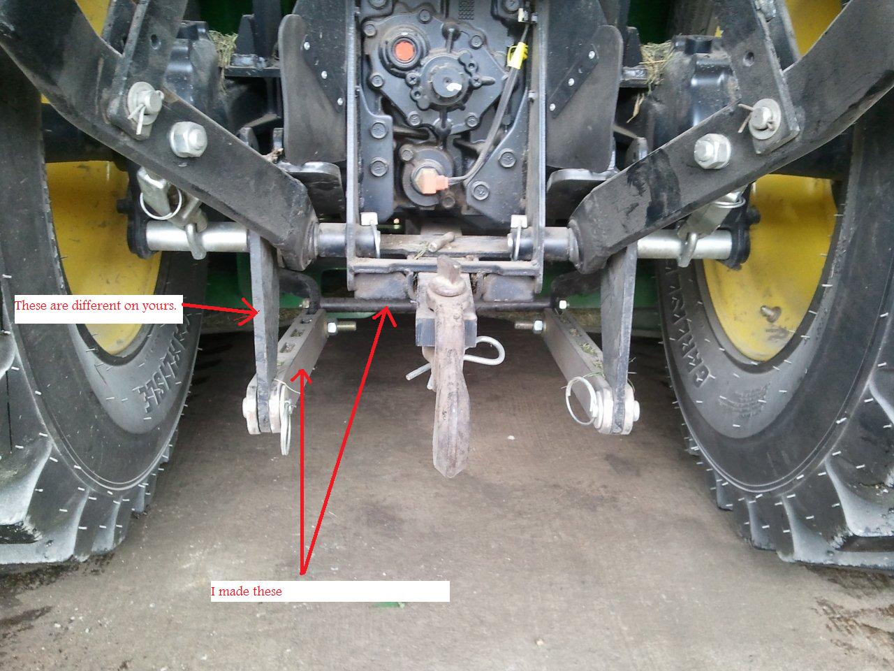

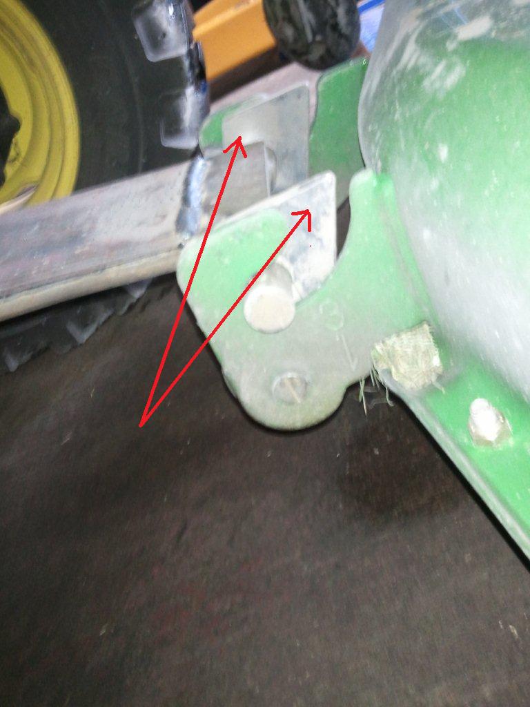

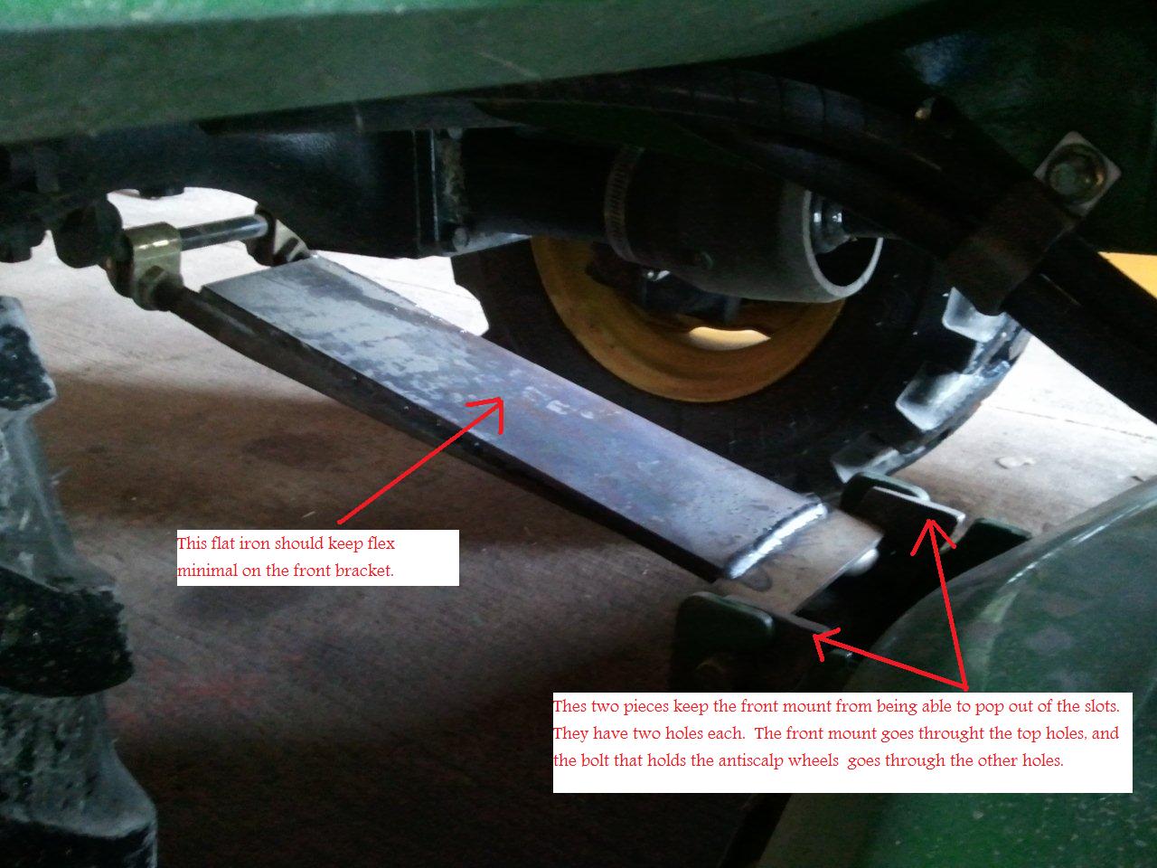

Thanks for the pics and input Greg. The zinc plated turn buckles in your pics are the ones that we keep bending. As a matter of fact they replaced mine last week and after only four hours of mowing, one is bent about 1/4". After seeing your pics I relized that I might know why this is a problem for me and not you. The three tractors that we are having problems with have different style of mounting than yours. The black bracket that hangs on the lower 3pt mounting pins on our machines are straight yet still mounted at the same place. I would bet that our 62D decks have the mounting points at different places. I assume that yours are wider than mine. Yours comes out to the sides and look like they almost touch the tire. Mine being closer together would allow the deck to work like a longer prybar on these brackets that I have been bending everytime the deck is is on a different plane than the rear tires of the tractor. Those pics help a lot. I have included a few pics of my brackets. They must have changed them between 2009 and 2010. Yesterday I made new brackets to replace the zinc ones, but mine do not have the slots in them so I have to remove the entire mounting system when I take the deck off, but so far they seem to work much better. I also took up any slop on any pin or shaft that I could find. The deck will still tilt side to side , but now the slop front to rear is gone. My only concern is that the old turn buckles were the weak link. If I hit something with the deck what will bend now? I also welded a piece of flat iron to the front bracket. I made two small pieces with two holes in them to keep the front bracket from ever being able to pop out of the deck mounting point. I will keep you guys updated if these fixes take care of our issues. I am open to hear any thoughts.

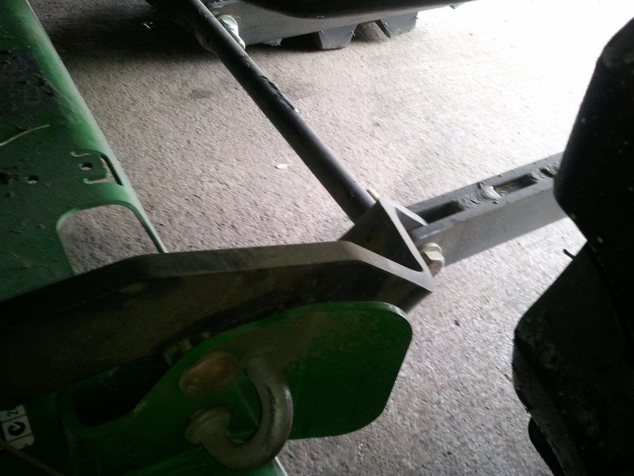

Hey Landon,you really made that thing bulletproof now,I like everything you did.:thumbsup: Did you also make the horizontal bar between the deck lift arms? That was a really good idea. I've been contemplating that mod myself.
I don't think so. Here is another pic. Yours does a Z bend,where mine stays straight.

Thanks Greg. The horizontal bar between the lift arms is made out of a 16" long 1/2" all thread (ready rod) with a 13.5" long 1/2"I.D. 7/8"O.D. bushing stock over top of it. I ground a slot in the center of the bushing stock down to the all thread and welded a bead in it to keep it from sliding out. Then I just used lock nuts on the ends to fasten it to the lift arms. I left the lock nuts just loose enough to so the arms can move independently.
