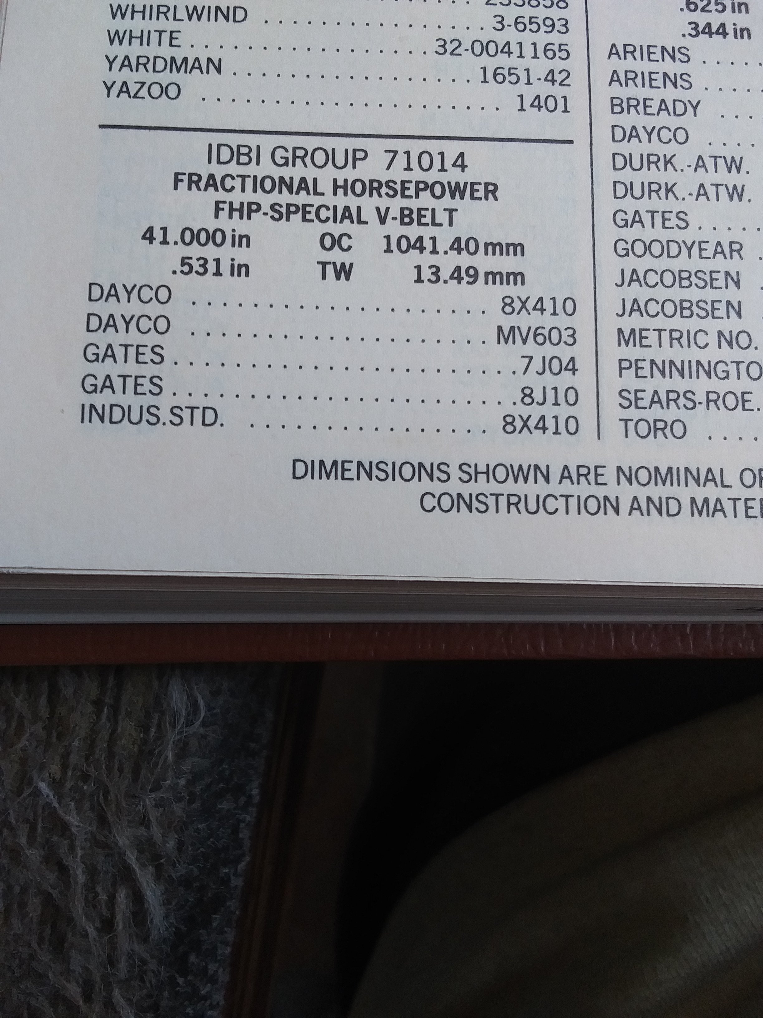

I have a 64 2000 that's converted to a 12V system with an alternator. I need a new belt, and I'm pretty sure when I replaced it the last time I chose the wrong one. So I don't want to use that one as a guide to find a new one. Steiner is calling for an 17/32" x 41-1/4". I'm not finding that belt anywhere other than Steiner, and shipping is more than the belt. I guess I'm wondering if that is the correct belt size/length, and if anyone has had luck with a belt from Amazon (I get free shipping) or Tractor Supply/NAPA where I could get it locally. Thanks!!

Closest that I could find in my big book of cross references.
