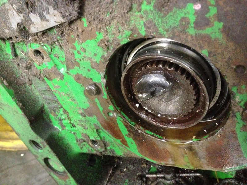

See picture. Is this an easy repair? Do i just remove the snap ring like a 4020?
   / 6410 pto spline shaft broke #2

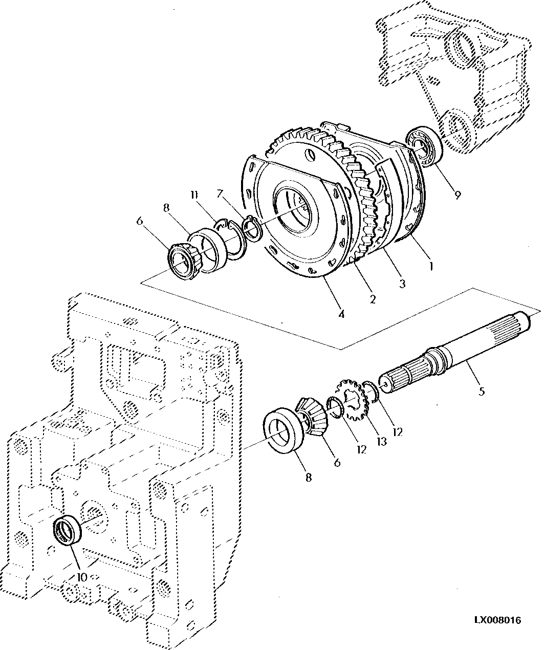

Is your tractors pto 540 only or 540/1000 rpm???? Dual pto is easy to change very similar to 4020. Single speed pto is more complicated.

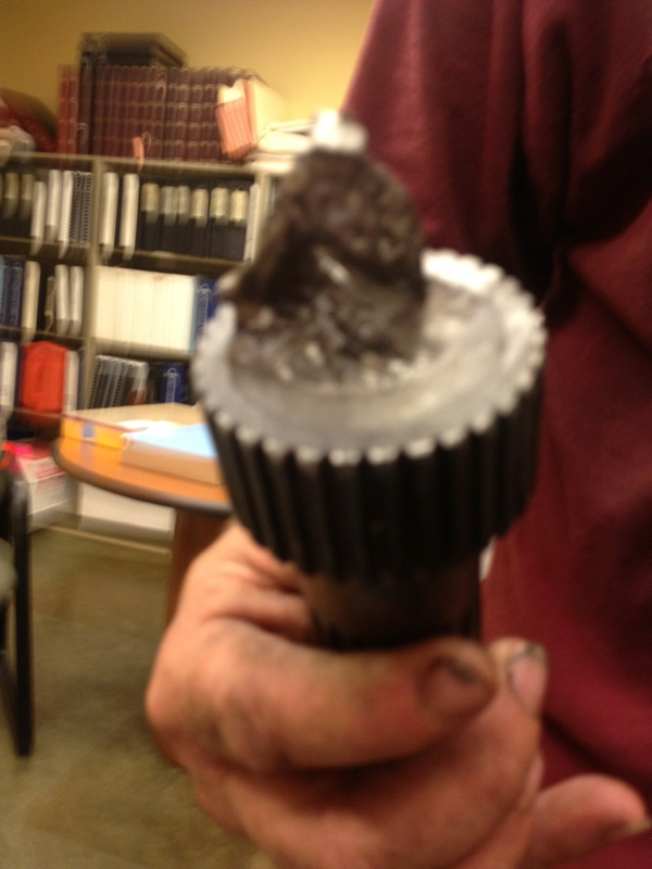

Dual pto. We got it out. It used something like a spring loaded locking collar
   / 6410 pto spline shaft broke #4
How did it break?
Zebrafive said:
How did it break?
I am not exactly sure but we suspect it was done using a bushhog with incorrect shaft length. It broke while bushhogging.
