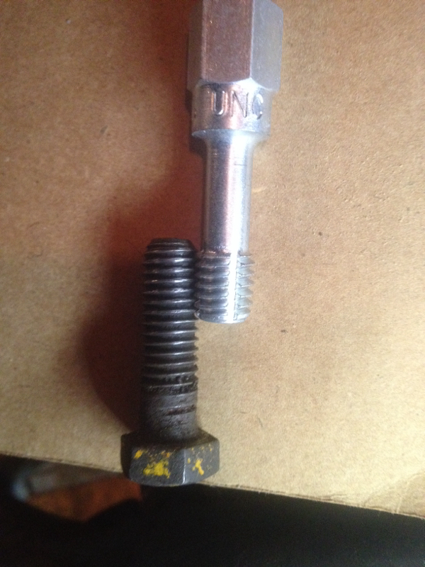

I知 finally getting around to installing my newly painted loader on my old 65 Massey.
I need to confirm the 3 proper bolts which hold the adaptor plate in place. I知 confident it痴 a three eights but I知 not sure whether its a coarse or fine thread. Unfortunately there is 50+ years of dirt and grime in those holes and it痴 making it harder for me to decide if it's course or fine.
My gut says fine but I壇 hate like **** to crank that thing in and be wrong.
Any help is greatly appreciated.

Yes, that certainly helped a little bit. I used a few healthy sprays of bolt out followed by the air compressor. The problem is both a three eights coarse and three eights fine will start in the hole but I知 not cranking it tight until I know which one belongs.

They're 3/8 course. I replaced mine last spring along with the adapter plate and some new bushings.
While you're in there, replace the fan belt! It's a real pain to replace once the front pump and adapter are installed!
Pic of the bolt shows my thread chaser against the one of the original bolts that came out. I ran my 3/8 UNC chaser over the bolt first, threaded on by hand with no play.
Thanks so much for taking the time to reply, you致e saved me time and most importantly my sanity.

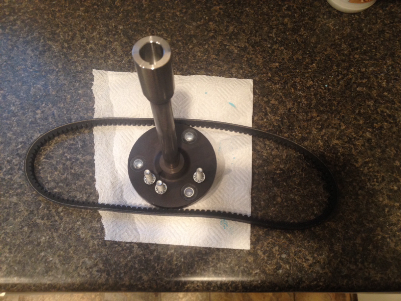

Started a 3/8 coarse and it fought me the whole time. Backed it out to have a look and the threads seem damaged.
   / 65 massey adaptor plate for front hydraulics #7
Ughhhh... Had a huge response typed out and the app crashed.
Short version, you're going to have to at least chase the threads. I had to when I mounted my pump properly, see pic below after chasing.
Couldn't get the bolts in more than a thread before I chased them.
Also, original bolts had split washers on them and are 1.45" long.

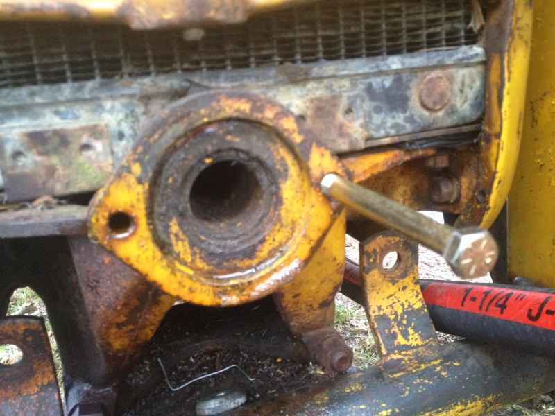

The other pic is how my pump was mounted when I got the machine. Now it's mounted directly to the cast boss on the front of the machine.

Hopefully chasing the threads will get you well on your way. Remember to use good oil, and keep backing the chaser out to clean it off. The two threaded holes I posted the pic of above took almost an hour to chase and clean out. But now a bolt will thread in to the end by hand.

Still fighting with it. I chased the threads for over an hour. At least I know the threads are fine. Problem is I believe there痴 a bit of dirt still at the far end of the holes. The 1.5 bolt with washer will not thread in far enough to clear the bottom of the housing. The bolt head keeps catching as the adaptor spins.
Plan is to run the tap again and again while cleaning the hole with air pressure. Maybe send some bolt out or equivalent in there to help break up the 55 years of accumulated grime.
