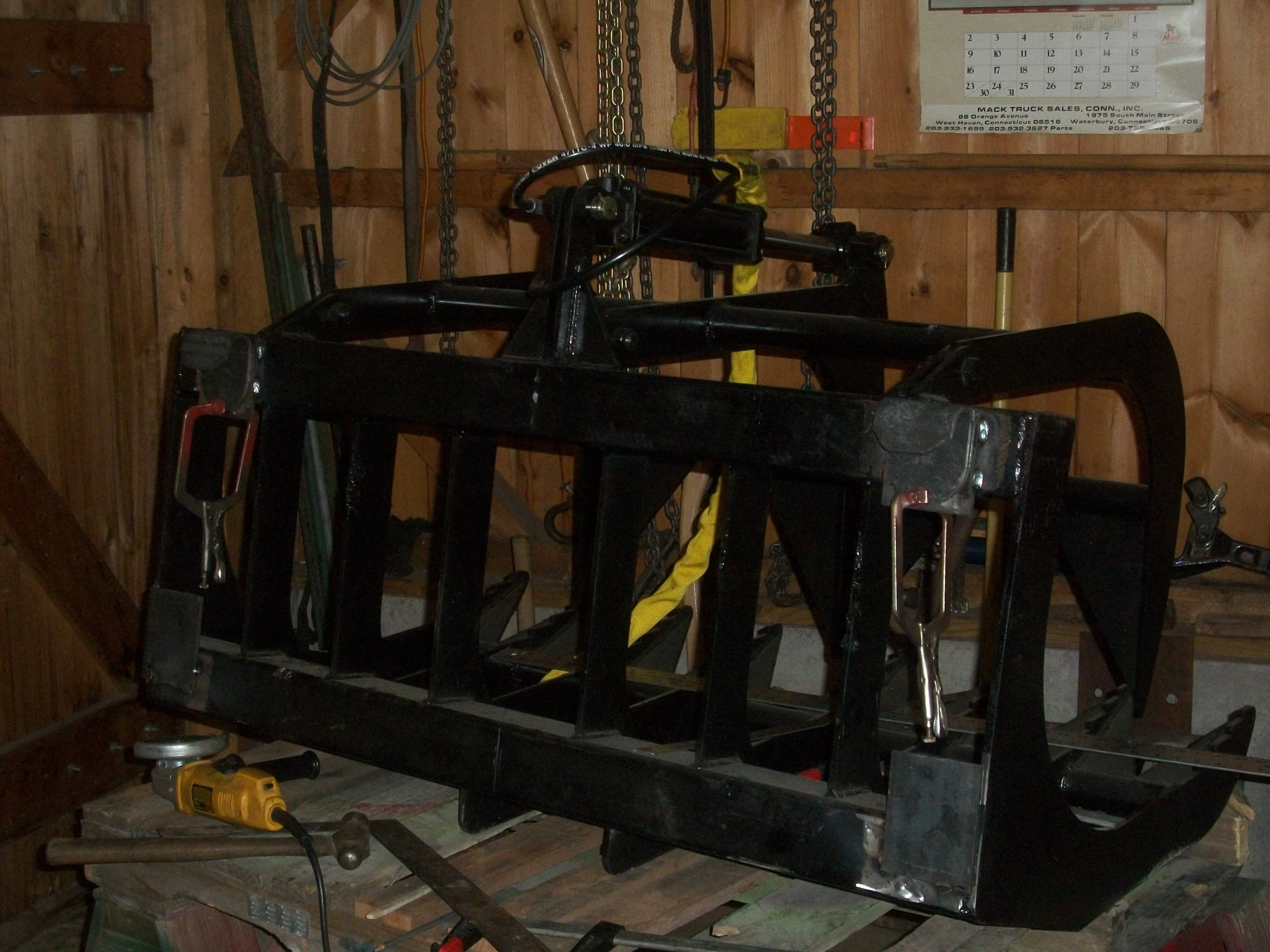

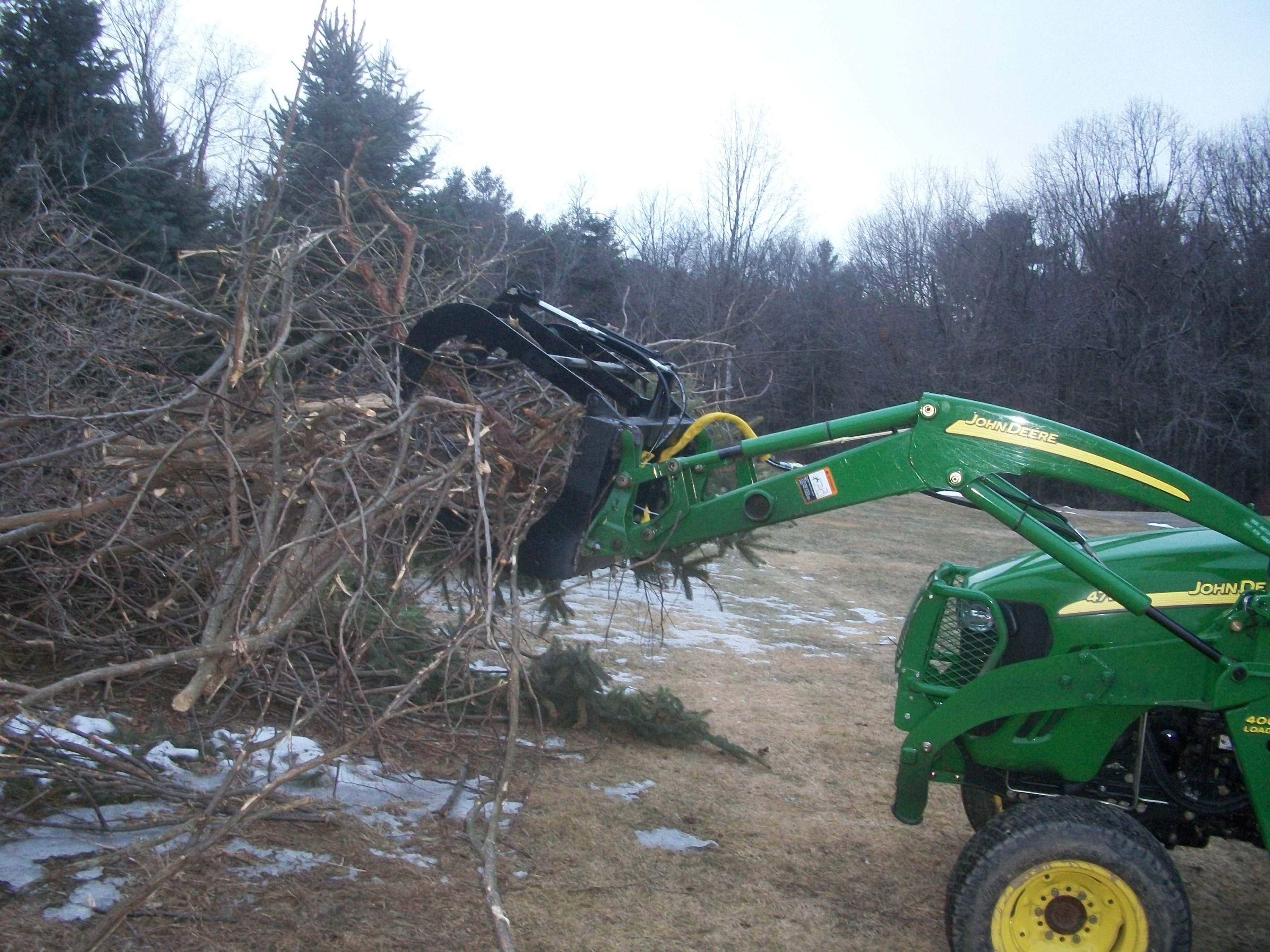

Another very satisfied Wildkat 48 owner here. And I second the point about the 48" being more versatile in terms of digging brush/small trees. More width means less concentrated power in my book. In terms of handling straight piled brush, it does the job as well. And remember, more weight you have in the grapple, less payload you have. See attached pic of mine- I ordered it without hooks and was welding the Deere "system" on in this photo. this thing is rugged.
