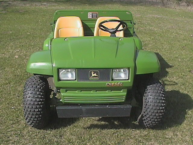

   / 6x4 diesel Gator grinds when shifting
He He He -- not for sale: after 2 days it was clear I should have bought one years ago /forums/images/graemlins/grin.gif /forums/images/graemlins/grin.gif /forums/images/graemlins/grin.gif
I spent a few months going round & round about what & where to buy.
Big concern is those ATV's go 50+ mph & my brothers kids are 4 daughters just beginning ATV riding age.
The build tag on it says 1995 but I know it was originally sold in 1997. Original owner traded over the Winter for a new HPX diesel. He had the owners manual & it took awhile to get to me. Manual did not address grinding.
The dealer had a bunch of different trades but I only drove this one because it was a diesel.
Thanks for the tips - I'll clean out the clutch, check idle & continue to zoom around /forums/images/graemlins/cool.gif
