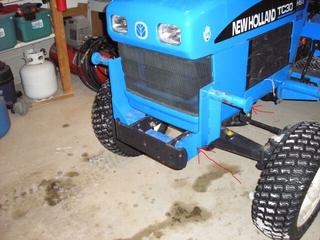

To install the blade, I needed to remove the front bracket for my 7308 loader. See pic. I plan to fabricate an alternate attachment scheme this summer so I don't have to remove this part next year.

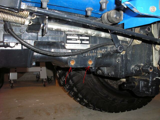

I'm not sure which tractor this blade was set up for, but it bolted right in place with no modification. I can't believe I got this lucky. The hardest part of the whole project was finding the 14mm fine thread bolts that I needed for the rear mounting points. See pic.

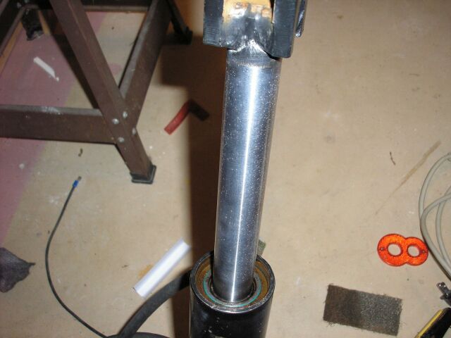

The shaft for the lift cylinder was rusted. I cleaned it with chrome polish and 000 steel wool. It cleaned up pretty well, but it is pitted. End result: it leaks a little but not enough to drip.

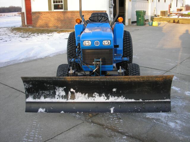

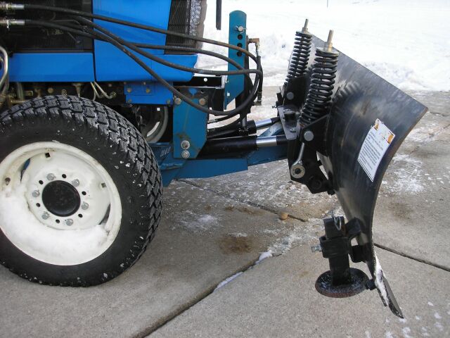

Here is the finished project. See pic

Another

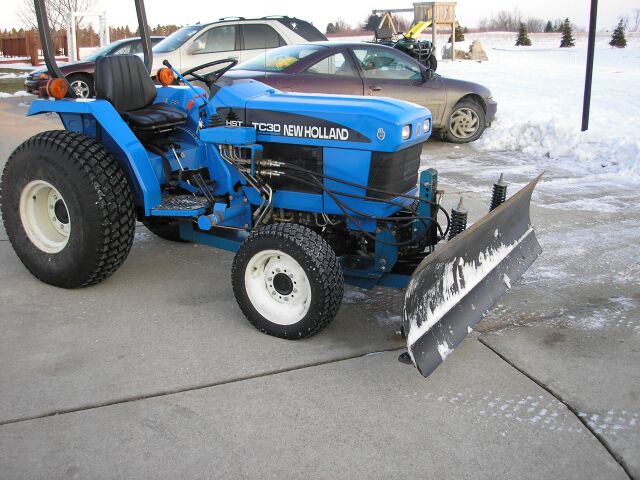

Total cost of this project was $1,000 including new hoses and bolts. (14mm fine threads were $2.50 each !)
Last pic

Question; what is the width of the blade. Also when it is fully angled what is the width. I assume fully angled it still is wider than wheel width. Also when pushing snow how is the steering. Can you steer or is the pressure off the front end. Thanks
