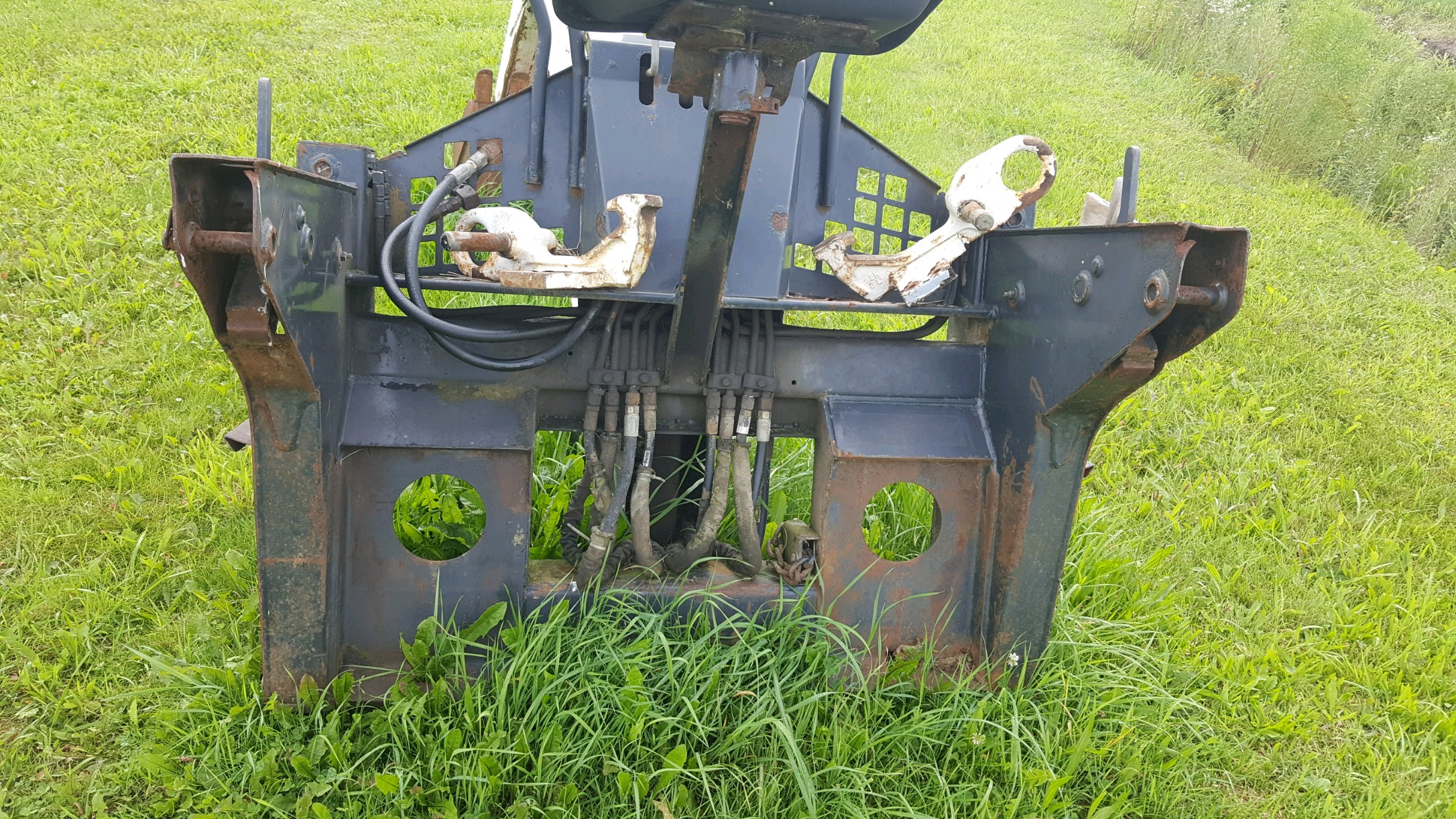

Dredging up an old dog here, but could you help me out Dennis? Going to look at a 1994 (according to serial #) 709 backhoe for my 2008 S185. Pictured are the mounts that come with it. He states that the individual numbers stamped on each piece are 6717292 and 6717202. At least that's what he makes them out to be.
Am I OK or will I be spending another $700 plus at Bobcat for correct mounts? Thanks!

773G & S185 are the same frame and lift arm so these are the mounts that will work for you.
   / 709 hook style backhoe brackets (mounts) for 773G #5
Thanks Dennis. Bought the machine and brought it home yesterday. Haven't unloaded it from the trailer yet.
