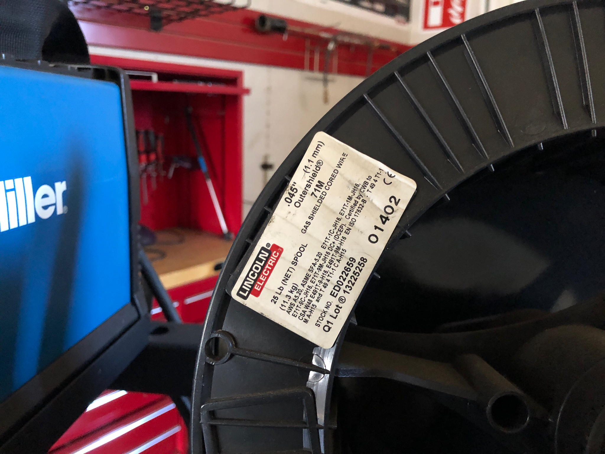

Anyone tried the 71M wire for MIG? I do mostly tractor/farm type fab and repairs. This seems like a good fit.....on paper anyway. Just wondering if anyone has used it and could compare it to anything else. Maybe it’s more
Like XXX stick or it’s not worth it for a homeowner or it’s the greatest thing to come along in the last 10 years!?!?
I’d probably try a 10# spool of the .035.

I have limited experience with 71M but I do like it. I leave a feeder permanently set up with .045. Writing down the settings once you get it dialed in is a must for me though.
The pros will be able to better comment on worm tracks etc......

I did struggle (that's just me though) with set up but it ran nice. Spray-like transfer.. Smooth. It almost made me look like I knew what I was doing.
Buy the smallest roll (prob 10#) and try it. You probably don't even have to buy a different shielding gas from what you have.

No Pro here either but the 71M like all of it's competitors is just dual shield flux cored wire that is nearly a direct replacement for 7018 stick rod. I see a lot of it formulated to run on CO2 or 75/25 and most applications are on heavy plate like dozer parts, buckets and mine equipment. Multi pass capable, comes in large sizes and works ok on mill scale. I don't like the smoke or the slag that it produces though so I never use it. High deposition rates and larger size wires are a big draw. Some big shops like shipyards and mine manufacturers are starting to migrate back to hard wire now that Pulse is gaining in popularity.

The Kobelco, Hobart, or ESAB version is much nicer to run. Slag is thin and an easy cleanup. Better values than E7018.
I am too cheap. I use .035 ER70S-6 with 75/25 for all my welding. For 3/8" and thicker, I have used 98/2 for more penetration.
