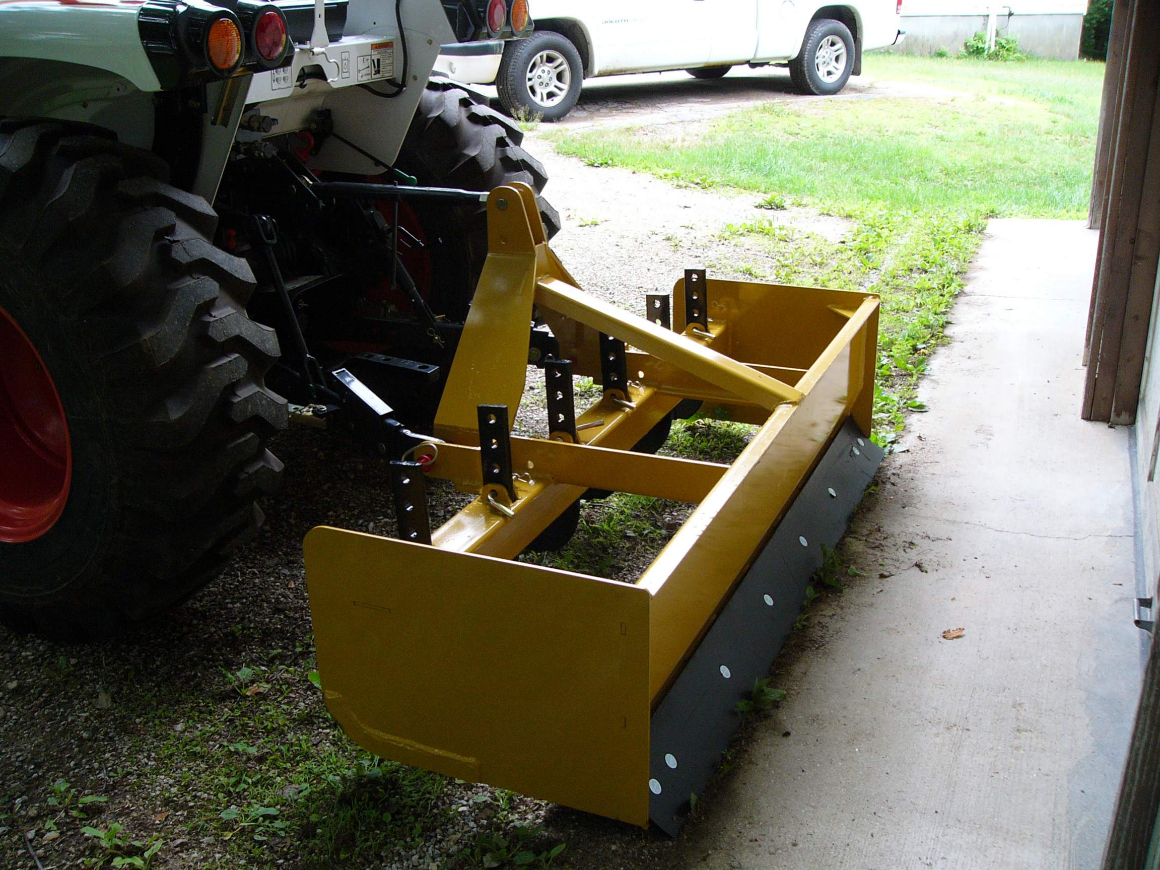

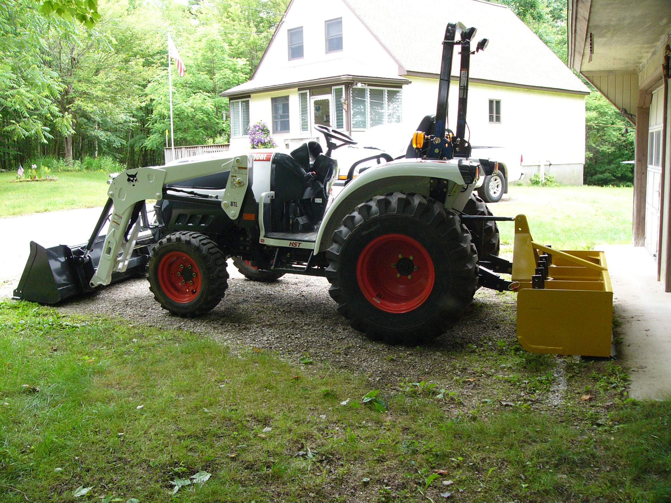

I can vouch for the quality of EveryThing Attachments box blades. A well built
attachment which is also useful as a counter weight. I have the 72" one
Box Blade for Utility Tractors with 30 to 70 HP
