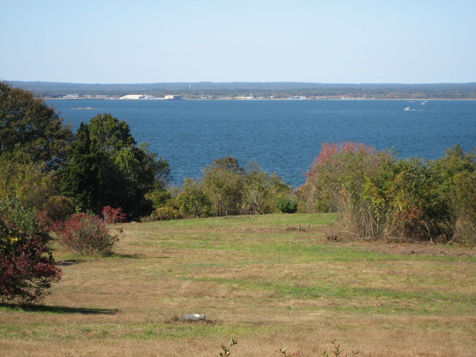

Now that I have finished bush hogging and otherwise clearing an old 3-4 acre pasture, I'd like to get a finish mower to make the mowing task go faster. I have a 21hp tractor (Kioti CK20 HST) and the land is sloped. I mention the slope because I need to be in low HST to climb directly up which is the long direction and the preferred mowing direction (up and down rather than sideways).
As I need to be in low HST range anyway, it seems reasonable to consider a 72" mower instead of a 60". The PTO horsepower is 15.5 however and Kioti's own 72" mower specifies 20 PTO hp. A Caroni 72" mower (same basic design) also specifies 20 PTO hp as the minimum. I understand these are not really precision engineering considerations but rather rule of thumb calculations that are based on cutting lush lawns.
That bring up another factor: this is a pasture not a lawn. The mixed grass is fairly thin and is cut to about 3-4 inches high every couple of weeks May-Sept. The soil is sandy and does not support a luxurious growth of grasses.
Other than mowing slowly (remember I will be in low range anyways) is there any reason not to stretch things a bit and get the 72" rear discharge finish mower? I figure the bigger mower would save me about 15-20% of my mowing time.

I guess you've been using a rotary cutter for the initial clean up. I'd also guess the cutter was a 48" unit.
If those guesses are correct, how did the unit run? Any bogging?
I operated a 60" rotary cutter behind a Deere 670 with 16.5 PTO HP. The minimum recommended HP for the cutter was 20 PTO HP. I had no problems at all. I just went slow or made partial width passes if the machine bogged.
That said...
I think the 72" RFM would work behing your Kioti as long as the grasses are dry and not allowed too much growth.
Since your property has some slope to it, I wouldn't want to cut grass that was wet anyway...wet grass is pretty slick! Making partial width passes with a 72" RFM negates the advantage of having a wider mower. Operating slower (then you could with a 60" RFM) also negates the advantage of the 72" unit.
I would be concerned about the weight of the mower (when transporting it with the mower raised on the 3PH).That could be a limiting factor. You'll want to leave the FEL on or get some front weights.
Also 72" mowers are pretty expensive. You're dealing with implements that cost $1500 plus, so take that in consideration.
Also, is the field really ready to cut with a finishing mower? It looks as if it is in the picture, but pictures can be deceiving. Only you can answer this question...
In conclusion, your machine can probably handle the 72" mower albeit it would be marginal. There may be times the mowing may be slower then it would be with a 60" mower due to making slower or partial passes.
BTW, if you were using a 60" rotary cutter (rather then the 48" cutter I guessed at) and had no problems, the 72" RFM should be no problem.

Thanks guys. I have been using a 48" Bush Hog with no trouble at all but want something wider that doesn't scalp as much.
Besides the 60" or 72" finish mower, I've considered a 59" Caroni flail mower. The 60" finish mower (using the Kioti brand numbers because they are convenient) weighs 450lbs, the 72" 495lbs and the Caroni flail weighs 485lbs. That makes all of them just a bit heavier than my current 48" Bush Hog which weighs 430lbs. By comparison, the Bush Hog 60" rear finish mower weighs in at a beefy 536lbs and their 72" version is 588lbs.
For what it's worth, my backhoe with bucket weighs more than 800lbs and Kioti recommends 600lb ballast for the FEL anyway. Also, as the finish mower has four wheels, it is really more of a towed weight than a 3PT hung weight that I'll be dragging around while cutting anyway.
I'll need to ponder the real world benefits of pushing the envelope here as any theoretical efficiency gains would, as Roy points out, evaporate if I end up needing to go over areas a second time or slow down. I don't think I'll need to slow down much as I would be in low range anyway so not moving that quickly.
I've wondered about what the fair comparison is between mowers of different widths as real world conditions don't really get taken into account when one just compares the width ratios in calculating expected cut times. One thing that may increase the benefit of wider mowers is that you need to overlap the cut area just a bit to ensure you don't leave uncut grass at the margin. If you overlap by six inches, then the effective cutting width of 4, 5 and 6 foot mowers is really 3.5, 4.5 and 5.5. The proportional benefit of the bigger mowers is therefore a little greater than it appears. However, I would guess that the increased manuverability of the smaller mower would sometimes be useful and save time. Also, we tend to compare mowing times without considering the time involved in setting up or putting the tractor and implement away which presumably is identical for all mowers.
Decisions, decisions.
