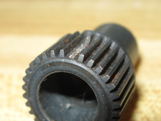

You described the condition exactly on my 7274 but mine had 1000 hrs on it
I had to get mine rebuilt to the tune of $1300 but was told that they "beefed" up the teeth and springs etc

If anyone is bold enough (or, like me, cheap enough) to take apart that small $1300 handful, I recommend trying it. The Denso pump has that steel rack gear turning what looks like anodized alloy, lost wax cast, pinions that are no match for the steel rack gear in a tooth to tooth battle. Seven bucks for the pinions makes the choice of how to go about this repair clear for me, at least.
Still, I have thought about ways to take that muscle-bound solenoid return spring out of the game. In yesteryear, diesel fuel shutoffs were a knob on the dash that manually pushed against the governor. I have thought about doing something like that. While my old 7274 sits dead (cracked K3M engine block), and its fuel injection pump (the one I rebuilt) is available for my 7300, should it be needed, I still don't want to go through the ordeal again. I may someday build a manual fuel shutoff and toss that solenoid aside.
   / 7275 injection pump question #24
I was just looking out the window and there was my old busted pump pinion sitting there on the sill. I thought, I should get a macro snapshot for this thread.
11/16" diameter.

Short Game: I have the exact same problem. Took apart my pump to find that one of the pinion teeth was broken loose and jammed into the rack, preventing it from moving to open up. However, once I took it all apart, I'm unsure as to how the orient the pinion during reassembly, as this will obviously affect how the fuel shut off function works. Any suggestions on how to orient the pinion? Thanks !!

SD> there is a dot on the gear & a line on the rack..
As far as the pumping plunger goes> the "cut" {helix} on the end, goes AWAY FROM the control rack.. good luck.
