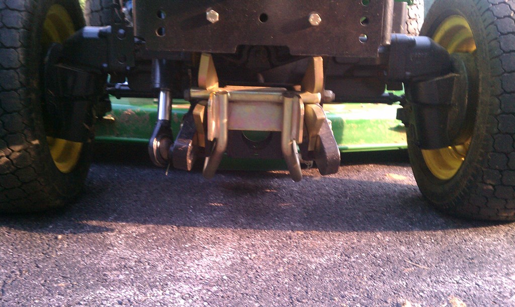

The mowing height on my 72D Auto Connect MMM is very low (~2") and it seems that it cannot get any higher. anyone else have this issue and resolved it?

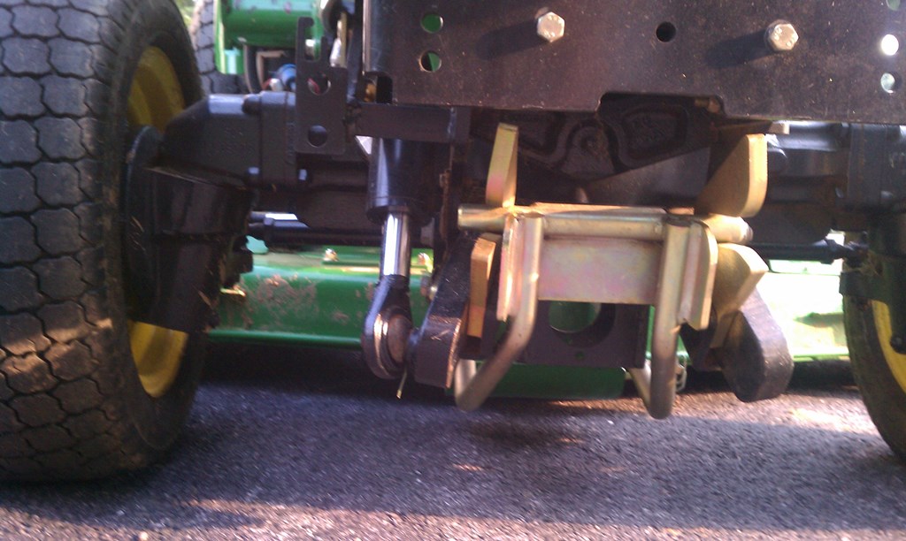

yes I had this issue. even sent it back with no luck. decided to thumb through the deck manual and figure it out on my own since the dealer techs don't have a clue. I found that it was way out of adjustment. There is specs on how far the lift arms are to come into contact with the fuel tank guard if you have a cab, I found I had a couple inches to raise and adjusted the lift arms. Tomorrow im gonna remove the loader and install the deck so ill get some pics and specs for you. very simple adjustment. I think my deck raises about 4 inches off the ground with turf tires. Actually im 99 percent sure because I took measurements for someone else

NURU, If I had to guess either your R3 specials are a little shorter that our regular R3, or something isn't adjusted right. Like I mentioned in the another thread, the lift arms should be no more than 1-2mm off the guards..

Those pics will sure help. I will also take a pic of mine at full transport height.

My Turf Specials are 41" high and the non-autoconnect decks work fine and I get plenty of clearance. But with this deck, it only raises up to about 2" of cutting height and I have to force my shoe beneath the deck (while it is off ). Definitely not right.

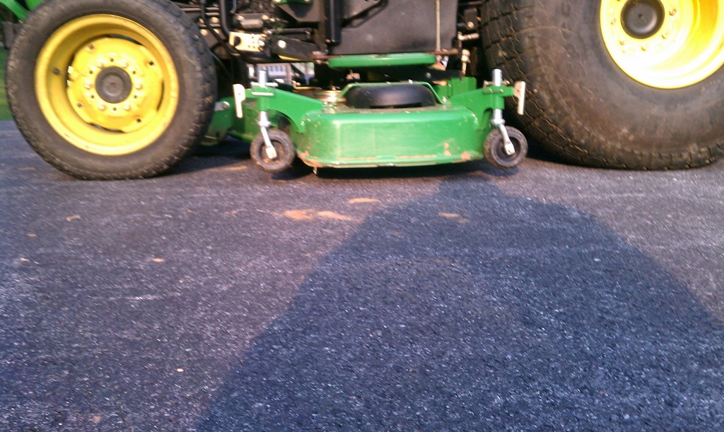

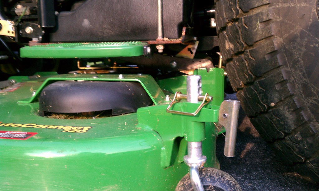

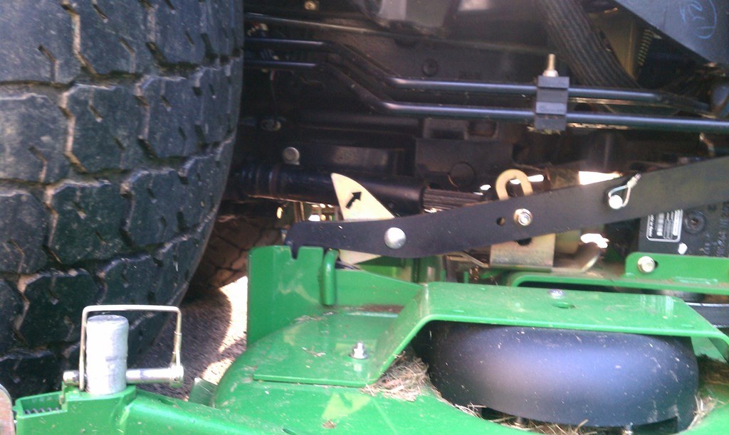

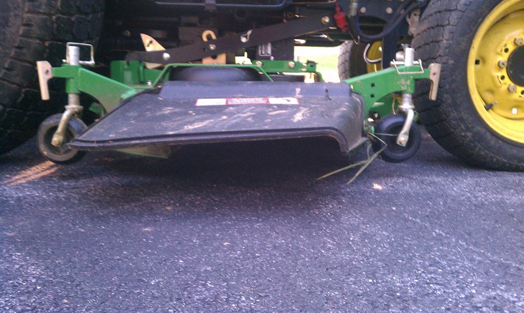

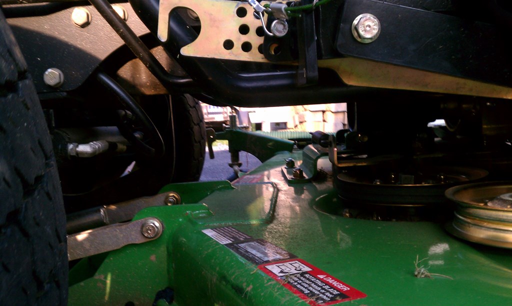

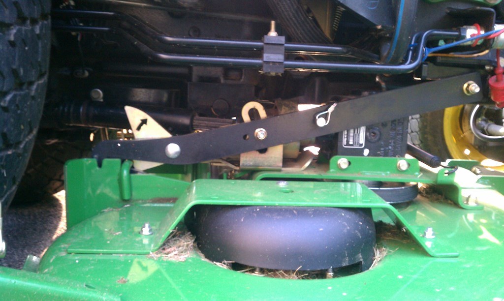

Here are some pics at the current full transport height.

Just to clarify - when you say 2" are you measuring blade to ground or edge of deck to ground?
Honestly I dont think anyone at any JD dealerships knows how to set up the 62D/C or 72D decks.. I have R4 tires and I am CUTTING at about 4 to 4.5" in the highest position control setting (adjustment knob on the 2320) - transport height is several inches higher

Blade height, the edge of the deck is lower, as in 1"? I am beginning to think based on the comments in the forum that you may be right.
   / 72D Auto Connect MMM Height? #10
Ok, so it seems I have almost 5 inches of height. Mine is adjusted so well that the auto connect feature works 99 percent of the time. The second picture shows how I can just barely fit my finger between the lift arm and fuel tank skid plate. The last picture shows where to adjust the lift arms. adjust both sides at same time. It will require you to remove and attach the deck several times till you get it right. You may have to adjust the drag on the front attaching hardware as well. If you get stuck doing this, I will have to scan my mower deck manual for you and send it to you. I can already see by your pictures where the lift arm meets the fuel tank skid plate that the delaer really screwed up the install. Freakin typical of those idiots. You have a ton of adjustment left
