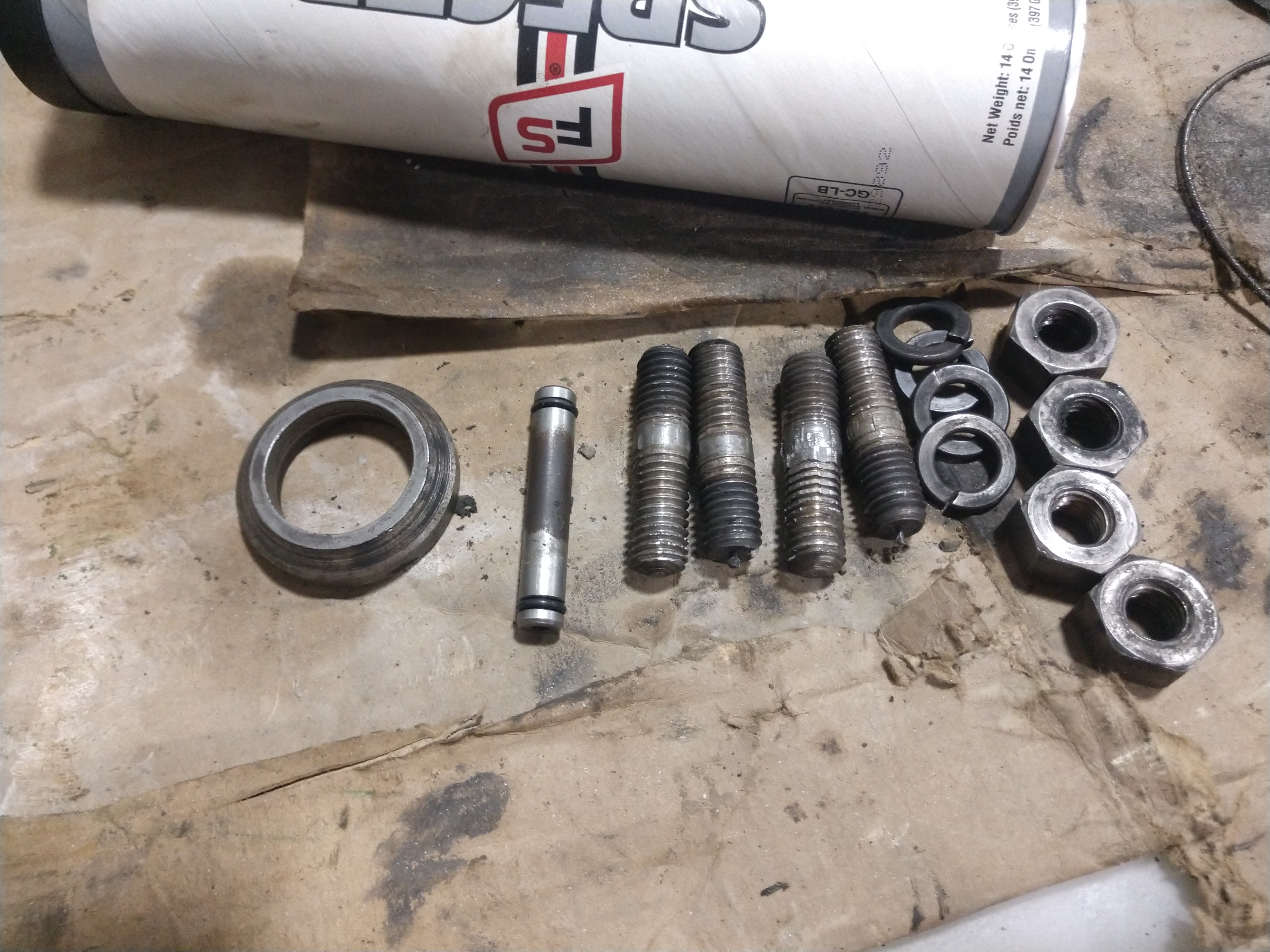

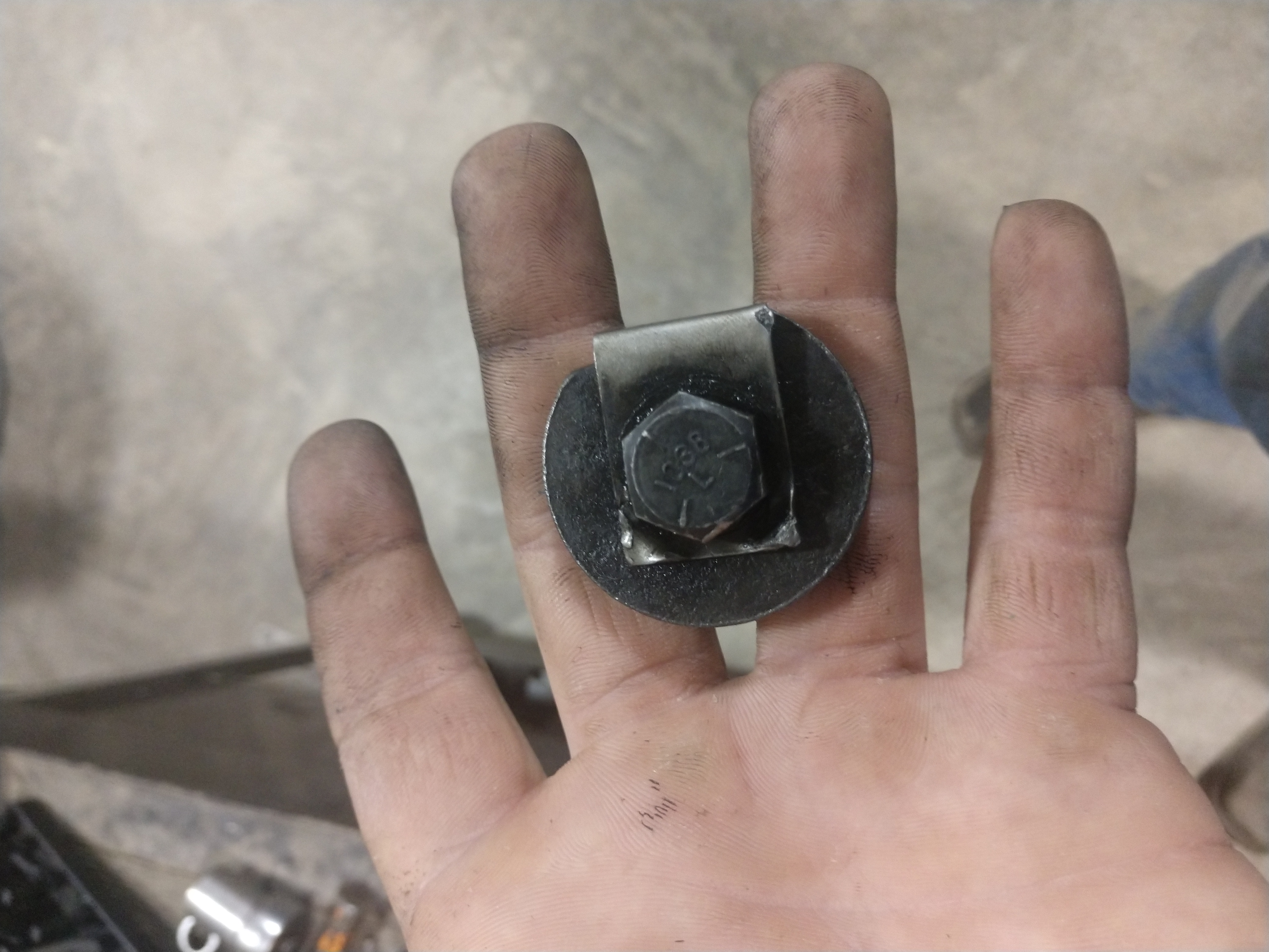

From right to left I'd say wheel nuts, d##n lockwashers, buggered up wheel studs, dunno, and that tapered cone I've seen somewhere before but can't remember.......Mike
   / 730 extra bolt #12
Wheel nuts would be painted yellow,buggered studs aren't wheel studs but maybe engine block studs & nuts/LW for studs What dia & length are the studs???? . I wonder if tapered cone is crankshaft spacer(key 11)?

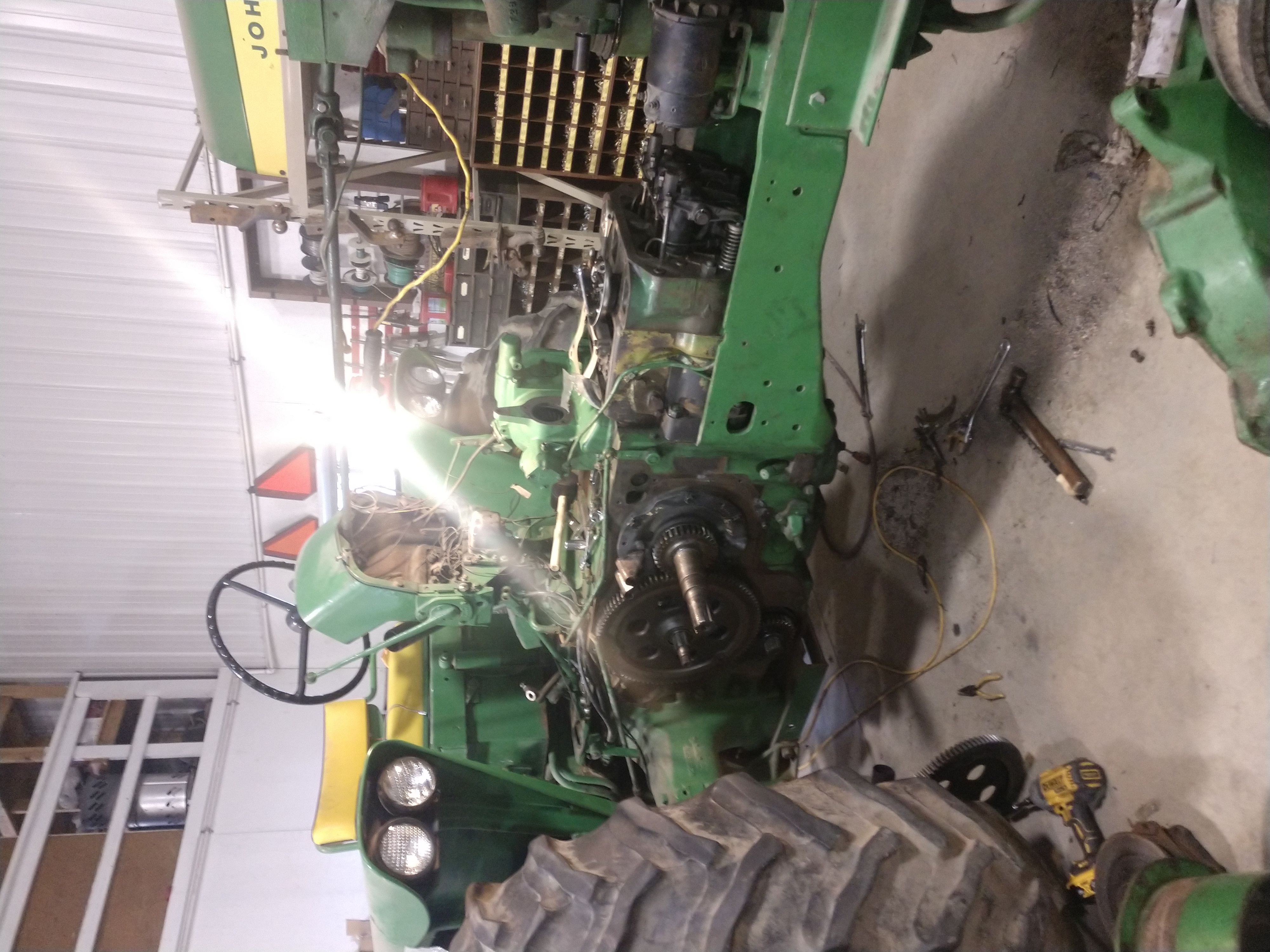

I have looked on the JD parts site but I will look again today. I found out the studs go in the top of the cylinder head for the intake and coolant pipe. the machine shop removed them I guess they just used vice grips, I shoulda took them out myself. I put some pictures in of measurements of the spacer and this small pipe.
