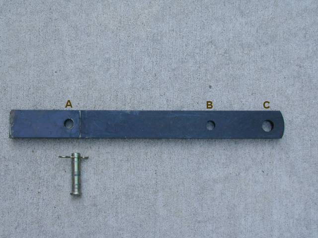

My used 7305 came without a draw bar (the one below the transmission). This should be common to a 7260, 7265, 7300 also. I just picked up some 3/4" x 2" bar stock to make one from. It would be a great help if someone could measure one for me. I need the overall length and hole spacing.

Here's what my Mahindra 3015 came with - same tractor, as you know. I only wish I had a metric tape measure... /forums/images/graemlins/blush.gif
Overall length: 19-3/16"
Overall width: 1-15/16"
Overall height: 3/4"
For these measurements, refer to the attachment:
From "tractor end" to center of hole "A": 4-1/16"
From center of hole "A" to center of hole "B": 9-15/16"
From center of hole "A" to center of hole "C": 14"
Diameter of holes "A" and "B": 15/16"
Diameter of hole "C": 1-1/16"
Of course, none of these are going to be real critical. On my tractor, I can't use "B" as intended in the manual (as a way to slide the drawbar back under the tractor while using the three-point hitch) for the simple reason that the housing for the mid-pto will only let me slide it in another inch or two!
Hope this helps you some,
Jerry

Thanks, that should do it.
I am a little surprised that the "A" and "B" hole is 15/16 since the one on the tractor is 11/16. I had eye balled it at 3/4" but the cat 1 toplink pin I bought for it is too big so I'll pick up a cat 0 one.
I have pretty much decided to weld a piece of 2" receiver tubing and a grab hook on the one I'm making. That's an advantage of making one. I'm much more comfortable hacking up $0.35/lb remnant steel than $165 factory parts...
