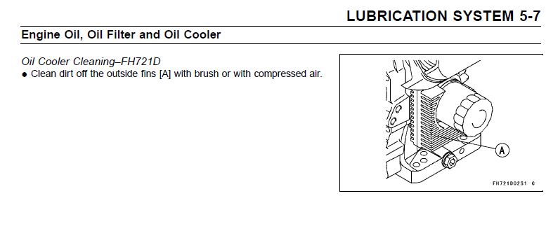

On most engines, you want your compression readings within 10% of each other.

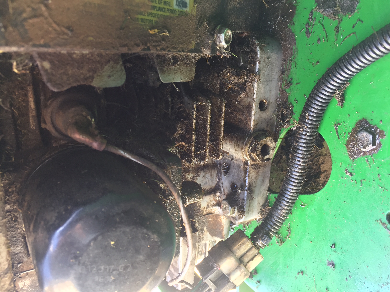

The last pic would explain a lot about overheating to me.
Clean everything and hope the cooler helps.
Kyle,
I agree, all that old oil and filth will definitely restrict cooling.

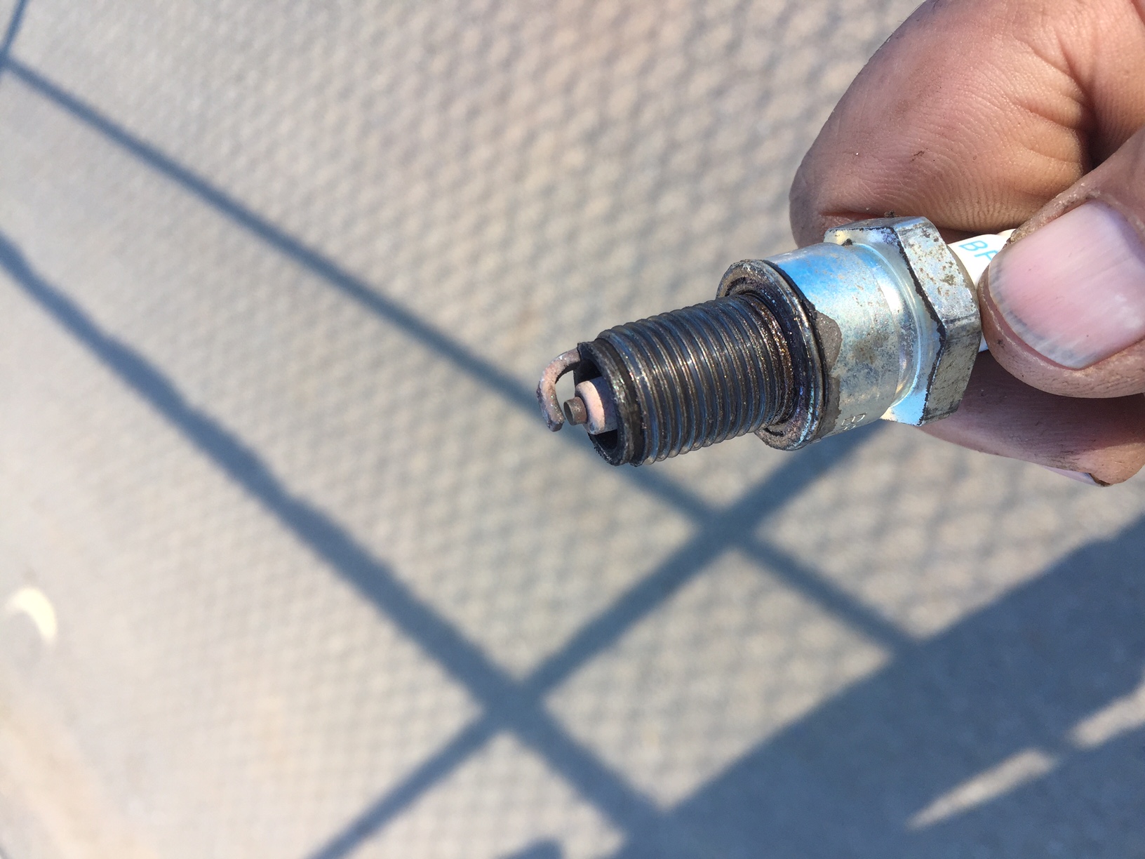

Larry - does this engine burn oil? While the tip of the plug looks like it is running a little lean, (no brown on the porcelain), the plug base looks oil coated.
Do you know what jets are in the carb? The shop manual has the recommended jets for altitude.
Richard
Richard, Since I replaced the crankseal, the oil loss is minimal, but there is "some" for sure. No smoke, running synthetic. I do not know how the carb is jetted. I will see if I can access the main jets easily and pin guage them to see if for some reason they are high altitude jets. We are at sea level, but not sure where this machine was purchased originally.

Re: 737 Kawa680 valve guide and pushrods. - oil cooler
I added the oil cooler, took about five minutes more than an oil change. I forgot to open the drain on the drip pan, so pardon the oil spill. Torque per spec for the pipe joint fitting is 33 ft. lbs. Anyone have any ideas for oil temp. gauge or CHT gauge? Seems like cylinder head temps might be useful, wanting to have an idea when/if we should shut it down.
