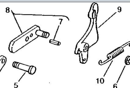

I started it up today. As soon as the tractor starts, the 3pt lift starts going up. It goes all the way up and stays there. I move the lever to the down position, but the arms won't lower. When I shut off the tractor, the arms bleed slowly down. I stand on them and they lower a little faster. As soon as I start the tractor, they go up again. I suppose I didn't put something together correctly in the rockshaft housing. I will dismantle it again tomorrow, but I can't think of what it might be.
   / 74 John Deere 830 Hydraulic lift won't go up #8
Did you get roller in control linkage in frt of follower(key 9)? Did you try changing positions of L/D control lever under seat?

#9
I tried the L/D lever. No affect.
When lowering the cover into place, I put the follower, #9, against the the lever, #4. I put it between the 2 sides of the lever. I hope that makes sense.
I won't be working on it this morning. I have a med appt, so I will tackle it later. Thanks for your input on this.
   / 74 John Deere 830 Hydraulic lift won't go up #10
Yes what you stated sounds correct. Is spring intact & connected correctly?
