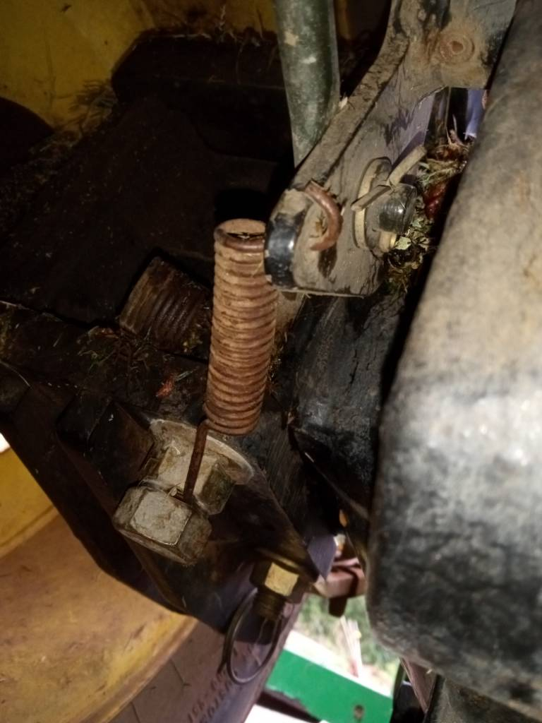

I was having the same problem with my JD4210H, my solution was to install an old drum brake shoe tensioning spring outboard on each side. They pull the park brake linkage back, ready for next application and don't interfere with normal brake operation. One end in the hole on the linkage, the other end wrapped around the axle housing retaining Ubolt with a securing nut. Works like a charm, hasn't failed since installed.
