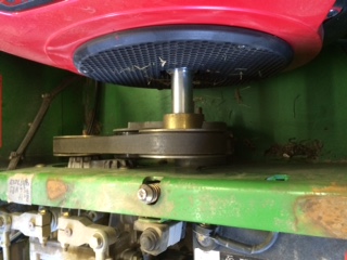

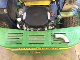

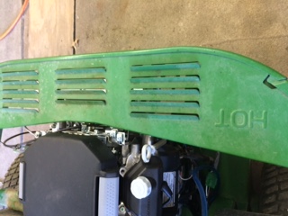

General View
Mounting plate
Motor and belt - i didn't get it straight - runs fine but I will fix it - may kill belt

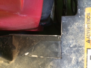

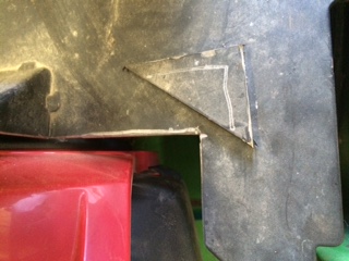

Metal removed from seat bracket

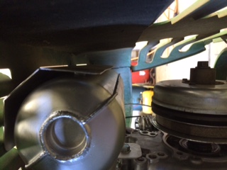

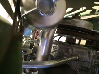

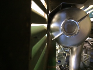

Muffler under rear cover - lots to be removed

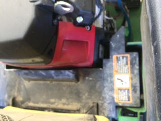

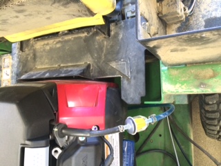

Tight fit
