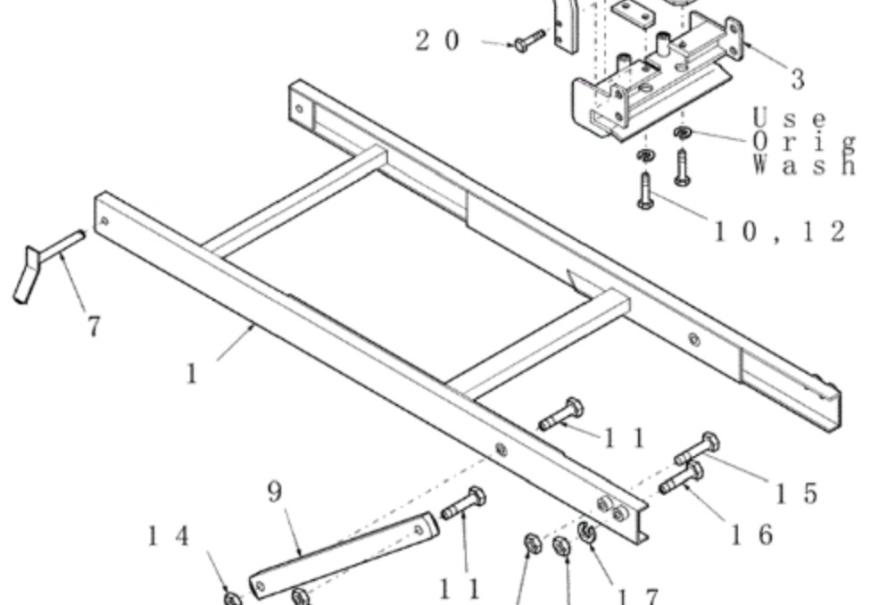

Gentlemen,
I have searched the forum, with no definitive results.
I have an opportunity to buy a very nice 757c backhoe that has a ford 1720 subframe. It looks close to what I'll need for my TC33D, but the part numbers are not the same. I can't do a very close comparison as the backhoe and tractor are 2 hours apart and not getting closer before purchase.
So, the cost of the subframe would be prohibitive, but if the modification is simple, I would move ahead with the purchase.
Hoping one of you have crossed this bridge and can guide me.
Dan B

I have the 757C for my TC33D and probably only live about 25-30 miles from you if you would like take a look at its setup. If you can weld or know someone who can it might not be that much to modify, but that's a big guess on my part.
Apologies for the delay in responding - been traveling a bit.
I wonder if I could ask you to take a few measurements for me? I will attempt to paste a picture below. What I want to know is:
Length of the subframe (end to end of the beams)
Width of the subframe
Distance from the backhoe side of the subframe to the holes at the front end, that mount midpoint on the tractor
My thinking is if the width is the same and the length is the same, what will be different is the distance to the front holes (since the back holes mount to the backhoe, I assume those are the same regardless of what tractor - they will be sized for the 757C backhoe)
If you can take those measurements, I'll get the same from the 1720 frame, and see if this is doable.
Many thanks in advance. If you can't do it, might I be able to take a trip down there myself?
   / 757C backhoe subframe from 1720 to a TC33D #7
L =70 1\2" end to end W 22" out to out 43 1\2" from backside of cradle rest to Center line of pin hole .:drink:

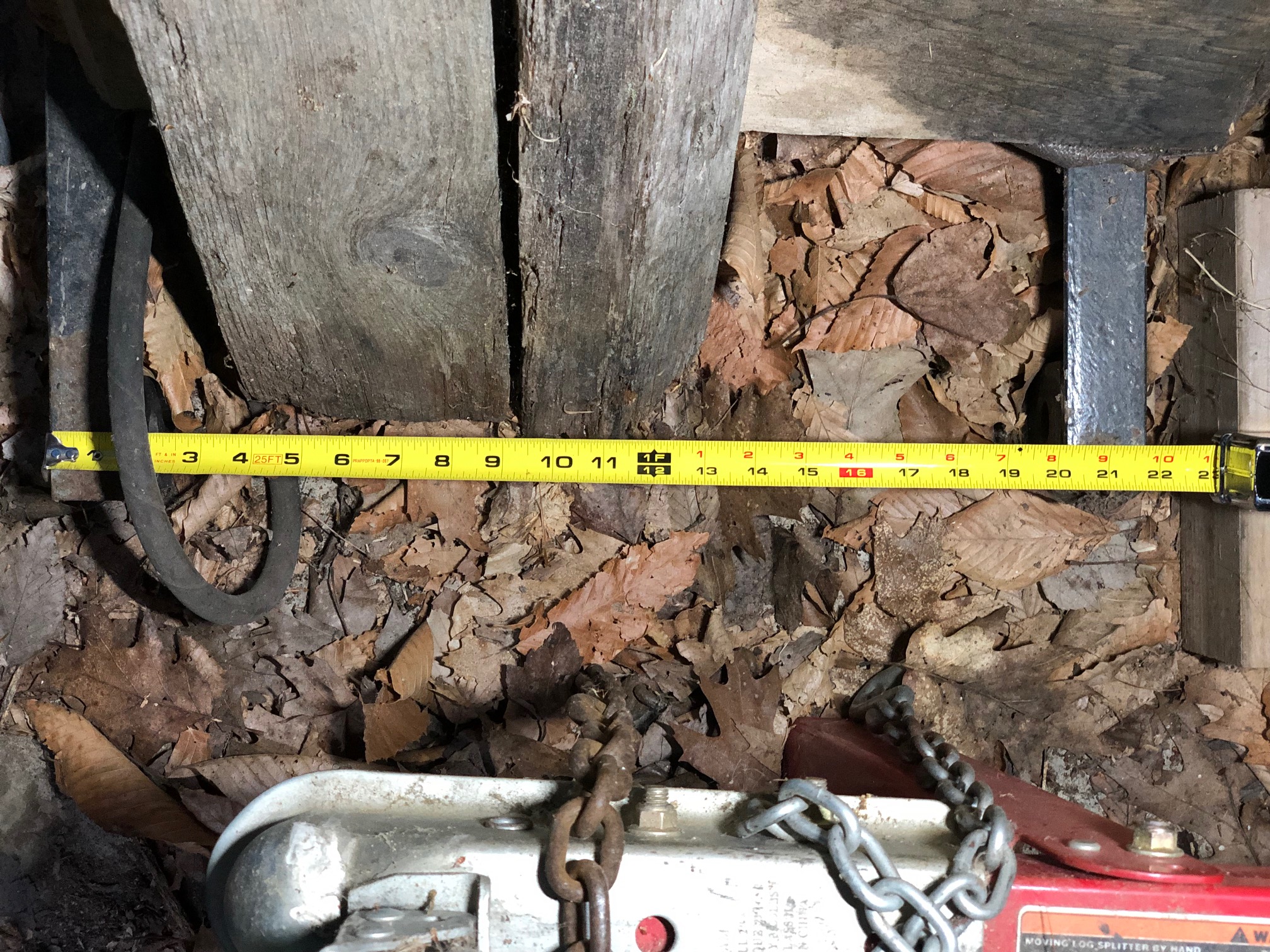

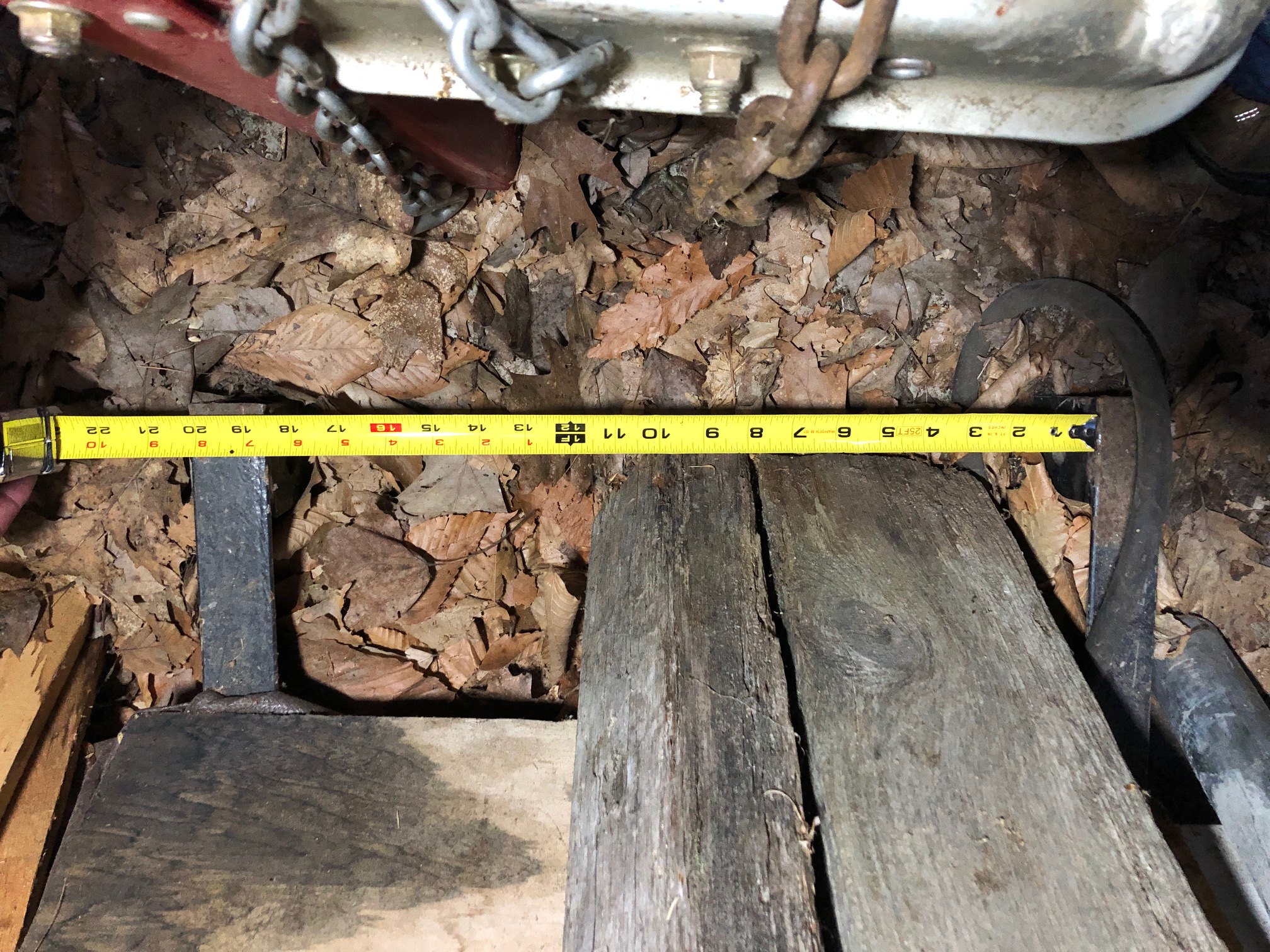

My 757C hasn't been used for a few years so it has some clutter around and on it. I did however take a few pictures (see attached) of the width of the frame where the pins attach near the loader supports for you. The internal width is 18.5" and the overall width is 21.75" This should help confirm the dimensions Spitter gave you. Let me know if you need anything else.
