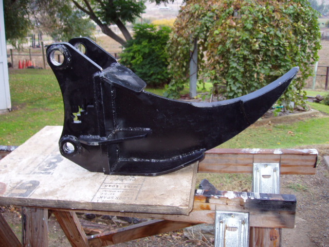

Want to get any opinions before I jump into my next tractor project...
Here it is, want a smaller bucket for pulling stumps. Since my machine is only a 30hp I want no backing to it to get a little better rip force and leave as much dirt behind as possible.
So, I'm thinking a 8" "frame" with no back. Has anyone tried this and are there any negatives to it. I can't think of any myself except for needing to change out the bucket and most likely needing to build it myself :). Haven't seen one like this in the aftermarket.

Hadn't thought that far ahead but yes, that is the idea. :) Easier to make with the single tooth instead of the double. Thanks for the heads up on this thread.:thumbsup:
Most of the stumps I want out are smaller with a few large ones. My current 16" bucket just can't handle it very well. That and the need to create a bunch of holes around the stump to get it out. The ones that I can, I push over then pull out of the ground. Can't do that on enough of them though.

As TO Bud has posted, I too bought a ripper tooth from Michigan Iron and Equipment, they are a TBN sponsor-look at the Kioti section for their add. I have a NH TC40 coupled to a Woods BH90-X and since they had not yet built one for my model Woods BH, I supplied a few simple measurements and a couple of photos and it was over with. The tooth cuts through oak roots like a hot knife through butter without a lot of dirt displacement.
