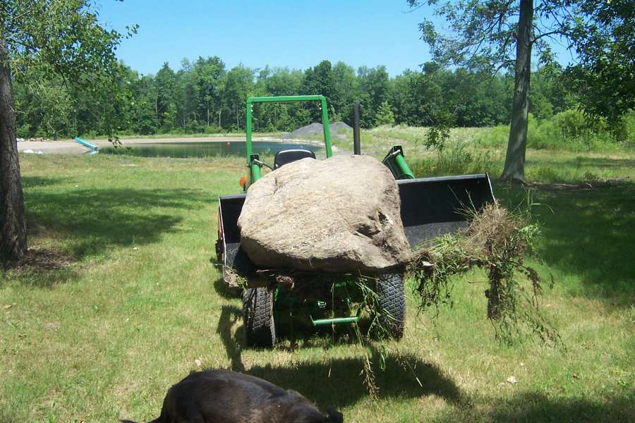

Thanks for the clear instructions. I installed three shims based on your directions tonight.
I went out to my field and believe I was picking up 1000 lb. stones without the normal need to dramatically increase engine RPM.
My question to you and others performing this enhancement is:
How many shims are you using and what effects are you noticing? The part when ordered from Deere comes with several shims.
I will try to post some digital photos tomorrow showing any improvements in front end loader lift capacity.
Buck

Here is a photo of a granite stone that I lifted without problem.
   / 790 Lift Capacity / Shims to increase hydraulics #10
Watch out Puppy!!
