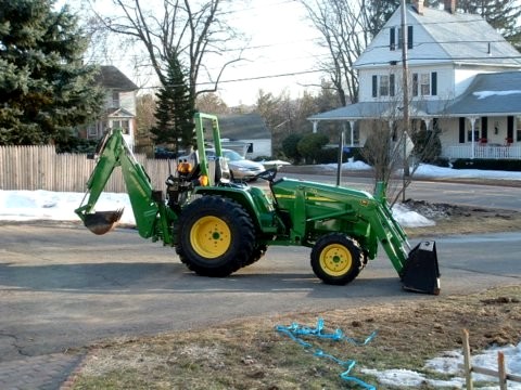

I agree with Terry. I do a lot of lot clearing with my 790 and I to have hit the grill and lights but I was able to strighten them out. I have bent the drag link many times I also strighten it out useing a ratchet strap works great. the only way is to keep your bucket close to the ground and use it as a bumper.
   / 790 Tie Rod
Richard,
How do you like your #7 Hoe for your 790? Does it work well? How long does it take to hook up and remove?
On my property, we have had 4 dozers, 4 track hoes and 4 back hoes out here clearing some of the wooded land. Being that it had been a very wet winter here, there is quite a bit of deep MUD on the logging roads they have created in the woods. Being that all of the equipment operators are students from a heavy equipment training school, they sometimes "forget" to pull out all of the stumps, or a stump hole was covered with loose mud, but not walked in or compacted. When I drive down the logging road, because of the "roughness" of the road and cleared areas, I need to keep my bucket up a little. Otherwise, it would be constantly hitting the ground. On smoother gound, I always run the bucket about 6" to 8" off the ground. This is the reason I keep bending the tie rod. I thought maybe there might be a way to place a guard in front of it. I would rather smack a guard with a stump or trunk than with the tie rod.
   / 790 Tie Rod #5
I've bent my tie rod twice. Here is how to fix it: Hook a chain onto the bent place (probably in the middle) and hook the other end onto a tree. Put it in low range and back up. It will straighten out perfectly. That tie rod is kind of a bad design on JD's part.
