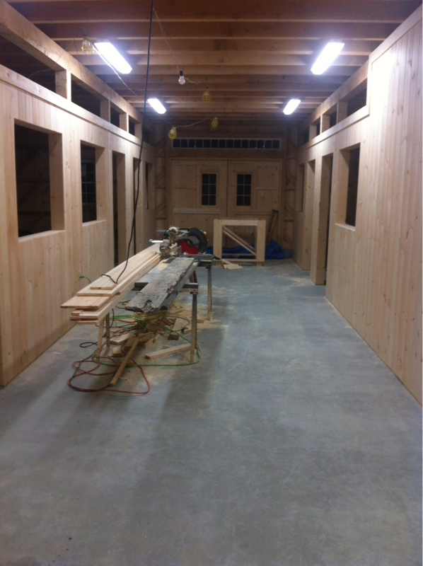

Wife decided on 6, 4 foot led's for the 48 foot isle in our barn. We got them from Orion west lighting and she is very happy with them. They were pricey, but hopefully we will saying electric bills for years to come. Here is a pick, still a work in progress.
Good luck in your search
Dave

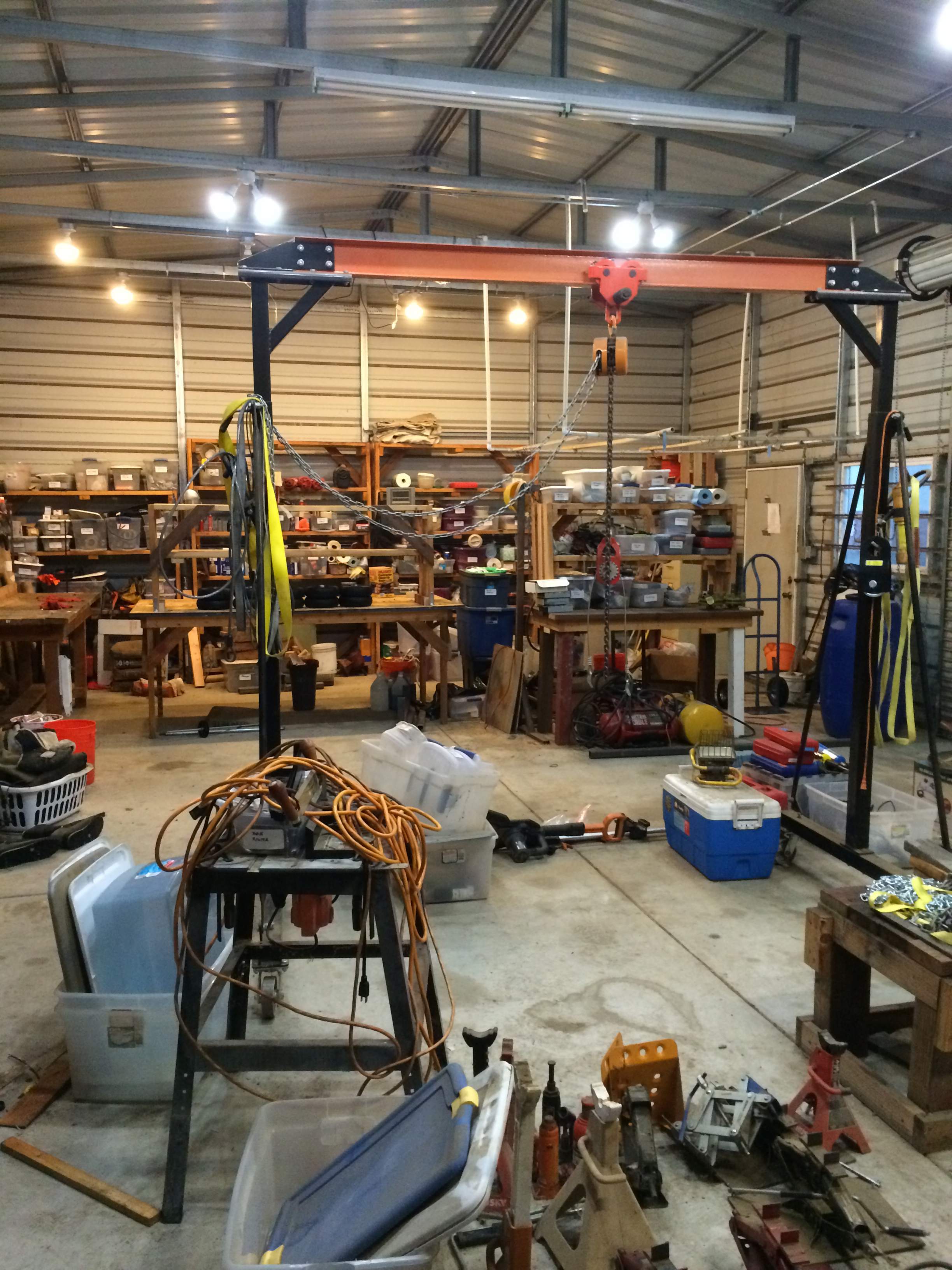

My 24x42 ft shop (12 ft walls) was built 10 years ago. I used 4-ft dual fluorescent fixtures (Lithonia from Home Depot) initially. Got tired of replacing the ballasts every few years so I went to the screw-in compact fluorescent flood lights (outdoor type) as each of the tubular units crapped out. A lot easier to change those screw in bulbs with the built in ballasts.
Good luck
